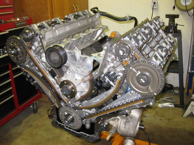

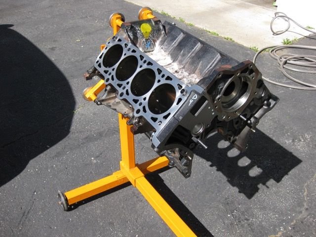

Yup MaxJax lol. I won't be doing it this weekend. I need to get this white car out first.
Motor had a ticking sound of sorts. So had to pull this out and tear it down.
Fun stuff
I have to build the short block this weekend and hopefully next week the heads come back from the machine shop. Should have it all back in and done by next weekend as long as all parts come in on schedule.
Once that's done and out I'll pull the 911 in for the clutch.
