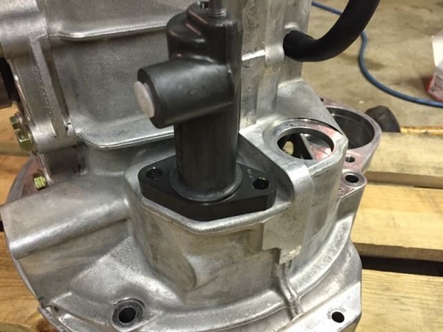

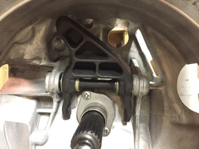

Originally Posted by MalcolmV8
Mocked up my GT2 slave
After mocking up the new GT2 clutch fork (mirror image of the stock one) I saw it was catching on the bell housing area there a little. I took an air die grinder and cleared out a little material to fix that.
I haven't done this mod but plan to. Question, isn't the location of the slave critical to how it mates to the clutch fork on the inside (your second picture above)? How do you best align it from the outside if this is indeed the case or is there some allowable slop for slightly "mis-positioned" slave from the outside?
Great write up and pictures....thank you for taking the time to share!
the rod in the slave has movement in it. the ball seat of the fork is larger than the rod. if you line up the slave on the outside edge of the trans your golden
Well the slave has the shape of the bell housing edge which shows you how to line it up. The clutch fork used is a mirror image of the original so you can use the original hole in the bell housing as a reference. I then used a straight edge to line up and make a mirror image hole if you will on the other side in spec of the original hole and also using the slave body as a guide too.
You do get some wiggle room but using that method it was spot on.

all thats needed is to line the slave up on the edge of the mount. mark the holes and drill. center the holes and mark the middle drill. done

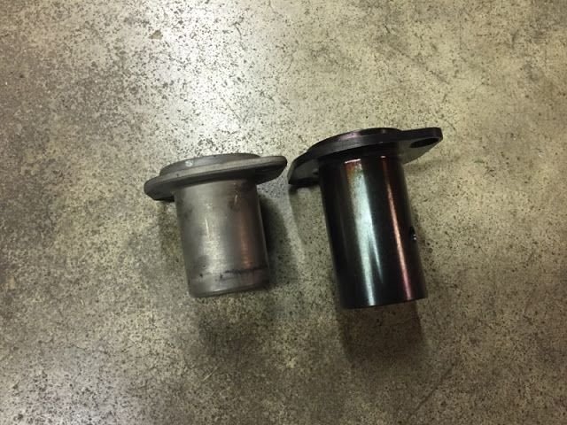

Originally Posted by 32krazy!
malcom the trans mount won't make the clutch chatter nor will it make the oil darker due to metal on metal wear. you have a different issue. the 74 durometer rating is similar to a semi solid. I'm betting close to a gt3 style mount. its not your problem is the clutch tube sleeve the proper length?
Yes I got the longer version. Stock on the left and the longer one on the right is the new one I installed.
i guess my question would be are you sure a longer version is required? on my carbonetics clutch a longer tube is used. when i installed the erp clutch it goes back to the stock version. I'm pretty sure it has to do with the throwout bearing and how short or long the ears are on it

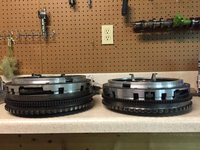

Correct. So when using the GT3 RS flywheel it's much smaller which pulls the whole clutch assembly closer to the motor including the throw out bearing. So you need a longer guide tube to reach further down to where the bearing is now. The GT3 throw out bearing then has longer ears to keep the clutch fork in the stock location. You can sort of see it in this pic.
