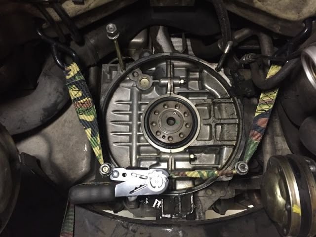

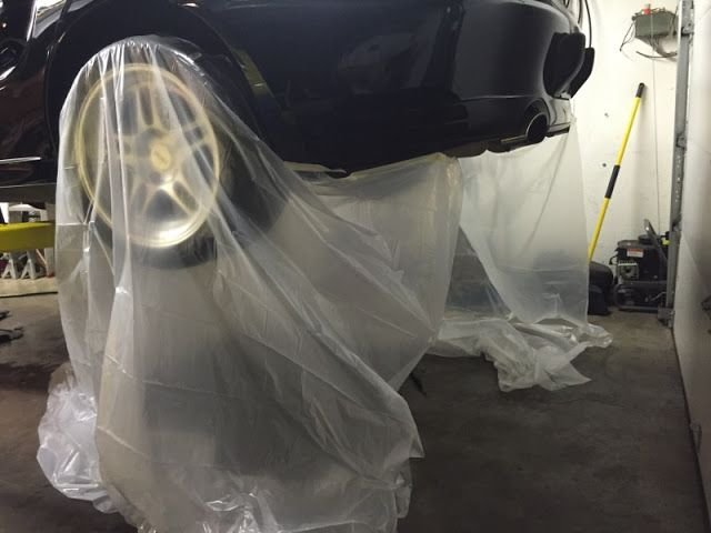

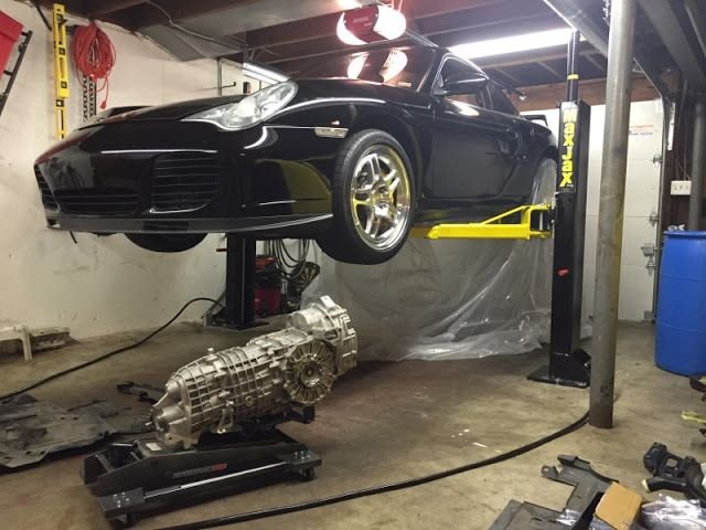

While I have the transmission out I figured this is a good time to get cleaning. The dirt in there was driving me insane. You saw what that transmission looked like. So I ran to Lowes and grabbed some plastic drop sheeting and built an enclosure as to not wet the whole garage or mess.
First I strapped the motor like this so I could remove the jack.
Then the plastic sheeting.

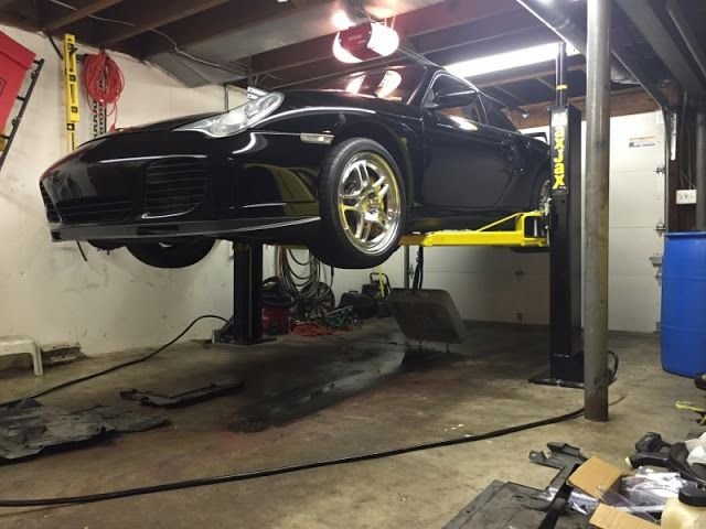

Thank goodness I have a hot water hookup to the pressure washer too because laying under there getting drenched sucked lol. Good thing I have a drain in the center of the car in the garage floor.
Next came about 45 minutes of drying with the air compressor and ear plugs.

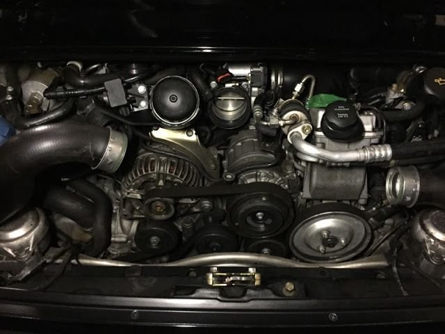

Lowered the car and decided to work on the power steering mod for the GT2 clutch conversion. I only got as far as removing the intake tube, getting dark and late.
Ahh I recognize the power steering unit there from the DIY articles. Glad its coming out actually because its all dirty and needs cleaning.
Decided to lift the car back up and leave a box fan blasting on it and dry up any moisture I missed with the air compressor.

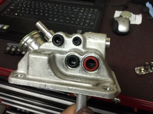

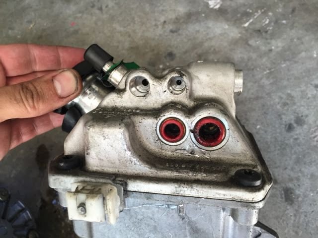

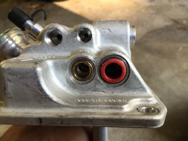

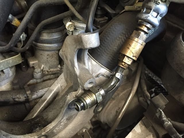

Little more progress today. Pulled the factory slave initially and tried to catch most the fluid there to reduce how much dumped over the engine.
Either I just don't know how these quick disconnects work or this one was seized like a ****. The ends were starting to round I was pulling so hard so instead I just removed the lower fitting directly from the pump.
For those that don't know the reservoir just pulls out the top of the pump. Have a cup ready cause it dumps whats left in there all over.

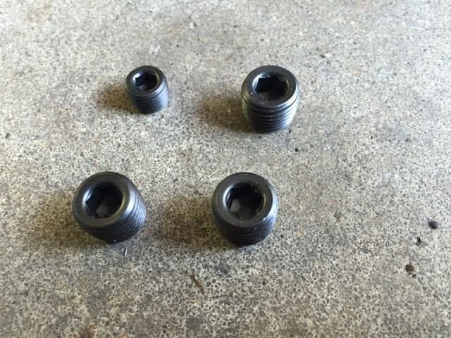

The four ports on the top of the reservoir
A, P, and T2 need to get plugged.
Found these at my local hardware store. 1/8th NPT on the three bigger ones... shoot forgot what the smaller one was. Probably 1/4.
T2 is the most difficult to do. You need to pop the red piece of plastic out and pull the two orings out. Then you see that brass or copper ring at the top. You need to drill it out. I tried tapping it but it starts to spin in there and you can't go any further.
Work your drill bits up till 1/2" which will spin the ring out.
Now you can tap the deeper part. It's pretty hard because you don't have much depth left to work with but it'll work.
All tapped and plugged.

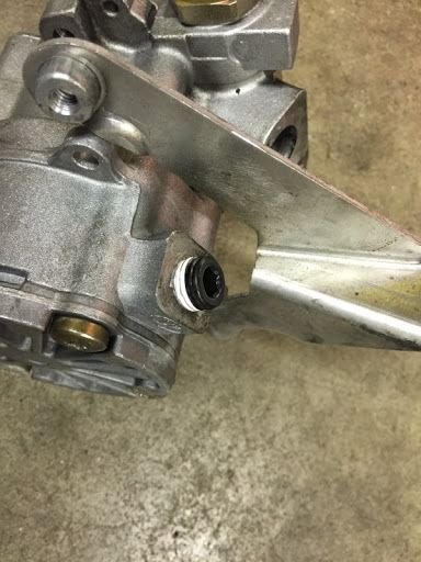

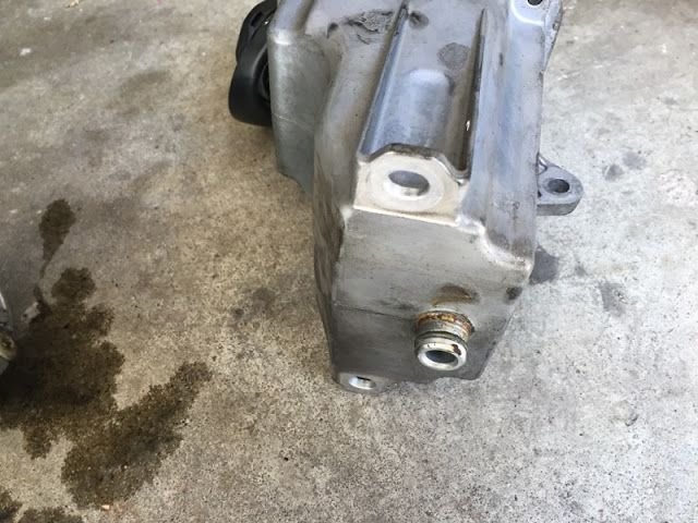

For the pump itself you'll remove and discard that hose you see in this pic and also remove those four bolts on the back and split the pump in half.
When it splits all the way open remove the center coupling piece. It looks like a shaft with a torx almost looking spline on each side.
This tiny sucker. Now close the pump back up. This essentially puts the back half of the pump in neutral. The part that used to spin and pump pressure to the clutch slave.
Tapped and plugged the pump too. This is the back part where I said discard that hose.

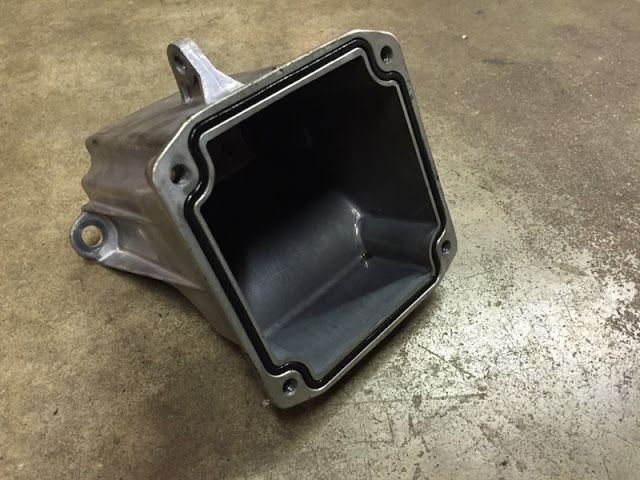

Looks like I need to order a new oring before closing this back up. The old one is rock hard and flat. I don't have much faith in it sealing if I attempt to reuse it. So it'll be next week before I can close this up and put it back as I wait on a new gasket to arrive.
The old hoses that ran from the slave to the pump over the motor removed. Fairly easy except the hard pressure line. It took some muscle and fighting and even two cuts. I was under the car wrestling it and a buddy who swung by lent a hand from over the engine side. We got it out after a few minutes though.
While not really clutch related I'm excited to see what this car will do once I get it going. The clutch has been bad and slipping ever since I've owned it. I put some Toyo Proxes R888s on the back before I started the clutch job so I figured I better get the front up to par too. The Michelin PS up front are rock hard. You could split diamonds with them lol. I think they're just heat cycled way to much and probably old. So UPS dropped these off for me today 235/40/18 (I have GT2 spec rims on the car). I'll pull the front wheels and get these mounted tomorrow and be ready for when the clutch job is done

The gasket on the reservoir is not sold separately. It only comes as part of the reservoir. The reservoir on your car has a TSB on it as many were faulty and redesigned. I bought the GT2/Tip version which does not have any of the plugs in the lid and started with a brand new part.
Old Jun 11, 2015 | 10:46 PM
  #135
MalcolmV8's Avatar
Joined: Apr 2015
Posts: 269
From: Kansas City MO
Rep Power: 35
MalcolmV8 has much to be proud ofMalcolmV8 has much to be proud ofMalcolmV8 has much to be proud ofMalcolmV8 has much to be proud ofMalcolmV8 has much to be proud ofMalcolmV8 has much to be proud ofMalcolmV8 has much to be proud ofMalcolmV8 has much to be proud ofMalcolmV8 has much to be proud ofMalcolmV8 has much to be proud of
Ah that stinks. Guess I'll clean it very well and put a really thin bead of silicon with it to seal then. Any idea what TSB was about? Not saying I'm not affected but the car is 11 years old and 100k miles and going strong. Doesn't seem like there's any issue with it.
