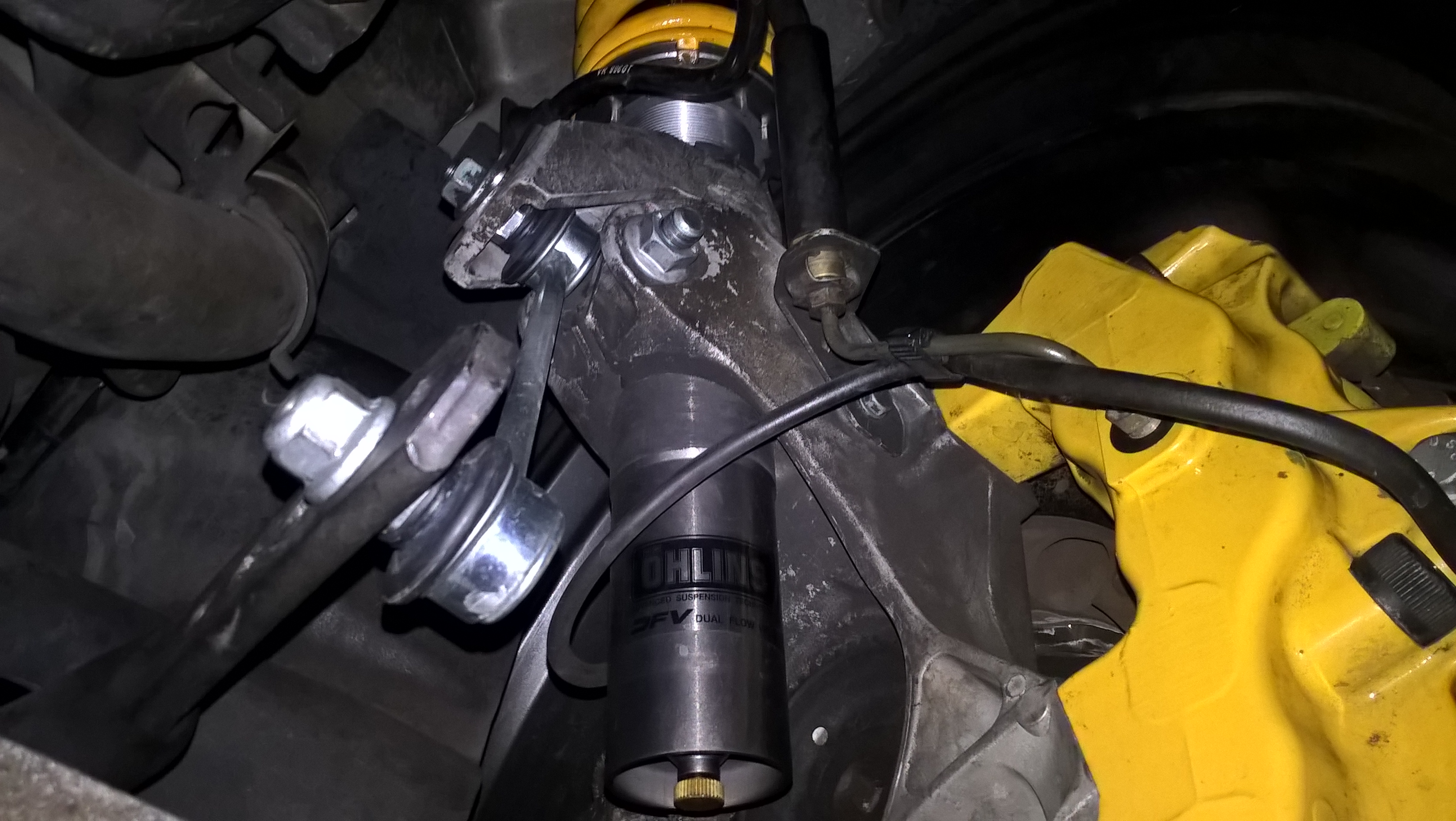

stock GT2/GT3 and no problems

The GT2/3 spindles are no issue. It's the geometry of the awd spindles that creates a large sweep as you turn thus causing clearance issues.
