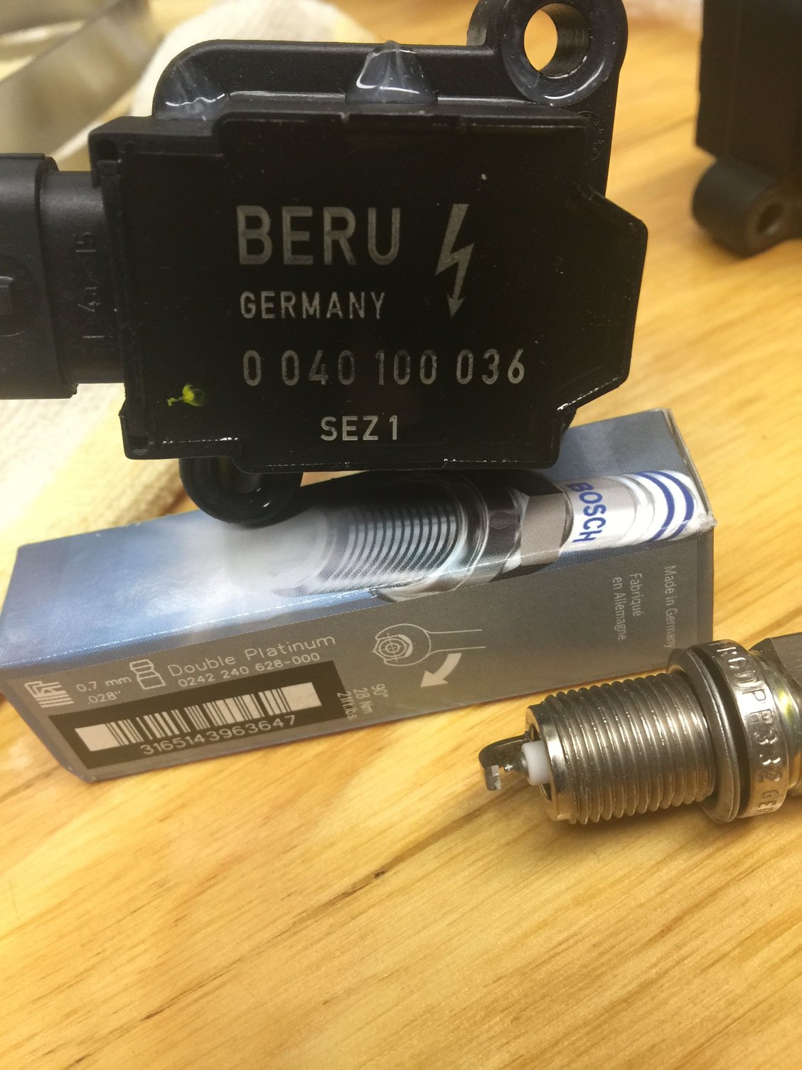

I've got my intercoolers off to do a small upgrade as well as the exhaust system. It'll be really easy to change the plugs right now. I've also got a set of brand-new Beru coils.
Plugs were changed by the dealer only about 3000 miles ago. Coils original as far as I can tell from 2002. The part number is 99660210200
The replacement plugs I have are Bosch FR6 DPP 332 Single electrode platinum iridium.
The cars been running fine. I pulled one coil to examine it doesn't look heat soaked or otherwise cracked or degraded. Should I take the plunge and replace these while I have an easy opportunity?

I change mine every chance I get but even I would say 3k is too soon and the coils are at least a 3 to 1 ratio as plugs but I change mine a lot and the car thanks me every time. Up to you and your level of both tune plus obsession.
Also I would use the dbl electrode Bosch 6's.

If the coils are original and I didn't plan on being back in there again anytime soon then yes I would replace, how many miles on car? Plugs are cheap so I would replace them also but they don't need to be.

turbo engines want the best electrical charge they can get. the best conductor of electricity is copper. all these double platinum quad unobtanium are crap. use a single electrode copper plug and change them every time you do an oil change. (cost is 18$) if the coils are 996 version change them to 997 upgraded coils

Replacement coils are the 997 TT version.

it's plugs and coils. too bad there aren't any 996 coils anymore or else we could debate which of those might be better lol. bottom line is plugs and coils, the more you change em the better the car runs. you're running the hotter plug from the stock 5 so that'll be an improvement, as will the more frequent changes.

So I did the plugs and coils. Why not, eh? I also swapped intercoolers for GT2 version and installed a Speedtech exhaust with new sensors and extenders on the post cat senders.

Beru coils + 7410 Bosch plugs(GT2 stock) is a winning combo that lasts...
