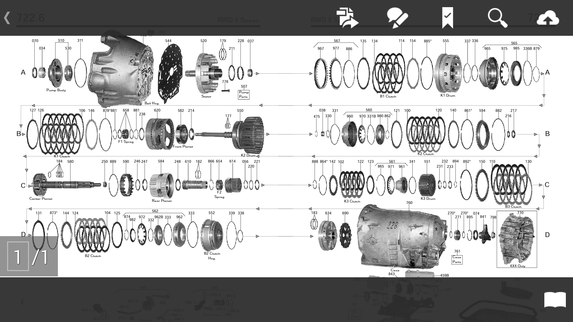

OK I finally found this on another thread! The leak is coming from this seal/area number 544 in the pic. What a horrible mess, lol.

[QUOTE=Ringlord;4365103]OK I finally found this on another thread! The leak is coming from this seal/area number 544 in the pic. What a horrible mess, lol.
OMG this is not funny!!! This picture is from the Mercedes EPC? Can it be coming from higher up were a plug is?
