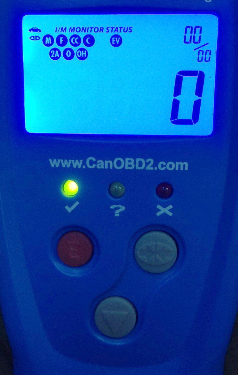

Two years go by and its time to smog again. Everything with the car is fine (no CEL/MIL, no scan codes, stock exhaust back on) so I take it down to a STAR facility and it fails the oxygen sensor heater circuit ready. All other ODB2 monitors were fine. Great. I go home and my durametric scan says fine and there are no ODB2 codes being thrown. I take it to my indy and they confirm alles ist in Ordnung, but suggest changing spark plugs and O2 sensors to be safe.
At that point I remember that the battery was recently d/c to fix a turn signal reset issue, and indy tells me to just complete a drive cycle and the readiness indicators should reset (new to me). I run the standard 996 cycle (https://www.6speedonline.com/forums/...cle-reset.html) about 5 times --- no dice. I run an extended cycle -- no dice. So I'm now 2 weeks into this thing and really frustrated. I make an apt with the CA BAR referee to make the case that the car is an exception and that I shouldn't have to spend $650 on random repairs to be given a free pass (NO JOKE: http://asktheref.org/Services/RepairCostWaivers).

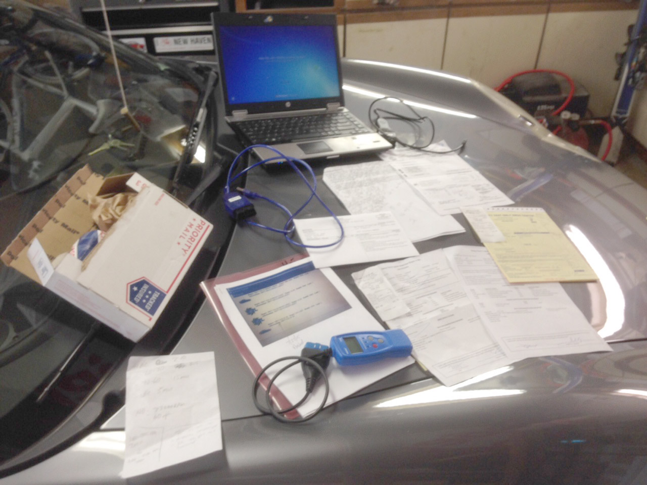

Now, just waiting for my referee apt, I scan the forums for probably the 10th time and see it -- EPL tunes can mess up smogability. I email Tony @ EPL asking for his input and to once again provide access to the tunes purchased for the car (this time on a newer laptop) and get no response. Days and several requests later I finally get a very terse and unhelpful response. On my own I figure out how to unflash the ECU to stock, drive the car for 10 min, and yahooo it passes smog just fine.
THE ONLY DIFFERENCE BETWEEN NO-PASS AND PASS WAS THE REMOVAL OF THE EPL "CA SMOG FRIENDLY" TUNE.
Without my own durametric setup, ODB2 scanner, hard-fought EPL flash file access, 6speed resources, backup O2S to fiddle with, and an honest mech, I would have spent >$1k on unnecessary "repairs" and likely still have no smog certificate.
