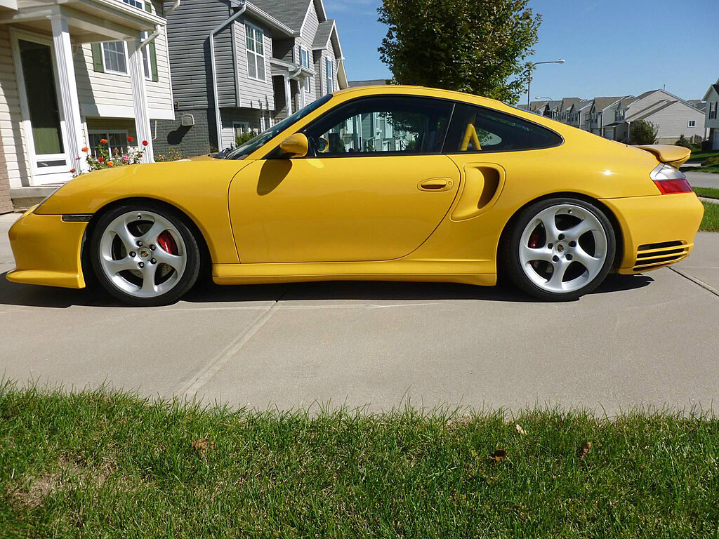

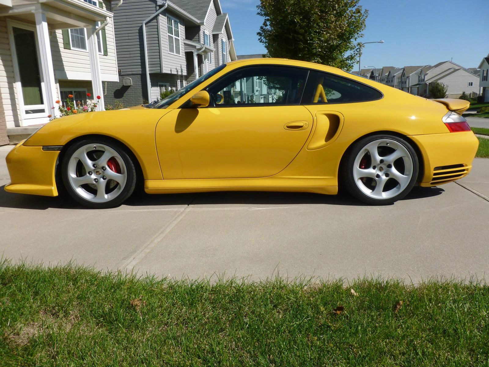

yep, no problem, installing h&r sports.
this how the car will sit, this picture is actual H&R sports lowering springs, plus I have 10mm spacers all around. Cannot wait to see the results.
nice, and should be fairly representative. I can fit my index finger btw the tire rubber and the bottom of the liner. perfect stance.
Looks perfect. I have 14mm spacers in the rear...I'll definitely need to get some front spacers!!!
