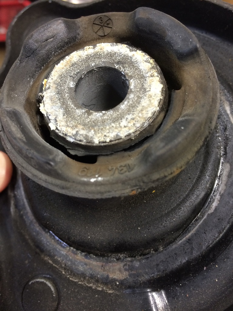

Fairly super easy. Well. Suprise suprise. Need mount bearings. 2 bump stops. One stablizer busted. Never ends. Anything i touch on this car needs to be replaced. Lol. And upper mouts look a bit cracked. But im going coilovers next year and i dont drive much.

Thats negative doctor, other side looks a lot worse so replacing both, ordered all ready, You think this sleeve looks fine to you!!!!!! HA?
I'm glad i Even went for lowering springs, replacing all this broken A$$ parts.
2 bumpers (check)
1 stabilizer link (check)
2 front mounts (check)
2 upper bearings

I told you, man. Super easy to install suspension on these. Glad it is all working out for you!
