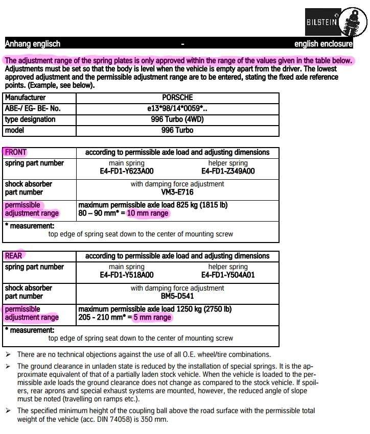

The PSS10 instruction are very specific to the ride height they need to be set for optimum performance and to prevent bottoming the bump stops. There is only a 5 or 10mm adjustment range if I recall. Stick with what is spelled out in the instructions for proper performance. When properly set PSS10s do not lower you car all that much. Judging by your after pics, you are right in the correct range.

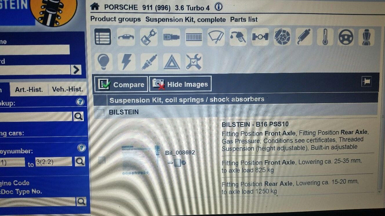

This is directly from Bilsteins website for the B16 PSS10 with part numbers 48-135368.
Fitting Position Front Axle, Lowering ca. 25-35 mm, to axle load 825 kg
Fitting Position Rear Axle, Lowering ca. 15-20 mm, to axle load 1250 kg
http://web1.carparts-cat.com/default...D018004&12=130

pwdrhound and jimtt are correct. I have been researching coilover options for months (my head is still spinning lol) so I have pretty much all the specs for the sub $3000 coilover options for 996TT (Ohlins R&T, Pss10, H&R Street coilovers , H&R Race coilovers). In fact some time ago I had posted questions about these setups and pwdrhound was the one who enlightened me to the fact that bilstein pss10 have a VERY limited "in spec" height adjustment range.
After all my research I ended up going with H&R Street Coilovers because they offer a huge height adjustment range (in comparison) of 20-50mm lower than stock while still being in spec. I got this info directly from H&R in Germany via email. Btw, they were fantastic about answering all my questions over the months

Gophaster,
Then this doesn't make sense as this is straight off their website for our cars.
It clearly shows the following lowering ranges, or am I missing something?
Edit; does this mean front lowering range is 35 -25=10 and rear 20-15=5mm?
Gophaster,
I think you might be mixing up Lowering Range and Adjustment Range.
The "Lowering Range" 25-35F/15-20R.
The "Adjustment Range" is 10F/5R
So with this setup, the drop is 30mm +/-5mm in the front and 17.5mm +/-2.5mm in the rear.
Ok got it, thank you highlander.
