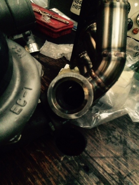

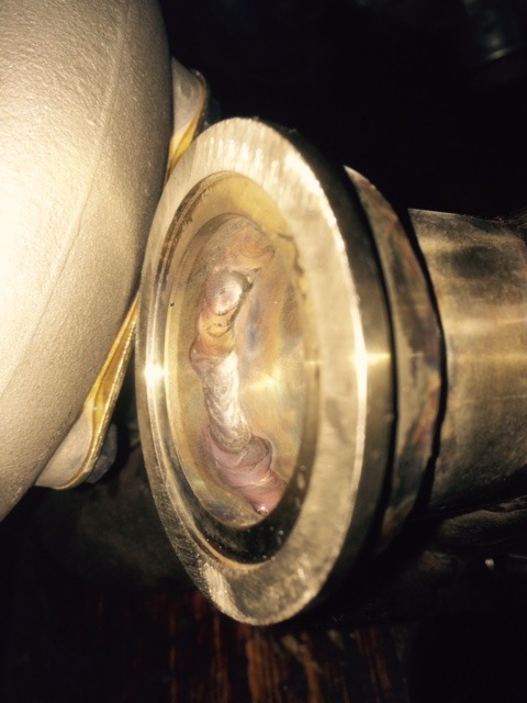

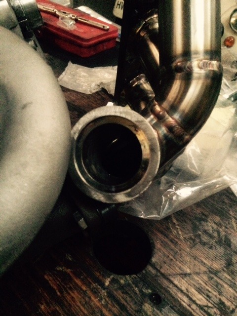

Just fitting the 3582's on the car and one side fits perfect, however when the comp housing is rotated to be in the correct aspect it fouls the wastegate mount, anyone else had this?
Comp housing incorrect aspect

Correct aspect

Only thing I can think of is to cut a slot in the pipe for the wastegate and that will enable it to move slightly away from the comp housing by closeing the gap left by the cutting disc and then TIG weld it back up.

Is the wastegate in a T or a V in reference to the header? My compressor was so big I had to mod the oil tank lol.....

Yea a pie cut with the correct angle should pull the gate out enough. i would imagine the gates clear the swaybars right? Mine were pretty close....just fyi.
Yeah the left side gate (your drivers side) clears the swaybar by about 3mm.
