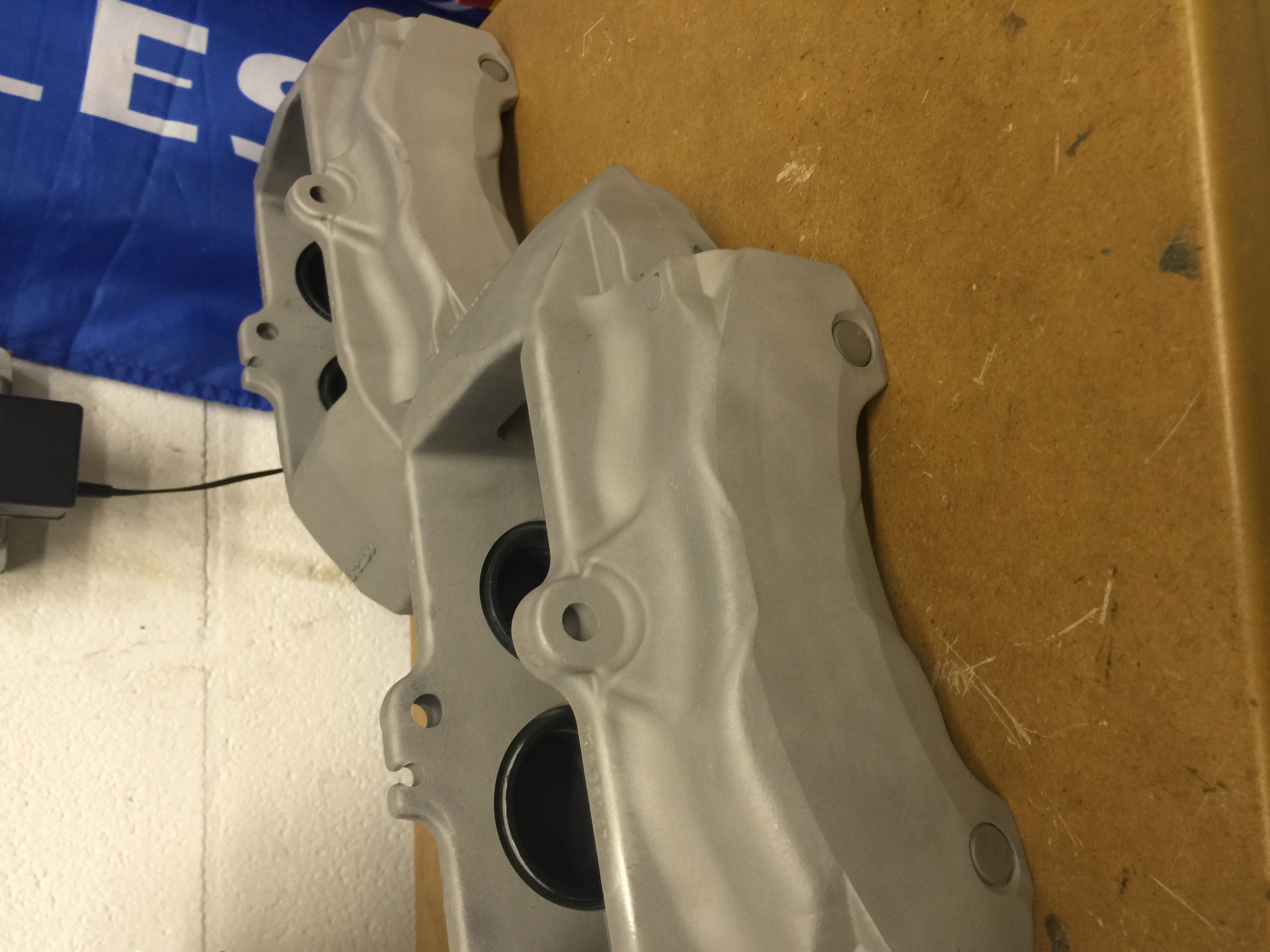

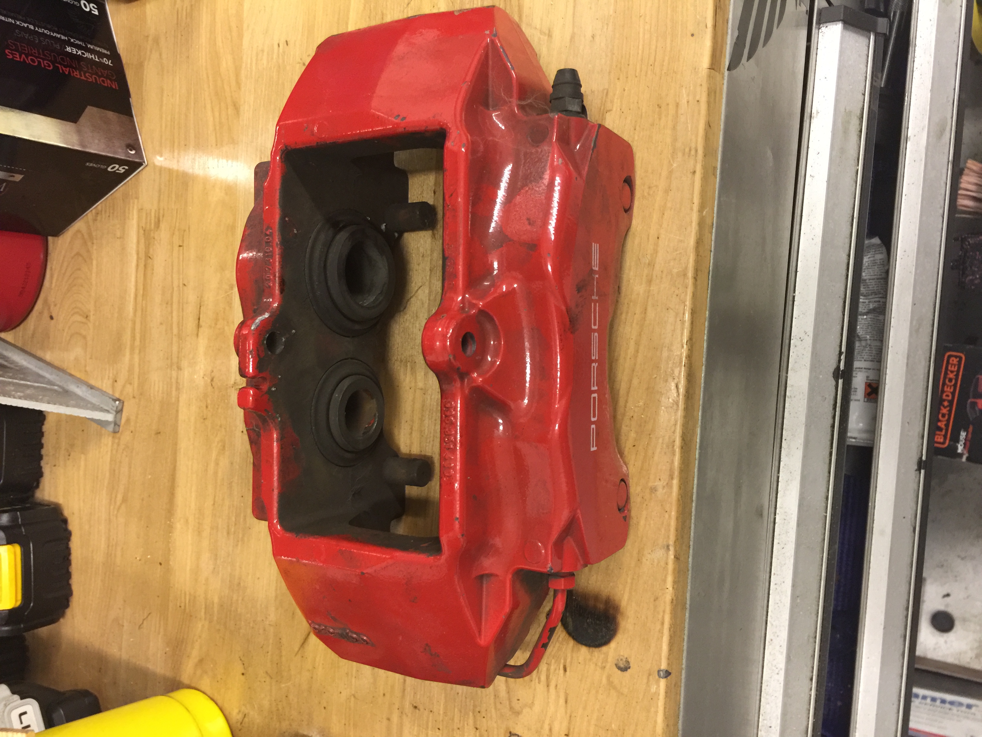

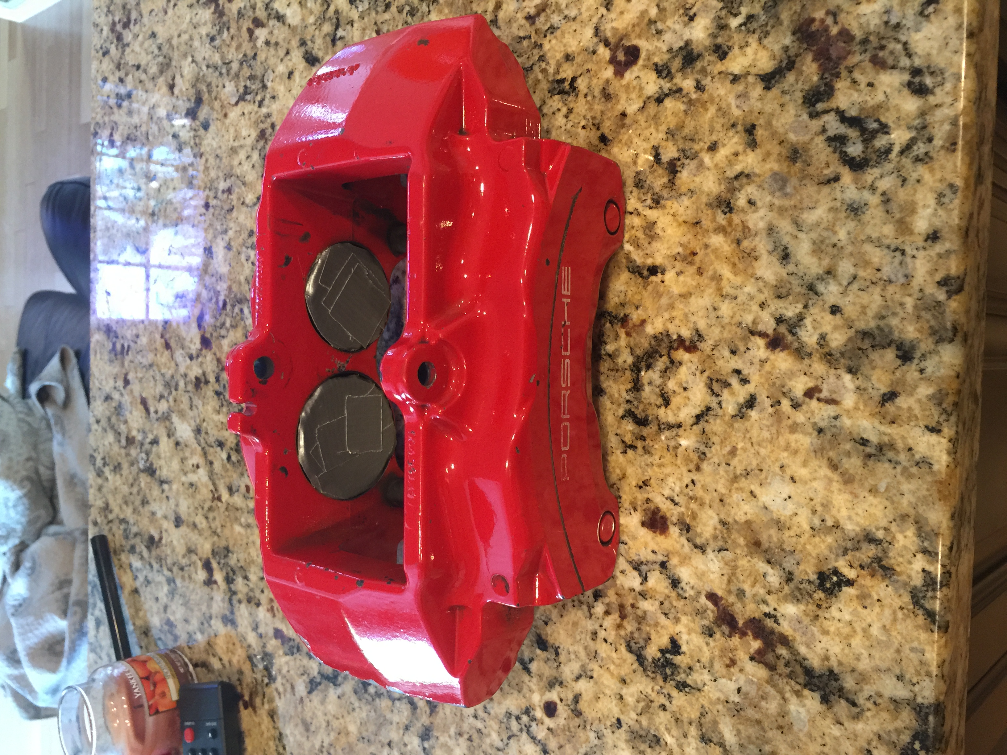

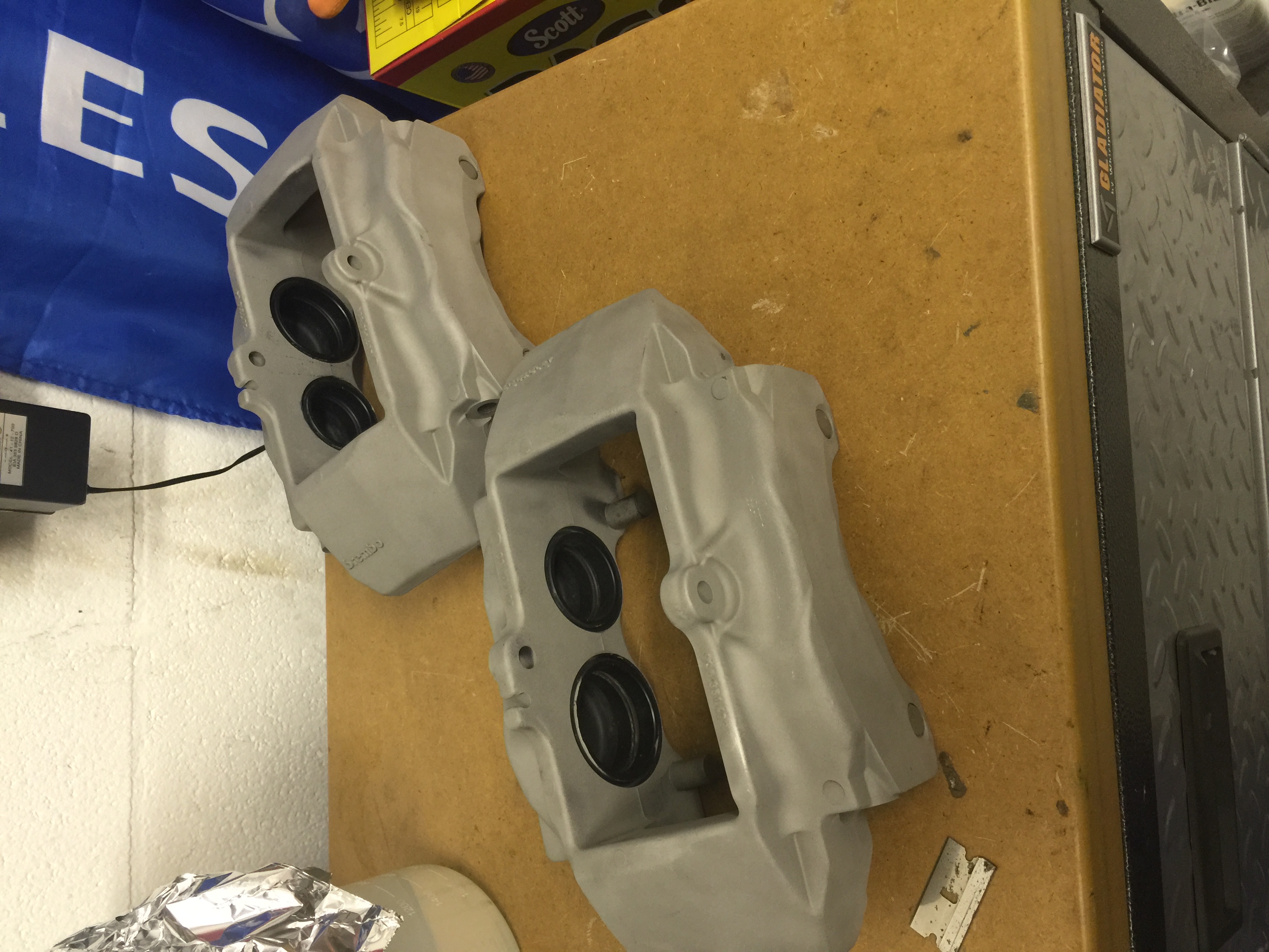

Been going through the entire suspension and refreshing parts. The final part are the brakes. The car has 104k on it and don't know if they've ever been inspected. I figured it was a good time to do new seals and refresh their appearance. So far, I have the fronts all torn apart and blasted. I took special care not to blast the piston bores as they are anodized. I also plan to tape off the section of caliper where the backing plate sits up against when I powder coat. See below for pictures of the progress. I'll update this thread as the calipers are coated and finished with new decals. Thanks guys

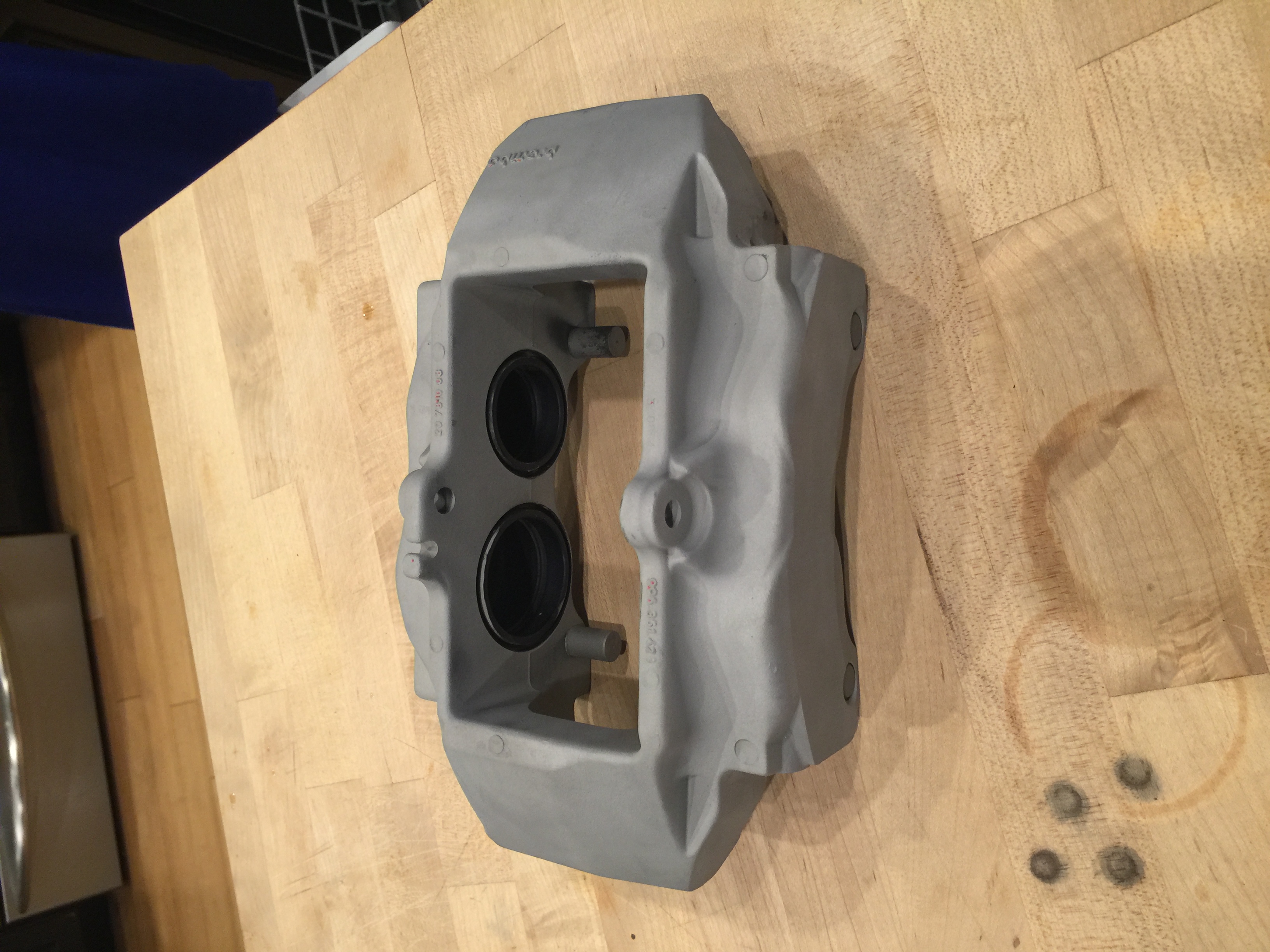

It is very easy to destroy a set of calipers if the person is rushed or just doesn't know what they're doing. I've powdercoated dozens of calipers and never had a problem (even on BMWCCA race cars). A lot of people will go crazy with blasting and coating. The most common problem I see is laying down a thick coat of powder all around the piston bores. This makes reassembly with the dust boots a real issue. To reduce the blasting time, I use HD paint/coating stripper which removed 90% of the previous finish. After that, they get blasted with 90 grit garnet sand which is not as harsh as aluminum oxide and provides a perfect profile for the powder. All the holes/ports/bleed holes are plugged for this step. The piston bores are protected with multiple layers of duct tape. After the blasting and blow off of compressed air, the plugs/duct tape are removed and they get a rinse in an acetone bath for several minutes/cycles. The calipers are left to dry and are ready for masking and prep before laying down the powder. Should have the powder tomorrow and will keep this thread updated. As of now, I have the front 2 calipers stripped and blasted.

yep they actually blasted the piston bores since i sent them without the pistons as i was replacing them. they then p/c the bores !! no way the pistons would go in and they had to be chemically stripped to clean the bores. cost me a small fortune. post finished pics i would love yellow calipers

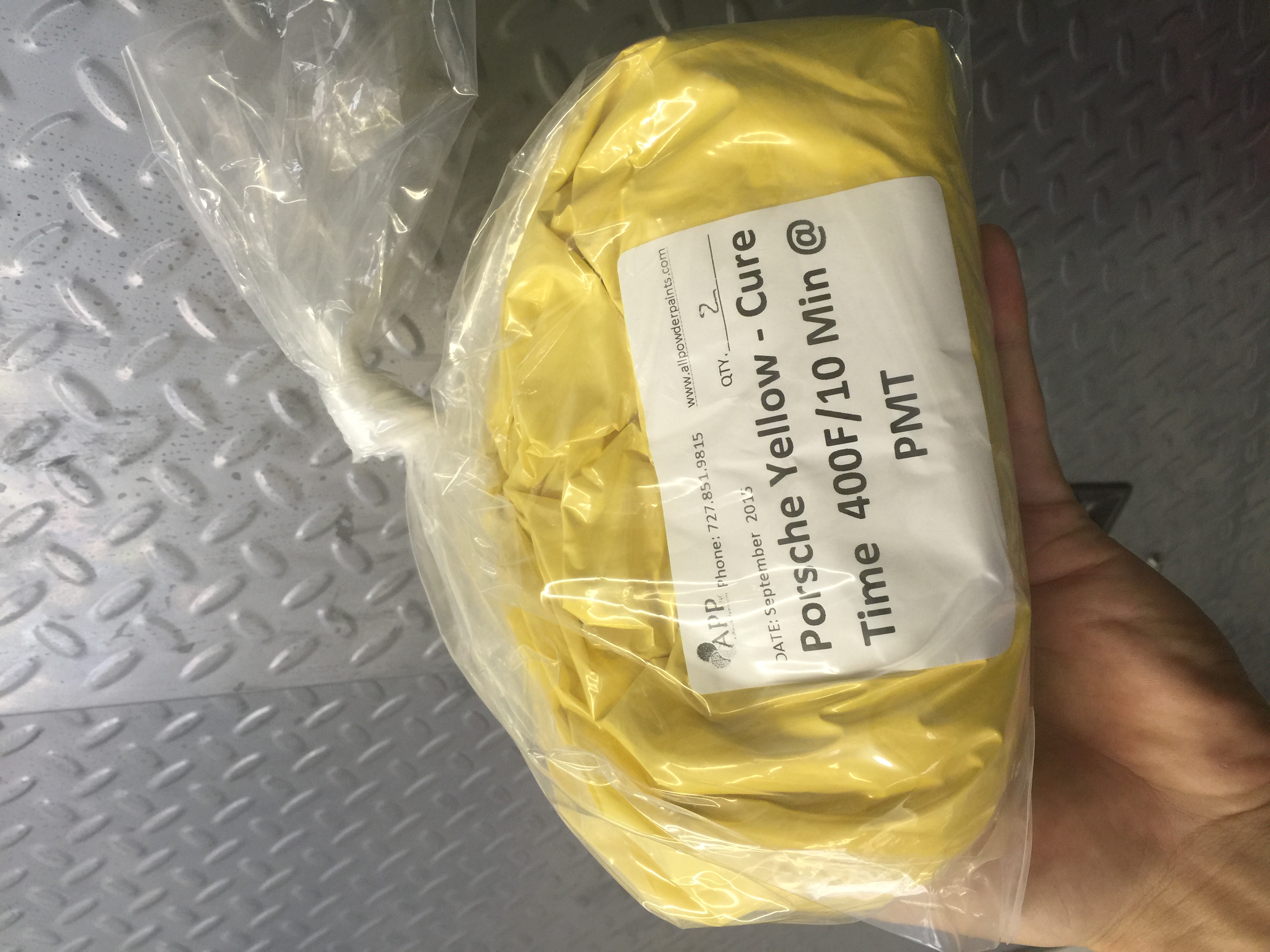

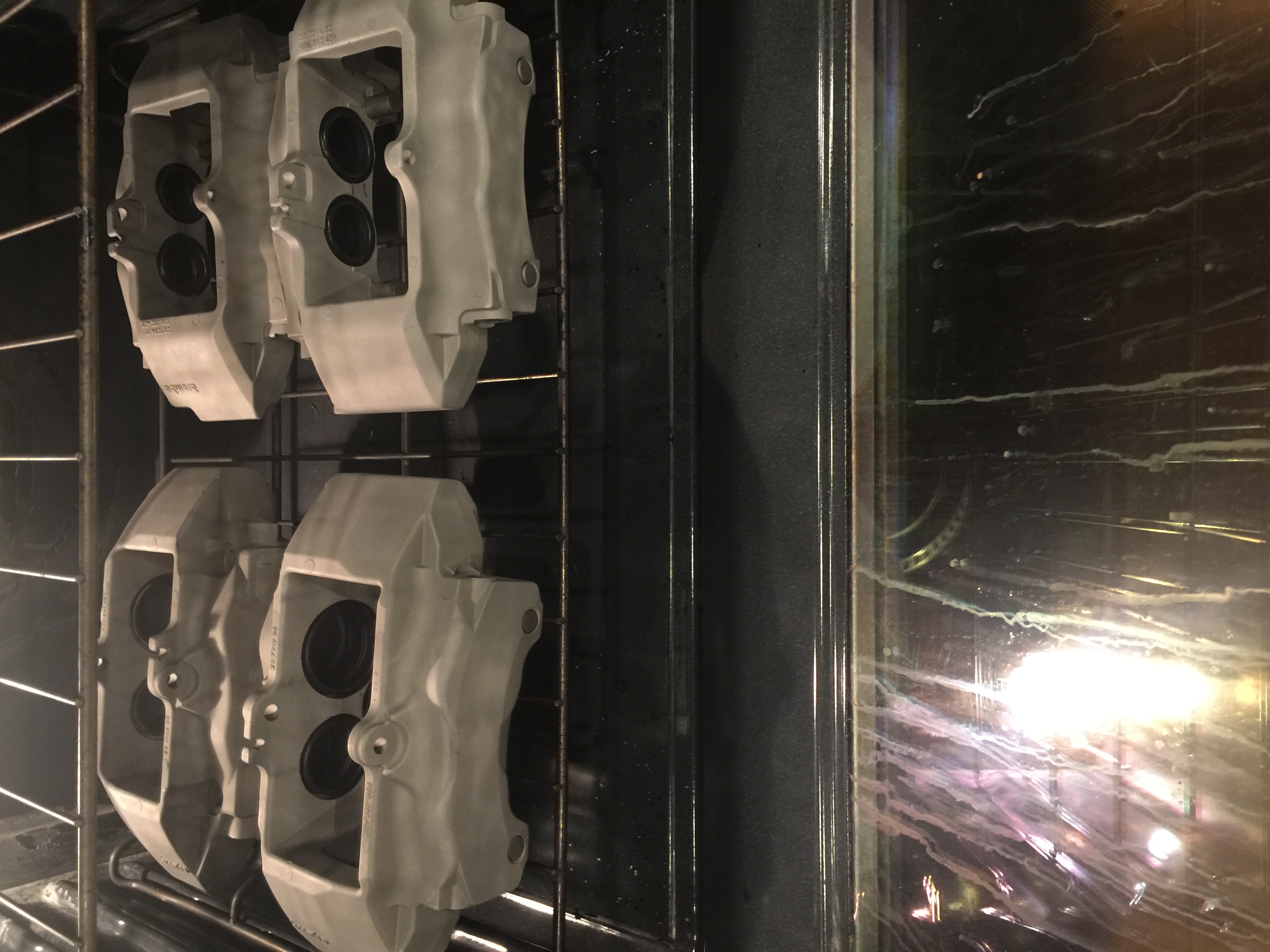

I was able to spend some time in the garage and got the remaining calipers stripped/blasted and cleaned. Also put them in the oven at 450 for around 30 mins to "gas out". I will hit them with denatured alcohol and out gas one more time before masking and spraying the powder. Also picked up some powder today. I got mirror red, porsche yellow, argento (metallic grey) and mirror clear.

touche"!! they aren't gray thats the bare metal being heated to outgas any pockets in the metal. this was an issue i had with the m/b calipers. they had tons of pinpricks in the p/c from outgassing
