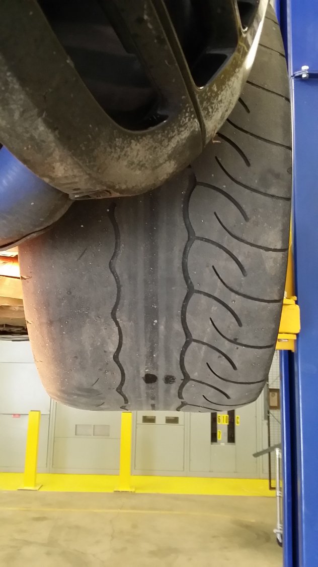

When the tires are like this they contribute to what you are experiencing.

This is what you want your tire wear to look like... These were full tread when new...
