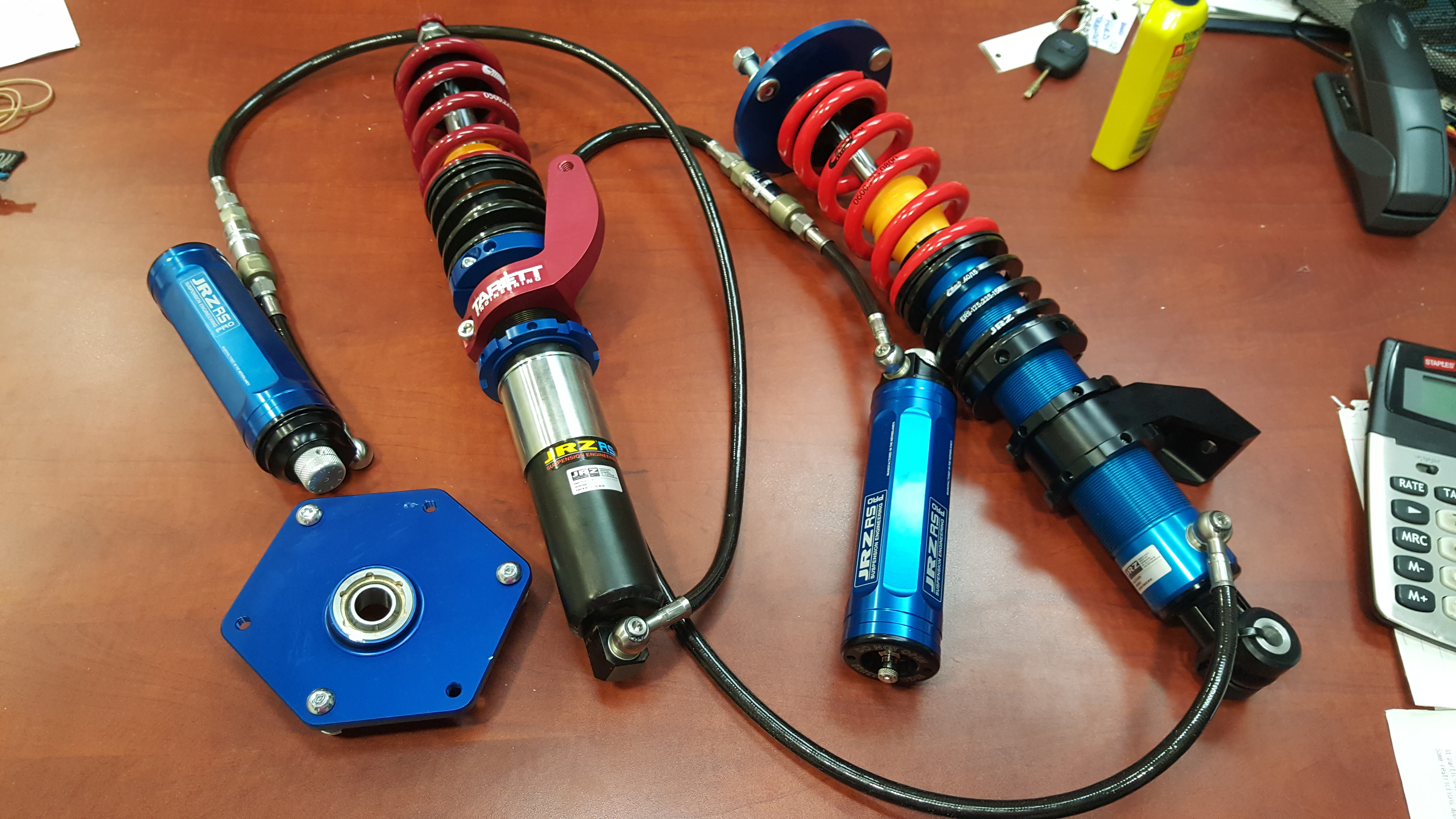

I couldn't agree more Tim is a great guy. Very helpful and easy to deal with. My JRZ are sitting under my desk at the office waiting for the car to come back to be installed.
