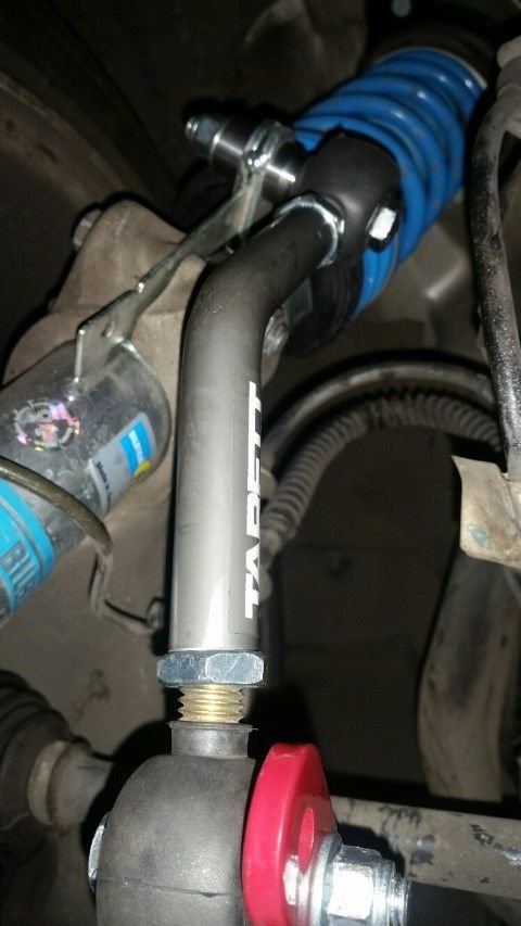

The Tarret ones that I have felt better on the car but they were binding. The PSS10's are good but once you've tried the Tarret you can feel the difference. The Tarret give the car a more precise and sharper steering. This will be the 3rd front set sent to me, the latest ones will have a curve and hopefully clear everything. There's not alot of clearance with the front drive setup.

Custom Tarrett DL's arrived today and fitted today :-) . Had to do a small mod, see pics. No more binding, yippee.
996TT with the AWD really need these bent links, the straight ones do not work, believe me I've tried every angle, spacers and length. The PSS10 ones do not work with the Eibach sways either, they were over stretched and badly split on the rubber dust cover.
Ira at Tarrett was amazing to deal with and can not thank him enough for his excellent service.
