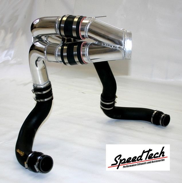

It's a good time to do the turbo fresh air inlet pipes/plenum, if you ever plan to turbo upgrade in the future.
