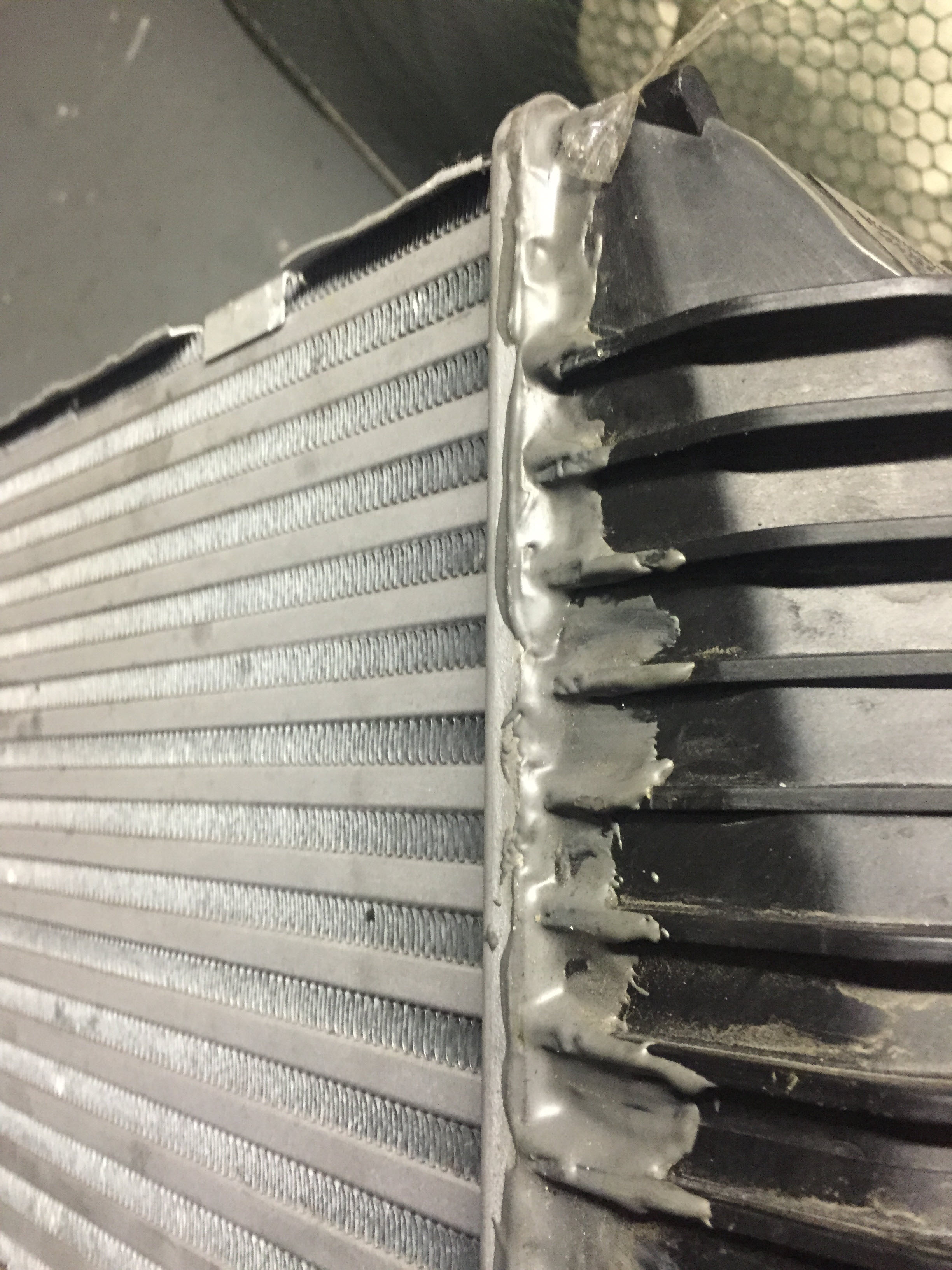

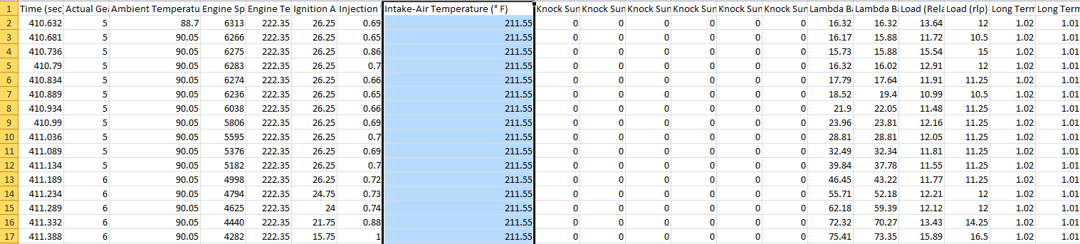

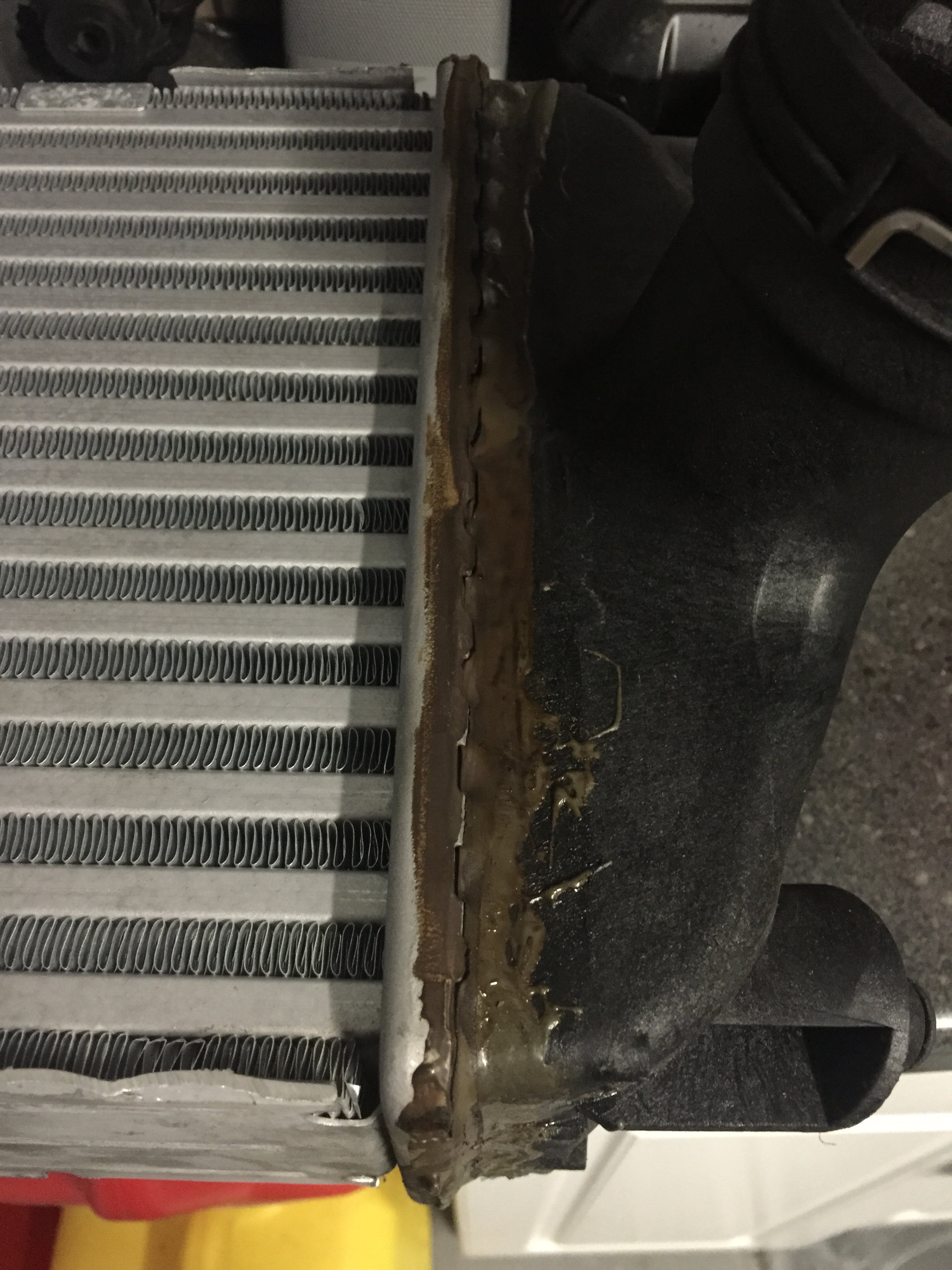

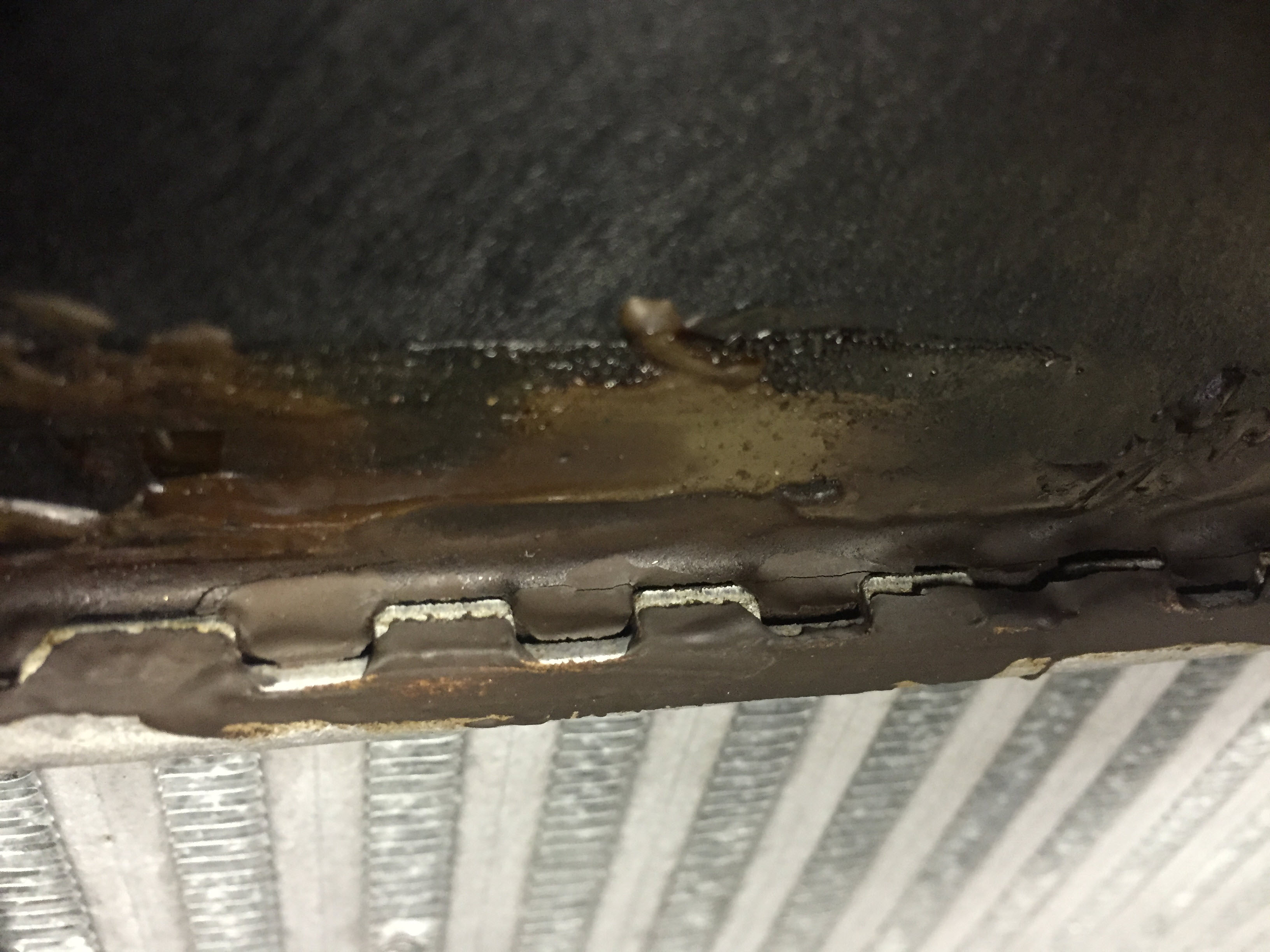

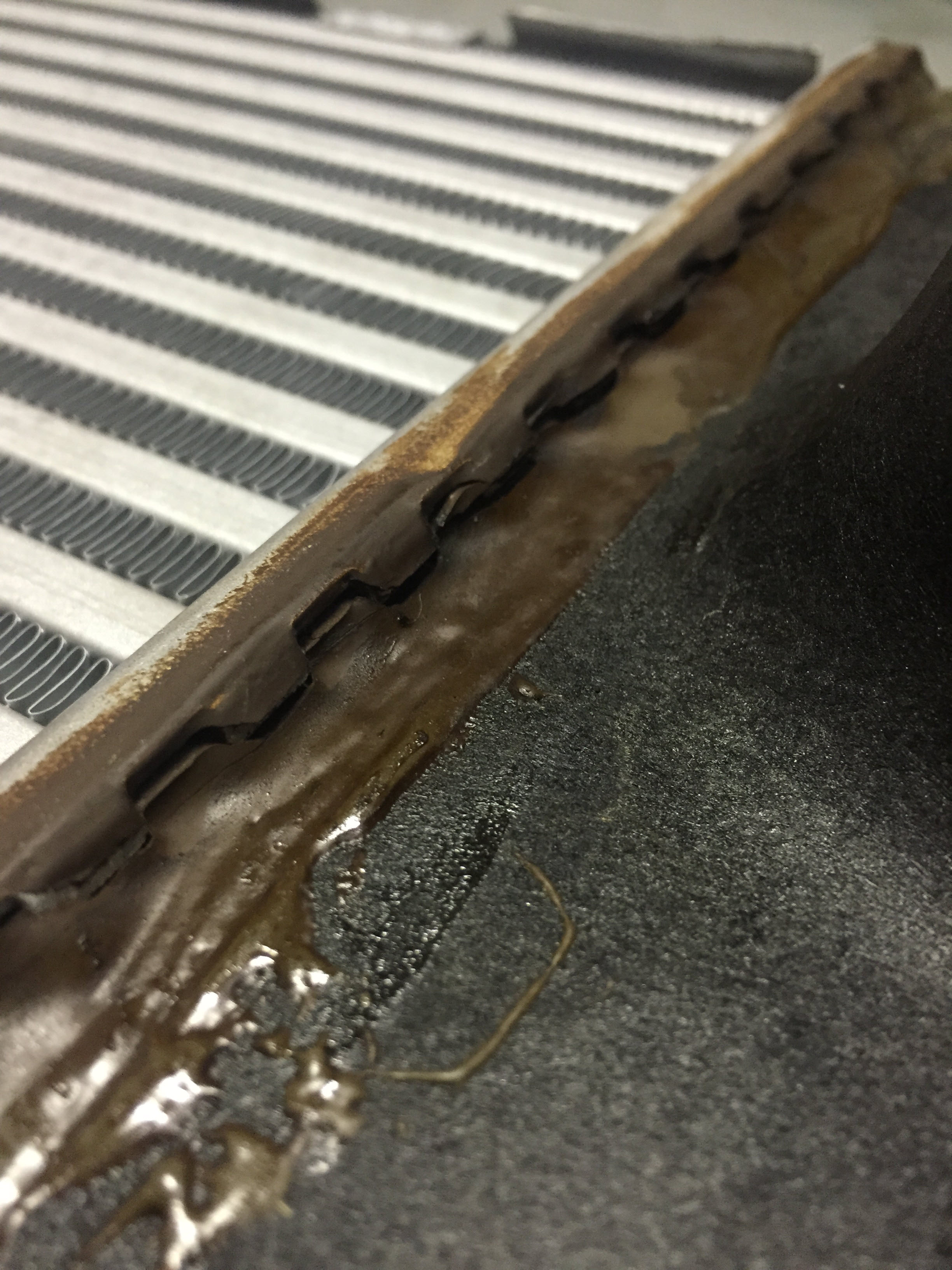

pwdhound is correct with my setup. I was a little shocked to see the JB Weld turn brown and actual separate on the hot side of the intercooler (the formula I used was good for 600F at a 10 min duration and rated stable at 550F at 3960 PSI.) I was also surprised when conducting a pressure test on them, they dropped from 30lbs to 0lbs within a couple of seconds.
A few logs were over 200F for intake temps when ambient temps rose above 90F. I log ever run.
Car Dynoed a measly 518whp prior to track season and nothing was changed with the setup or tune afterwards.
Regardless, even though the GT2RS intercoolers perform well, they are not an option for me..
