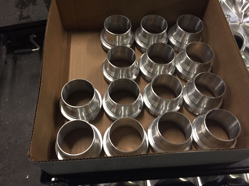

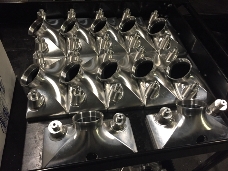

We should have these cores in hand middle to latter part of January. Once they arrive, SRM will be welding on specially designed aluminum end tanks with full 2.5” inlets and outlets designed for hoses with T-clamps or worm clamps. Projected price will be $6950 including all 4 hoses and clamps. Hoses will be available for both the 996TT/GT2 and 997TT/GT2 platforms. While not cheap, these will satisfy the niche market of those looking for the best intercooler you can buy for the 996/997 platform. I suspect these will really shine on the 997TT platform which has to deal with the hot running VTGs. No shortcuts, no compromise..
