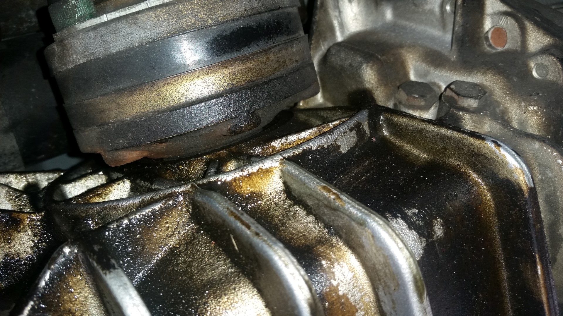

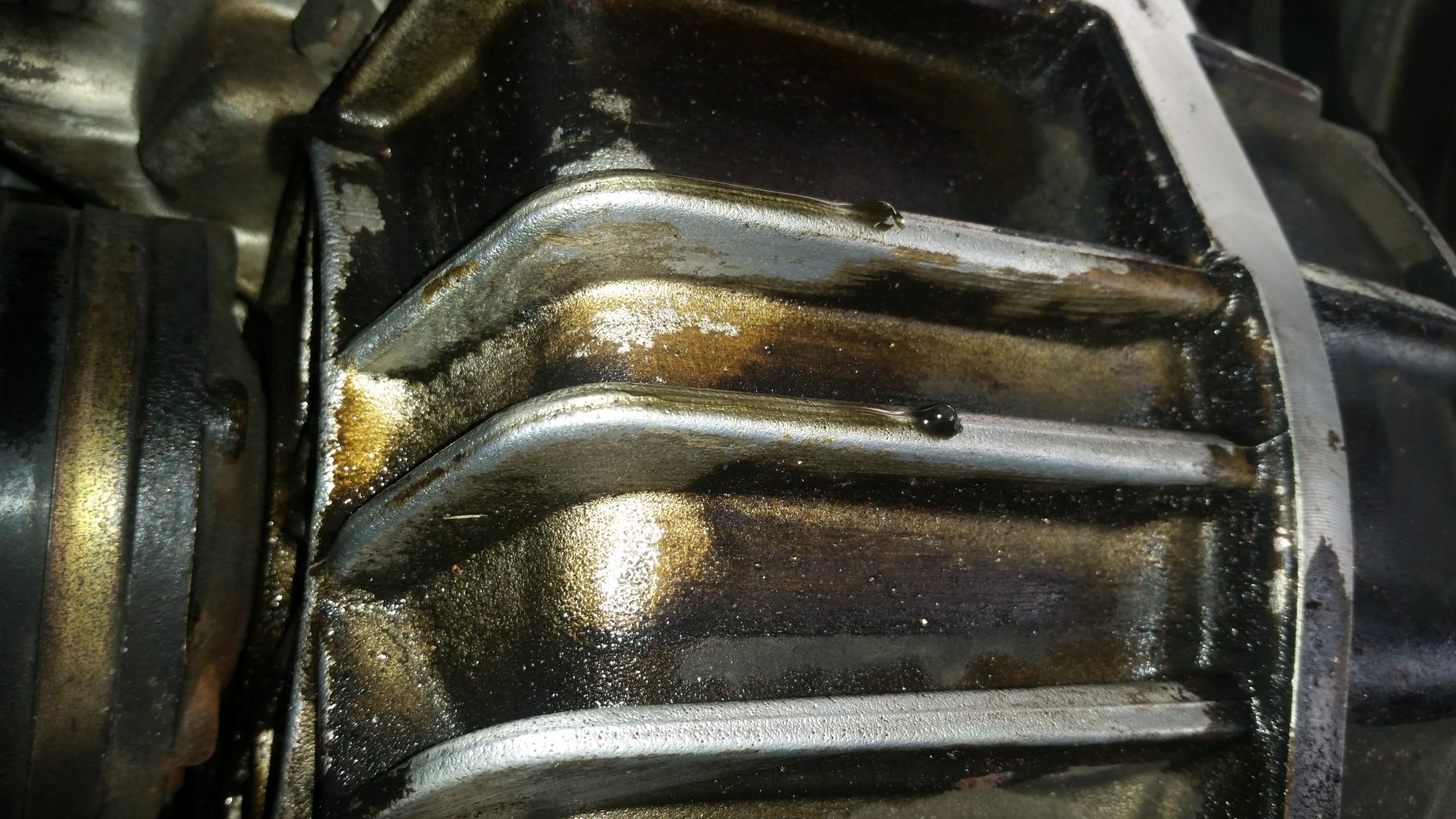

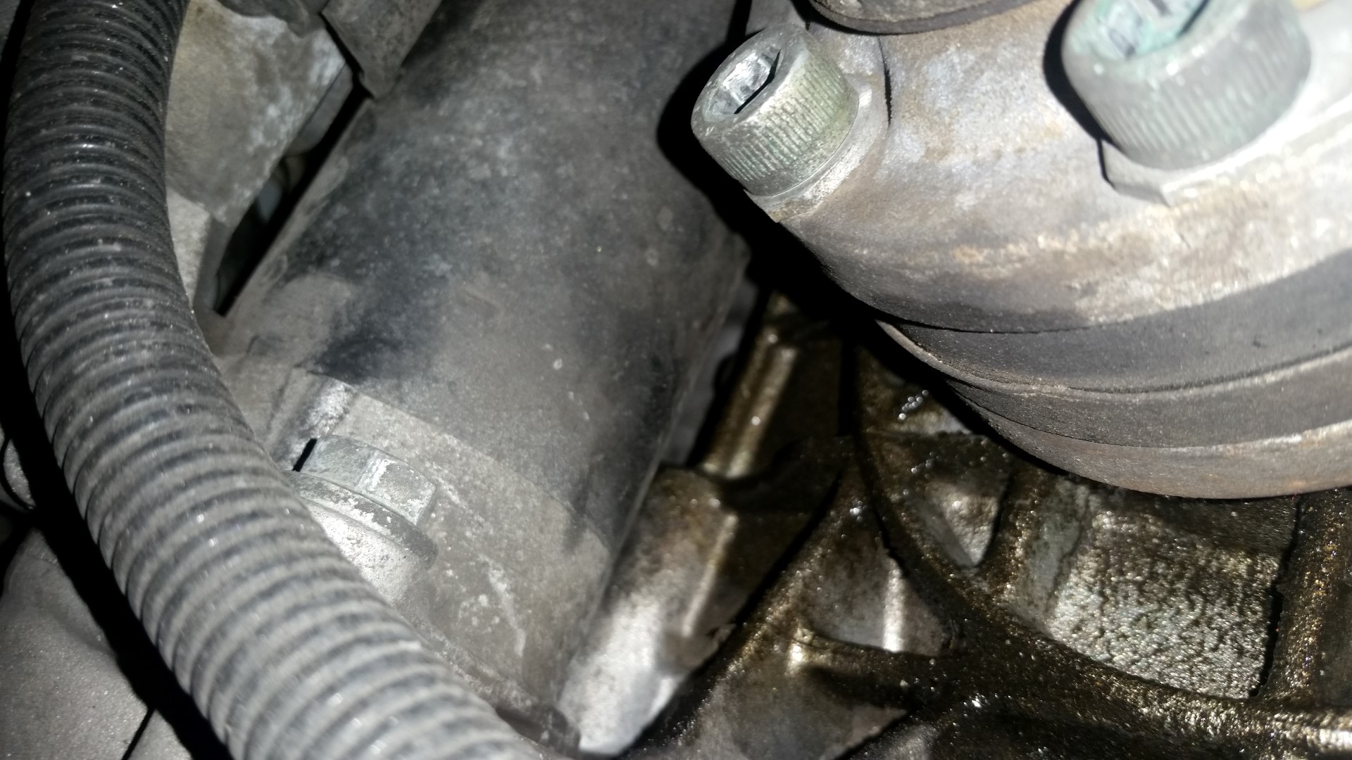

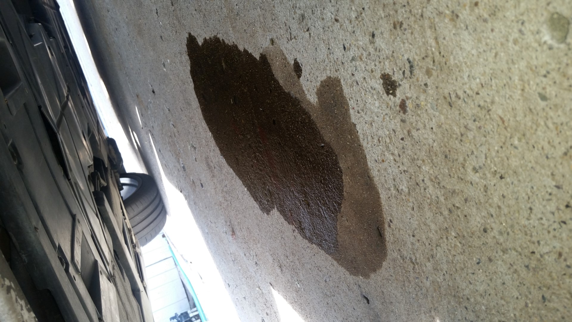

Hello all - I'm new to the forum and recently purchased a 996tt that I bought from a member here. I drove it home to San Diego from Jackson, MS without event - it was a great drive.
Upon arrival, after the first night back, I noticed a relatively large pool of oil below the car that seems to be accumulating and dripping from the passenger side rear axle where it meets the transmission. Any ideas as to what this could be? The oil doesn't appear to be thick tranny fluid and smells similar to engine oil. However, the engine oil level appears to be holding constant. Any input is useful - pics attached.

Old Jan 9, 2016 | 02:27 PM
'02996ttx50's Avatar
Joined: May 2009
Posts: 7,984
From: la
Rep Power: 608
could be as simple as a drain bolt not tightened to spec! happened to me before! i can't recall the socket size? but dbl check and just tighten the oil pan an crank ones
Old Jan 9, 2016 | 02:42 PM
Integral's Avatar
Joined: Dec 2015
Posts: 91
From: San Diego, CA
Rep Power: 14
Integral is infamous around these parts
yea the drain and fill bolts looked fine and couldn't find any other bolts that could be loose...
Old Jan 9, 2016 | 02:51 PM
rmc1148's Avatar
Joined: Jul 2012
Posts: 2,382
From: kirkwood pa
Rep Power: 434
Clean everything and keep looking is about all you can do= hopefully something simple.
Old Jan 9, 2016 | 03:35 PM
32krazy!'s Avatar
Joined: Dec 2008
Posts: 5,551
From: tn
Rep Power: 628
likely could be the axle seal. as it seeps out it can get flung all over. its a 75/90 gear oil not all that thick
Old Jan 9, 2016 | 04:29 PM
Integral's Avatar
Joined: Dec 2015
Posts: 91
From: San Diego, CA
Rep Power: 14
this is the preliminary diagnosis i believe i as well.
any idea as to the time to do said repair and potential related costs? again, i'm quite the porsche noobie...
Old Jan 9, 2016 | 04:30 PM
BLKMGK's Avatar
Posts: 2,949
From: Virginia
Rep Power: 575
BLKMGK Is a GOD !BLKMGK Is a GOD !BLKMGK Is a GOD !BLKMGK Is a GOD !BLKMGK Is a GOD !BLKMGK Is a GOD !BLKMGK Is a GOD !BLKMGK Is a GOD !BLKMGK Is a GOD !BLKMGK Is a GOD !BLKMGK Is a GOD !
Also check power steering fluid level, could be Pentosin...
Old Jan 9, 2016 | 04:36 PM
Integral's Avatar
Joined: Dec 2015
Posts: 91
From: San Diego, CA
Rep Power: 14
yea, that was one of the first things I checked - it was fine. if it was that, where, given the leak location, do you think it would be leaking from?
Old Jan 9, 2016 | 05:50 PM
rmc1148's Avatar
Joined: Jul 2012
Posts: 2,382
From: kirkwood pa
Rep Power: 434
If you do the seals yourself it cheap and not that hard.
Old Jan 9, 2016 | 05:53 PM
BLKMGK's Avatar
Posts: 2,949
From: Virginia
Rep Power: 575
The P/S system boosts the clutch. There's a metal line that runs between the pump and the slave cylinder. On my car that line had a fitting fail at the pump way up in the bowels of the car, it required pulling an axle on the driver's side to replace. It made a pretty big mess and coated the entire rear of the car....
Old Jan 9, 2016 | 06:23 PM
32krazy!'s Avatar
Joined: Dec 2008
Posts: 5,551
From: tn
Rep Power: 628
if it turns out to be the axle seal. drain the diff. the trans and differential share the same fluid. once the diff is drained remove the 6 axle allen bolts. need 6 new they are one time use. drop the axle down and let it hang. theres a bolt in the center of the stub axle. remove it. the outer case has a circle of bolts. remove them and remove the outer housing. theres a rubber ring on the outside edge and a seal on the inside
Old Jan 9, 2016 | 06:48 PM
Integral's Avatar
Joined: Dec 2015
Posts: 91
From: San Diego, CA
Rep Power: 14
thanks a lot for all the replies, guys. i'll get back under it tomorrow and see what i can figure out!
Old Jan 9, 2016 | 07:15 PM
32krazy!'s Avatar
Joined: Dec 2008
Posts: 5,551
From: tn
Rep Power: 628
correction lack of sleep on my part. pass side is the same except the housing is cast onto the diff. so theres only the single axle stub seal. i was thinking drivers side
Old Jan 12, 2016 | 03:36 PM
Integral's Avatar
Joined: Dec 2015
Posts: 91
From: San Diego, CA
Rep Power: 14
yea so it ended up being the diff seals at $27/ea, replaced both and got a post-purchase inspection at the same time from a local indy mechanic - pretty stoked overall.
now, time to beat on her.

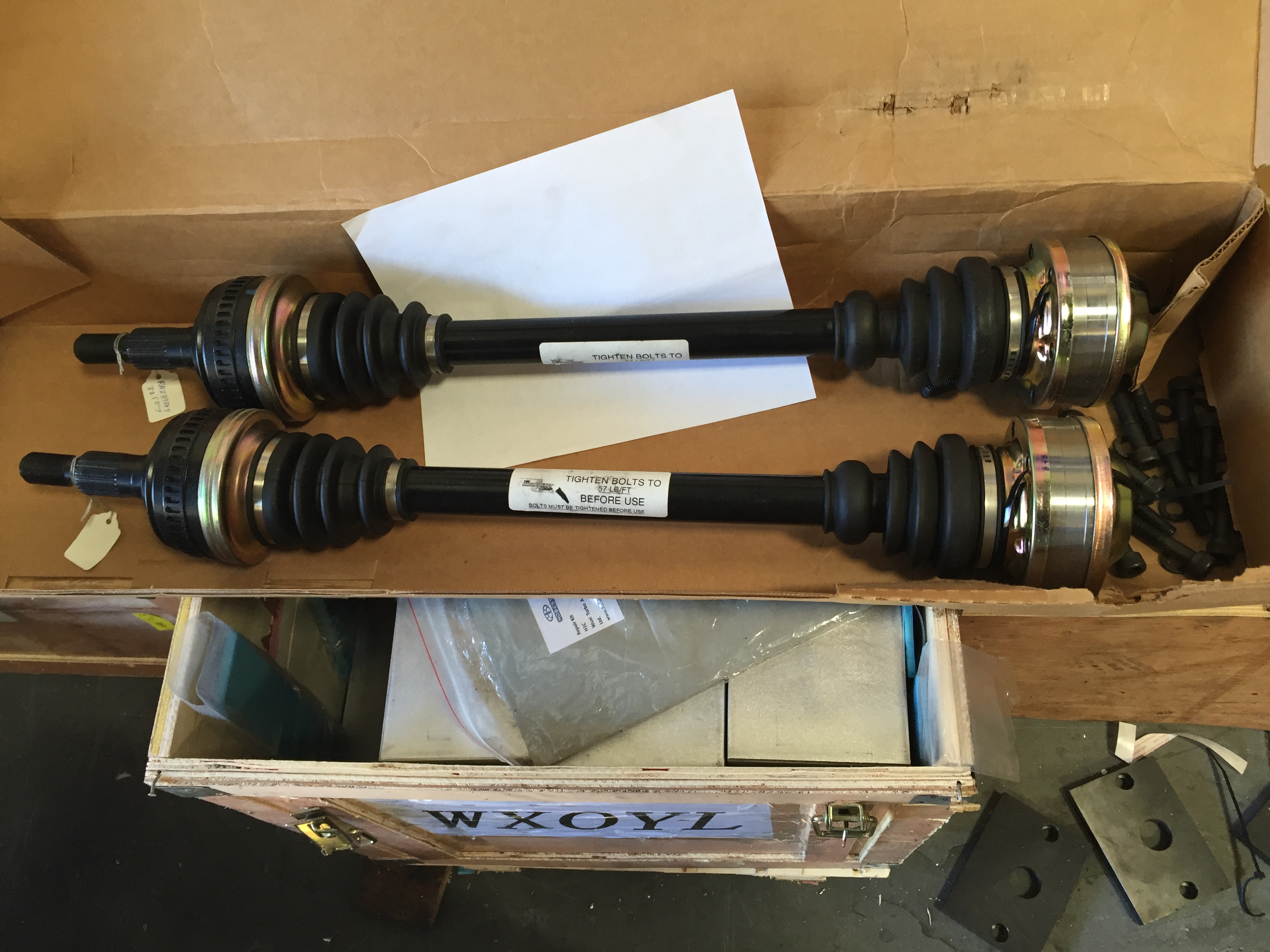

Old Jan 12, 2016 | 05:47 PM
32krazy!'s Avatar
Joined: Dec 2008
Posts: 5,551
From: tn
Rep Power: 628
then you need something like this! stage 5 1000 hp dss axles
