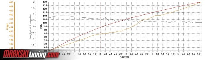

there are basically 2 types, k16s 7 blade from tial and 6 blade from Blouch.
Todd uses blouch.
Ive tuned both many times... on pump gas they seem very similar.
The late randy form lambda ran a 5.86 sec 60 to 130 mph in his car after I worked on it...
food for thought... tial does re haul but is more money. in the end you cant go wrong with either, yo just have to be in budget not to cheap out on other important parts..

I've done many of these. The irony is that Randy ran that 60 to 130 on a pump file lol I didn't even get a chance to give him a race gas map.
I'm not sure why you think this. randy never ran pump gas. i can't tell you how many times i ran with him and he carries 5 gal cans of race gas in the car. virtually all of his pulls were on race fuel. personally i find it a bit offensive for you to continually grab credit for his 60-130 run when they weren't even your turbos. they were a/p k16 billet turbos. it has been shown in his threads more than once
the real reason you didn't get a chance to update any files was a blown head gasket and he moved to alpha turbos. then on to another builder and tuner

Was the car stock or gutted, running cats, what fuel, what boost? All that should be mentioned to give one the "big picture"...
massive weight reductions race fuel no cats no mufflers ms105 fuel 1.6 bar
