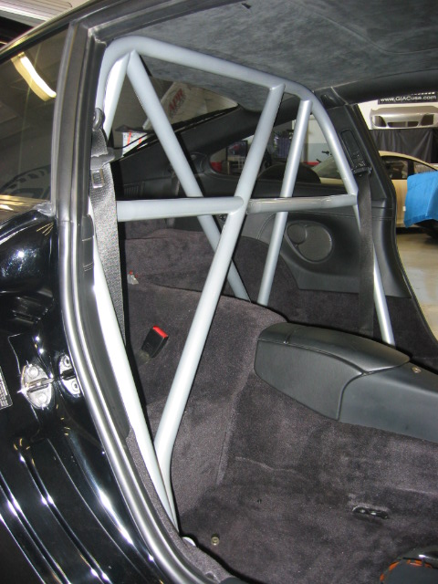

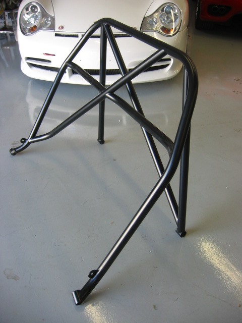

Some of you wanted some specific information on the GMG GT Cup Harness- Roll Bar.
The T-equipment roll bar design is not bad- actually pretty good and functional in a roll over situation.. Building on that our bar is an evolution of that design.
That being said.. Here are some of the key features of our bar-
*4130 ChromeMoly tubing that is tig welded- all welds are normalized for added strength and rigidity.
*Available for Sunroof equipped 996 C2-c4 and 996TT cars and Non Sunroof Equipped cars GT2 and GT3.
*Additonal cross brace in rear - for added stiffness and support
*Provision for harness clip - in kit ( no need to drill holes on the floor)
* Bolts in like the factory T Equipment bar-
*Our bar is designed to work with the reclining seats both standard and sport- As many of you know if you are 5,9 and over and have installed the T-equipment bar you cant move seat back far enough to get the proper leg room you need. Our bar solves this by allowing you the full travel of the seat base.
*GMG GT Cup harness/roll bar will obviously work with ALL fixed back seats including the Euro GT3 "elephant ear" style seats many of you have.
*Standard finish is satin black or bavarian silver powder coat-
*Optional colors are available to match your car...
** We also do complete roll cages for street or track - in house.
If you have any more questions please feel free to email me directly. Hope that answers some questions...........

Satin Black finish-
