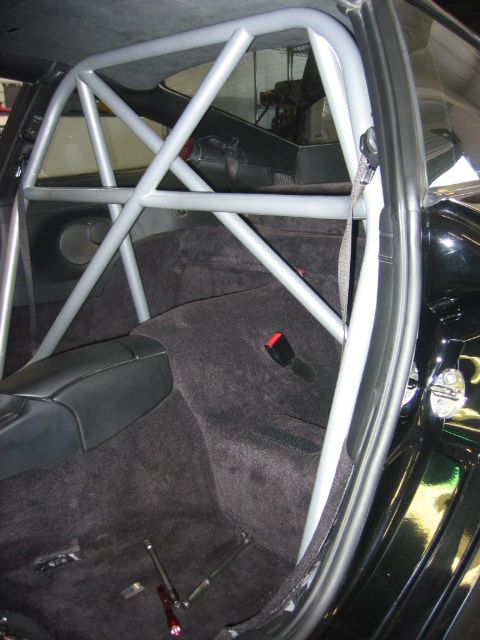

Pic of powdercoated bar...

Yes now Chuck's is a PRIME example of how nice it looks powdercoated!
