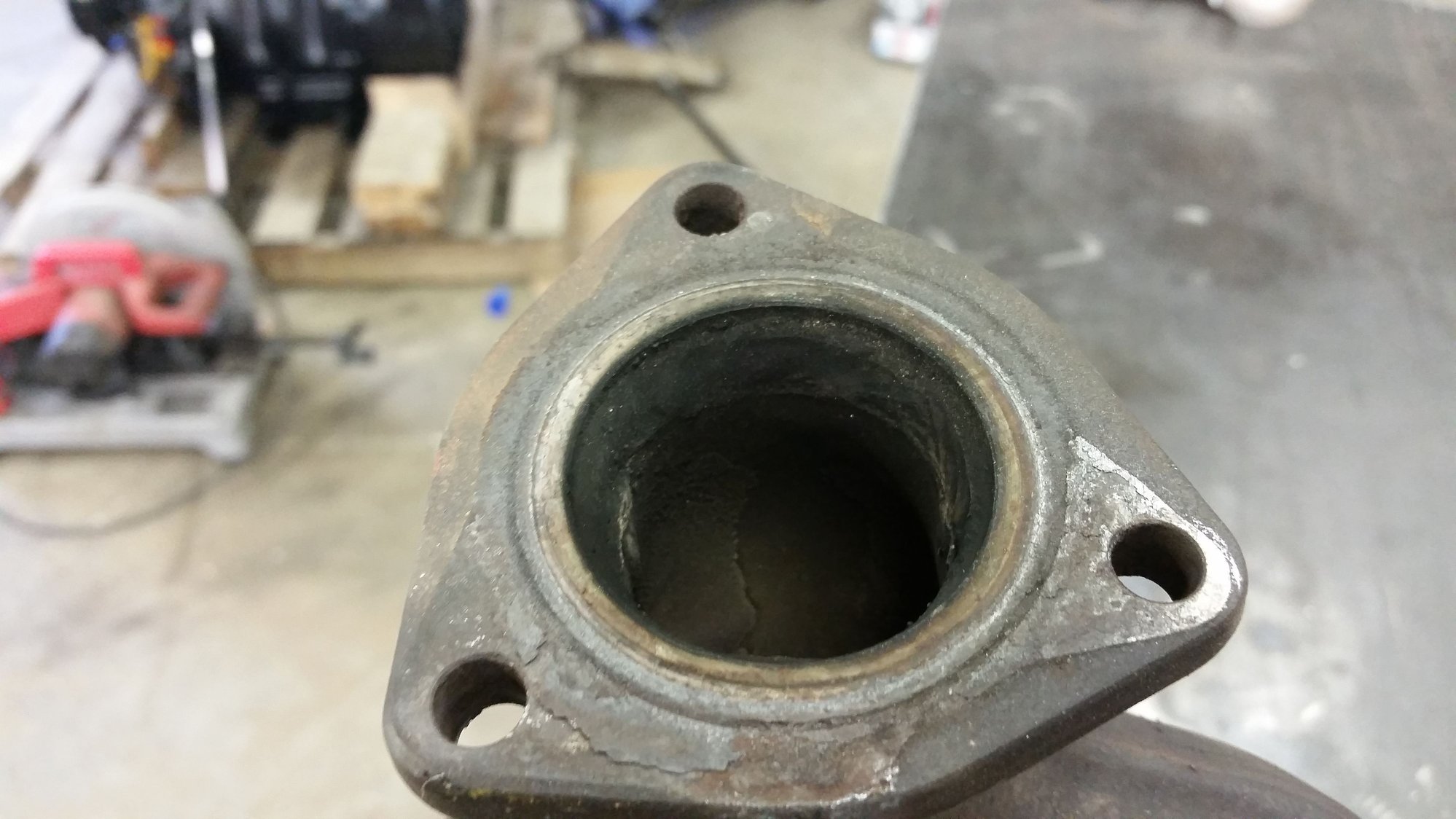

Well since I'm sitting here idle because the power went out for some odd reason I guess I'll post up what I did last night.

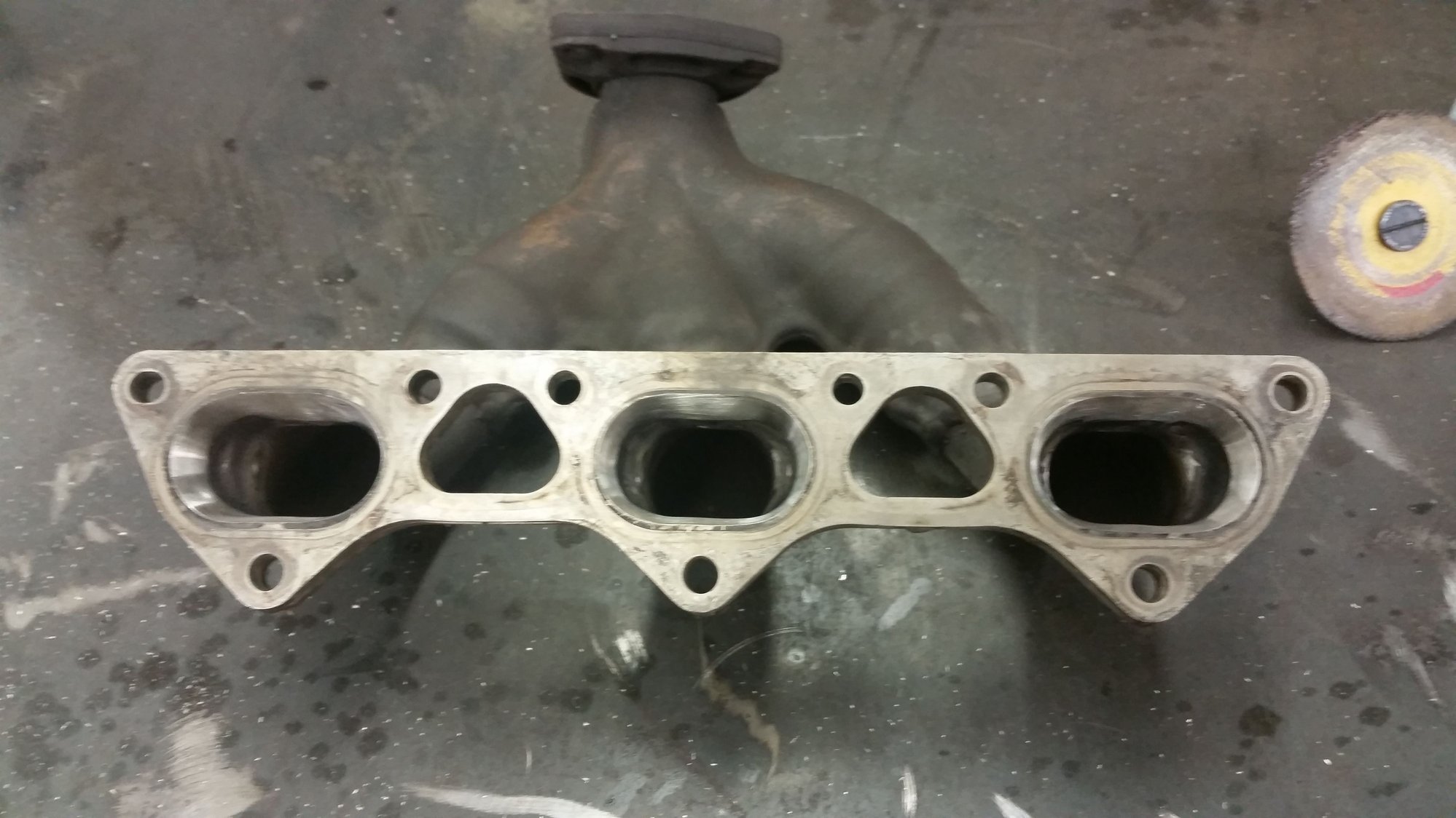

Got the manifolds off and ported. Should help spool and up top power a bit. My front canards came in the mail yesterday as well and I need to get them mounted as well as my rennline front vent mesh covers to keep rocks and leafs out.
Wrapped the headers with titanium wrap as I usually do. These ones are hard to do a nice job on. Used extra stainless zip ties. Looks kinda ugly but function over form for me usually.

I ported mine too a few years back. There is a lot of material there to remove. I bet you gain a good 10-15% extra area. As far as the header wrap, I'm not sure how much it really does if anything on these headers as they are very short and double walled which effectively acts as a fantastic insulator. That is why none of the aftermarket headers can really hold a candle to the OEM Boysens in my opinion.

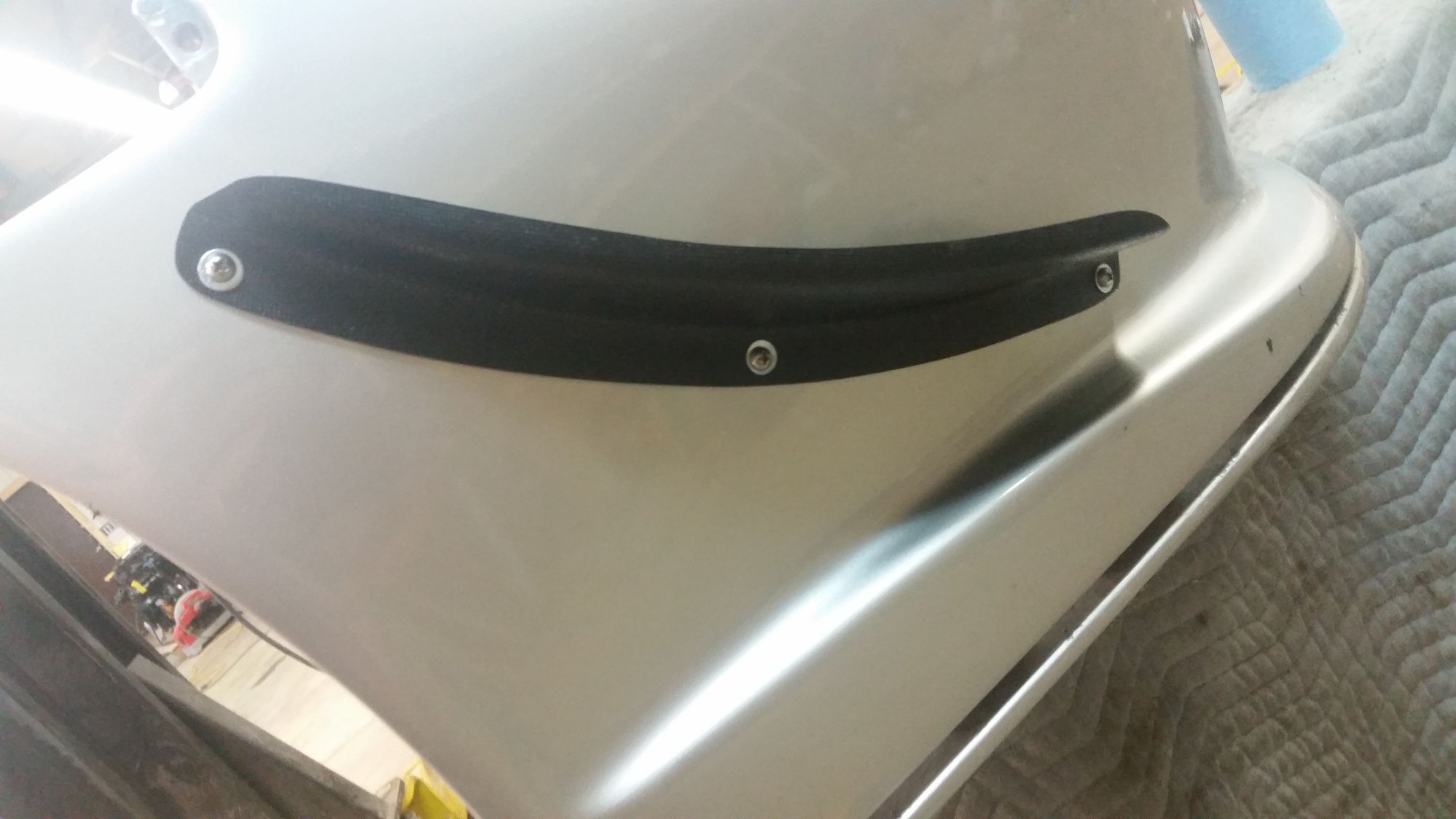

Joe's dive planes are nice. I have these on my bumper. Attach each one with 3 small black button head allen bolts going into small T-nuts installed on the back on the bumper. I put double sided 3M tape on the dive planes and then bolted them down. They are going nowhere...
Ya it's a large gain. I port everything I can. I do lots of turbos, manifold, and head porting for local guys.

Mounting the dive planes I think I'm going to take a bit different approach from most. Was going to make a backing plate and double side tape that to the inside of the bumper and then use tape and 3 or 4 screws to hold it on. Then if I want to go to something like a half mile event, I can take them off in 5 min to reduce drag at high speeds.

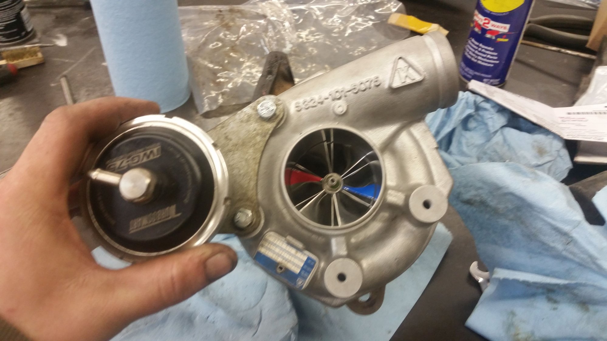

O just finished assembling one of my k20/billet 20g turbos as well and about to bolt it on. Then I need to assemble the other and hopefully get it on tonight as well.

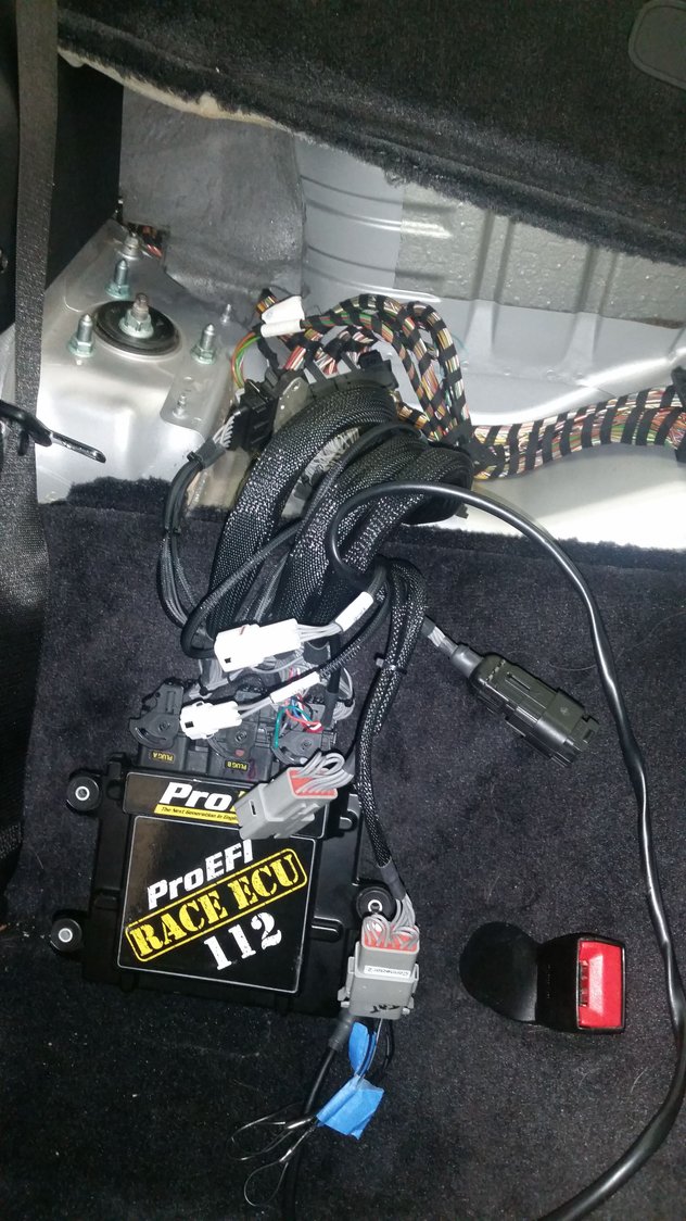

Got the engine 95% finished up besides the clutch.Turbos on, sensors in the motor installed and wires ran. Got the proefi in the car but have to figure out how to fit it all back where the stock ecu was. Got the canards mounted with backing plates so I can take them off easily if I'm at something like a 1/2 mile event. Clutch slave is on.

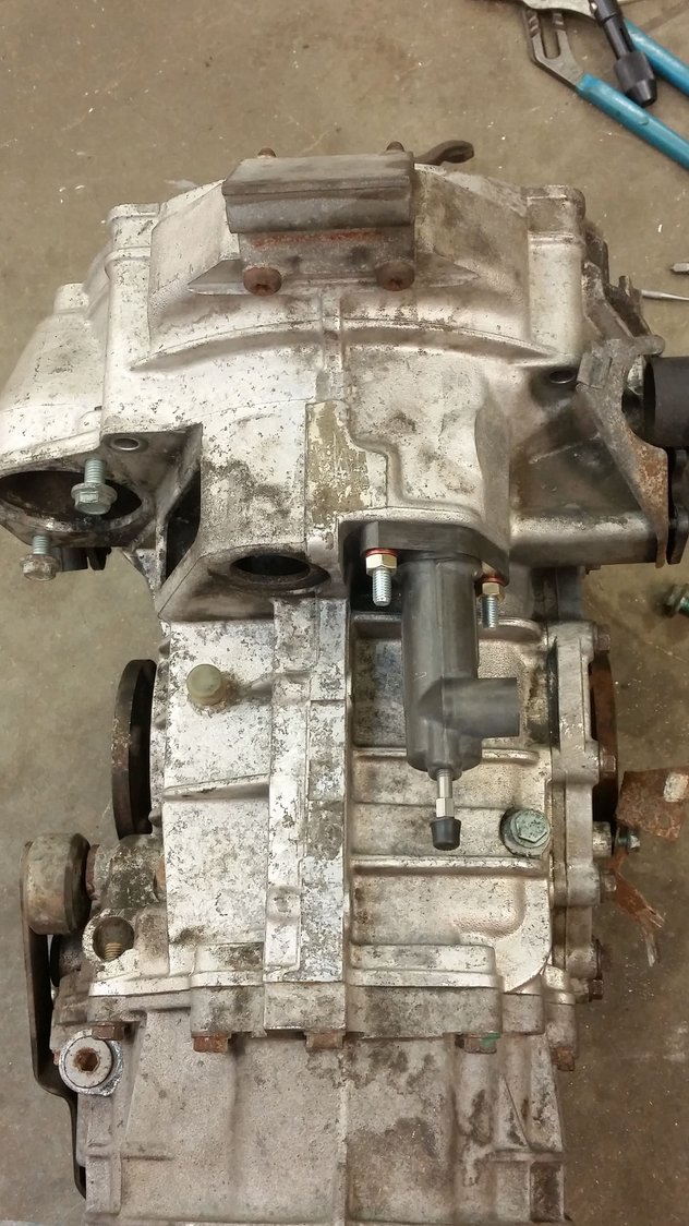

Biggest thing that pissed me off was trying to put the clutch on. You need shorter bolts and a different pilot bearing and it doesn't come with them. You'd think a 4200 dollar clutch would come with that stuff. So going to have to try and get those tomorrow.
Old Apr 18, 2016 | 02:17 AM
  #57
32krazy!'s Avatar
Joined: Dec 2008
Posts: 5,551
From: tn
Rep Power: 628
did you clearance the inside of the bellhousing? it needs just a small trim. install the clutch fork and work it back and forth. you will see what needs to be done
