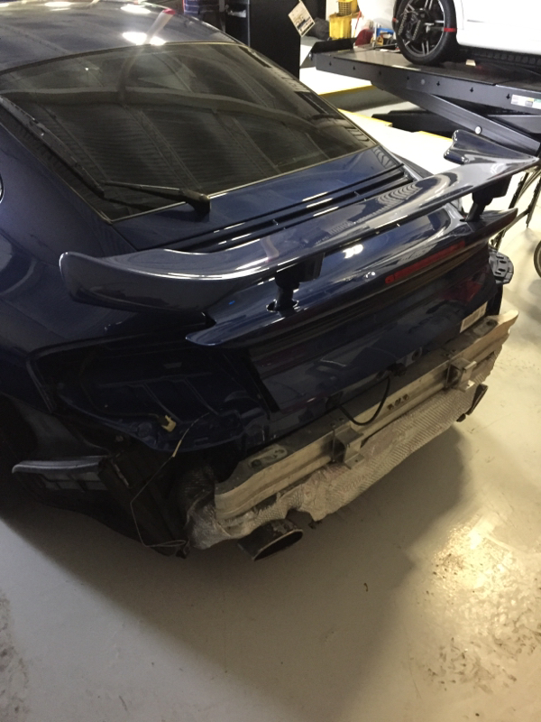

I also got the rear hydraulics rebuilt including the pistons in the drive unit. All three parts were leaking. All seals were replaced with Viton seals for prolonged life. Unit was refilled with fresh oil and reinstalled. I'll take a pic of the rear wing also.

Here is pic of rear wing from ruf
