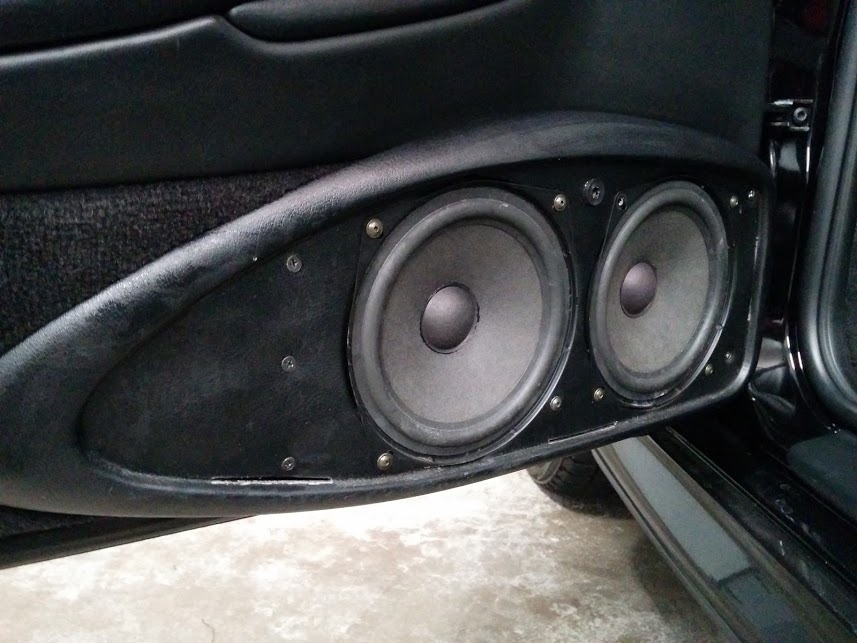

Take a picture of your door speakers, you may have the same speaker system as I do.

Hey Steve, we meet again!
Here is a pic without the grill.

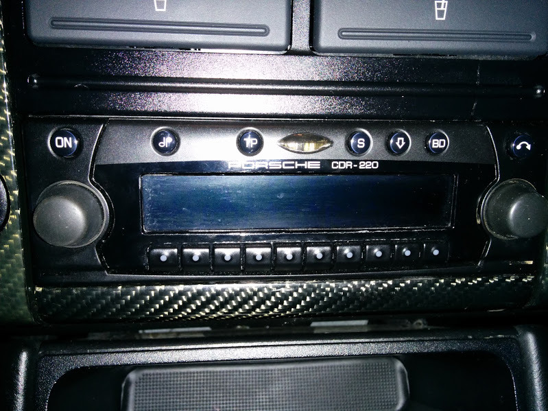

not a stock system at all.....check the EQ settings on the deck
Bass is all the way up, still nothing.
You sure about it not being stock? I recall the options code referencing something about the stereo in the car. I will need to look it up. Also the speaker grills have a Porsche emblem in them (one of coarse is missing and I can't find a replacement).

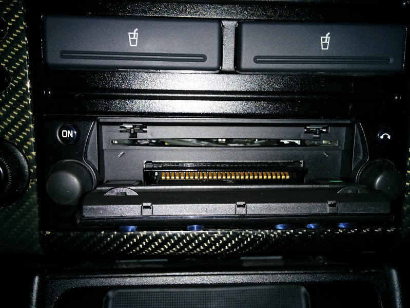

#1 thing here, Porsche has never done a flip-face deck...double speakers, etc etc what do your door panels look like? stock below...
What are the gains set on the amp?

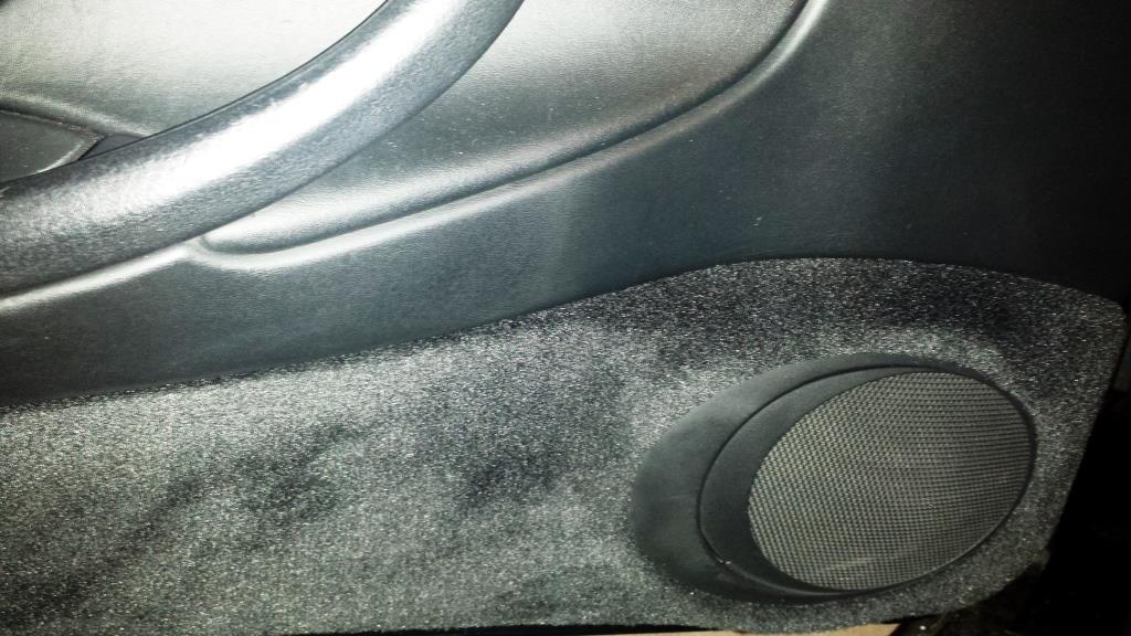

Like I said, I'm having a very hard time finding a second 996tt with the same stereo but it does look like stock.
Radio has Porsche on it and so do the extra large speaker grills... o really wish I had the single speaker doors btw.

I have some GT2/3 non-speaker door panels for sale if you really want to simplify, lol
Definitely a stock deck, not an aftermarket 'flip-face' deck...
Have never seen those door-panels/grills before and don't remember an option for that, imagine they're custom...but maybe VIN/codes could reveal something...

you stock radio with aftermarket door speakers. bose has dash a single bass in the door and a rear fill speaker wth rear mounted bass. mids and tweets in the dash

your going to have replace the door panels or reglass them for single bass in the doors. i have polk audio and jl audio in the dash and behind the seats. i use a kicker self powered bass in the rear

All of your speakers and amplifier are sold by a company in Germany (I have the same system). They are after market speaker inclosures and all the speakers (even behind the stock speaker grills are updated). The system uses a factory Porsche amp, but it's not the one that came in our cars.
I believe the speaker enclosures are a big plus, but I don't think the amp is powerful enough. I've been wanting to a new amp and a small sub behind the back seats, but that's a project for another day.
