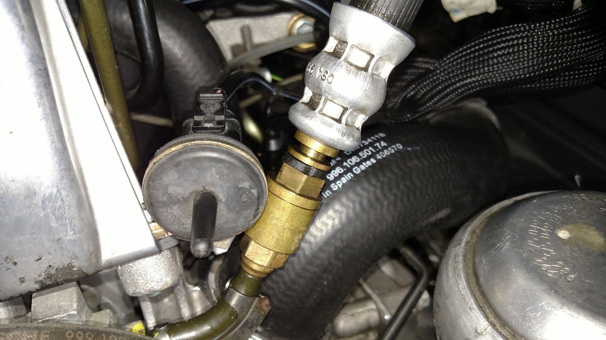

Hydraulic Pump high pressure line clip
I have a small clip that I can't recall or find instructions on where it goes. I was dropping the motor when coming across this part randomly.
It's a small C clip, about 1/2" in diameter.
The ends have a little fork, and one side looks to have had one end broken off.

Maybe the one that holds the MAF wiring to the intake.

+1 just a clip. Look for it missing on the MAF wire or throttle or any of the small looms. No biggie, better than having some bolts left over

Found it!
Sorry the original picture didn't give much scale. But it's much smaller than the loom holder clips.
It's a spacer on the high pressure line coming out of the hydraulic pump. Couldn't find any reference to it in the manual

Hrmm..doesn't look like I can edit the thread title to help for future posterity.
Question about this fitting - I took it apart by unscrewing the parts of the barrel. Is this a quick release fitting in some way instead of unscrewing the barrel?
