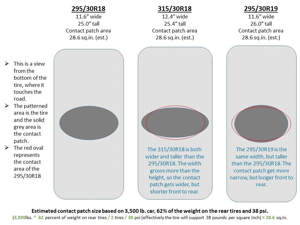

Let me try to clarify. The contact patch area is determined by the weight on the tire and the air pressure in the tire. The shape of the contact patch is determined more by the size of the tire.
The wider the tire, the wider the contact patch, but as the contact patch gets wider, is gets shorter front to rear. A taller tire will give you a longer contact patch front to rear, but the contact patch will get more narrow side to side.
A longer contact patch is better for straight line traction and a wider contact patch is better for cornering traction.
This all assumes you are being reasonable. If you stick a 165 on a 3,500 car, the sidewalls will now be supporting the weight instead of the contact patch and the basic assumptions are out the window.
Hopefully this visual will help.
Later, Steve

Steve,
That's a great visual! Nice that you created that to help understand the concepts.
Given the same width tire, a taller tire will tend to elongate the contact patch front to rear. This is a better way to gain accel/decel traction then adding width!
While of course, taking advantage of width in any diameter tire, add corning ability.
It's probably too deep for the purposes of this tread. Contact patches can be very dynamic for the various loading possibilities on the tire. So while the visual is great to understand a static situation, one has to extrapolate beyond that. For example, a higher hp car, with stickier rubber, and more aero, can certainly create much more load on the tire to take advantage of - bigger donuts.

Yes, the visual is very basic. It's simply a starting point, that everything else builds on.
At the end of the day, tire compound/construction is king. I would take a set of 225 width "R" compounds over a set of 295 width all season tires any day for the track.
