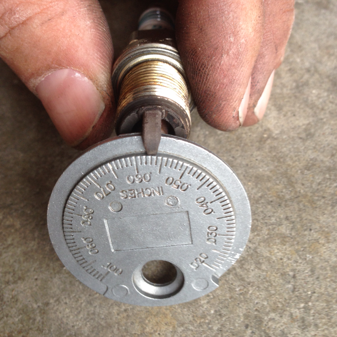

I'm not sure, I should have taken more pictures, here's the only one I took. You can't see the electrode but you can see how much it's gapped.

Originally Posted by Jeanmarcboilard
It was probably around 6 years but only 8k miles that those plugs were in my car before I purchased it. When I changed them because of misfiring, the iridium electrode had worn down to a tip and were all gapped at 0.06 from wearing down. I'm certain you have more experience modding then I do but that's my personal experience with them.
Regardless of miles, 6 years seems like a long time to not change plugs.

I've never heard of or seen an electrode simply widen. Iridium is extremely hard which is why it's used, it gets used in plugs for cars who's change interval is 100k miles as a result. At that interval the threads seem to come out with the plugs... the material is very brittle though so gapping plugs that use it requires care. The spark jumps best from a sharp edge which is why the electrode is so thin on Iridium plugs. This exposes more of the tip too so it's not shrouded and has better chance of igniting the mixture cleanly.
I've fouled Iridium plugs to the point the motor barely ran (2jz) and once the fueling issue was cleared drove them clean pretty quickly. Pulling them later I couldn't tell they had ever been fouled and continued running them for many miles after. Copper conducts better for sure but the edges wear round more quickly and the gap will open faster. My last set of copper plugs lasted a good while, so far my current set has done well at higher power but they've not been in long. If they last I'll keep using them but as big a hassle as changing plugs can be I'll try Iridium if they have to come out soon to see if they work as well or me in this car.
