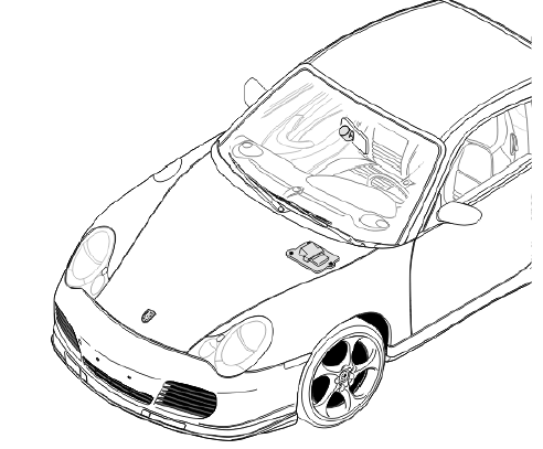

Where is control unit for rain sensor located?
Hi,
Anyone knows where it is loctated? It is a 2001 Turbo.
Thanks

I believe it's under the cover to the right of the battery (drivers side). Are you having problems?

bsh,
I though this picture would be helpful for you to find the control unit.
