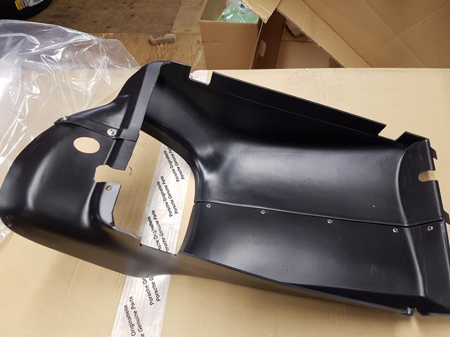

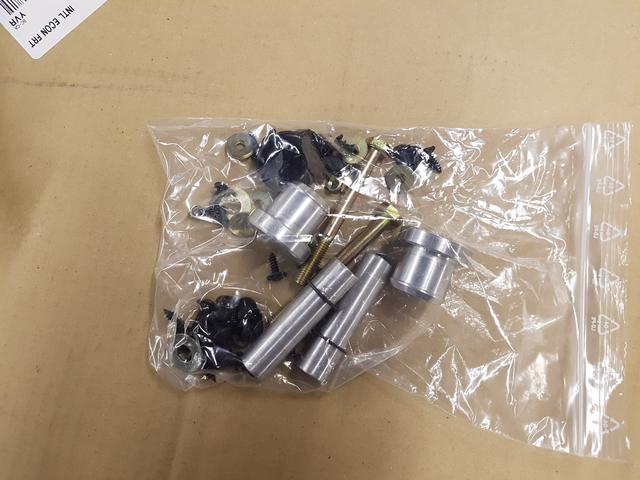

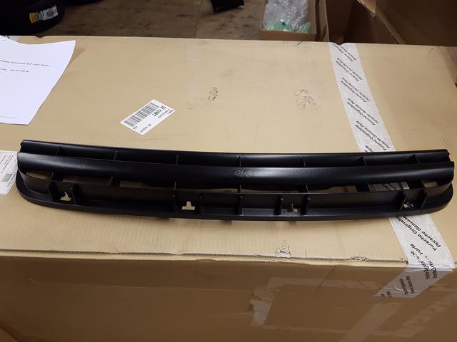

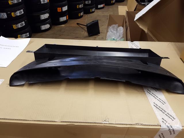

The timing was excellent as the last box I was checking in was one of the bumper kits.
I pulled everything out and photographed all the stuff.
Almost all the bracketery and hoses are Porsche items. The ductings is RUF designed. As are obviously the bumper itself, the upper outlet, and the lower valance.

A couple items are lefts & rights, and I only included the photo of one.
Let me know if anyone has any questions about this or anything else RUF related
