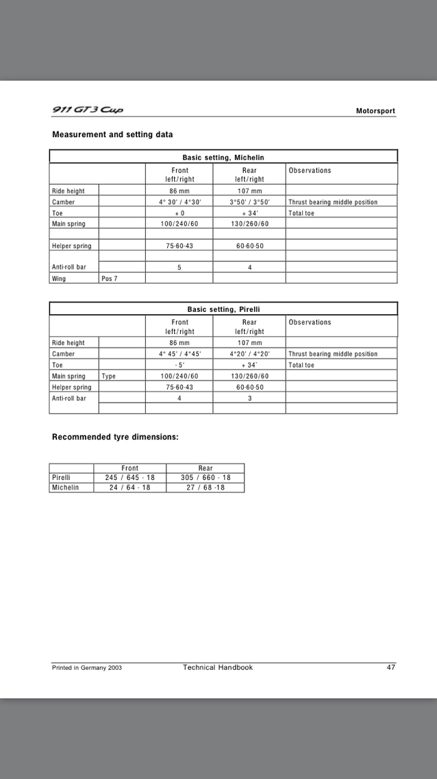

Why that much toe? With a stiff enough suspension and monoball rear arms and solid pucks, toe and camber change in corners should be less than a stock setup, no? Seems like the rules we state about alignments often don't take into account suspension and control arms. So we fix some of the negative suspension attributes in the rear with monoball and removing rubber and still align like we need to combat those very things. Maybe I am missing something you guys can help me understand?
Here is what the 996 Cups call for as a reference. They have different weight distribution, but tire widths are pretty similar.
Wondered that as well, but all the research said keep it to around .25 a corner. Seems to be working.

.25 what?? I'm assuming you are listing degrees. Factory specification is not listed in degrees but rather in minutes, specifically 15-17 minutes (') per side or 30-34' total. 1 degree = 60 minutes. Thus, on the low end, factory specification is 0.50 degrees total rear toe (or 30') and 0.57 degrees (34') on the high end.
There is a general lack of understanding between the two and this tends to muddy the water a bit. When I do an alignment on my car which is full monoball, I always set up the rear to a total toe of 34' (0.57 degrees). Tire wear is dead on perfect.
