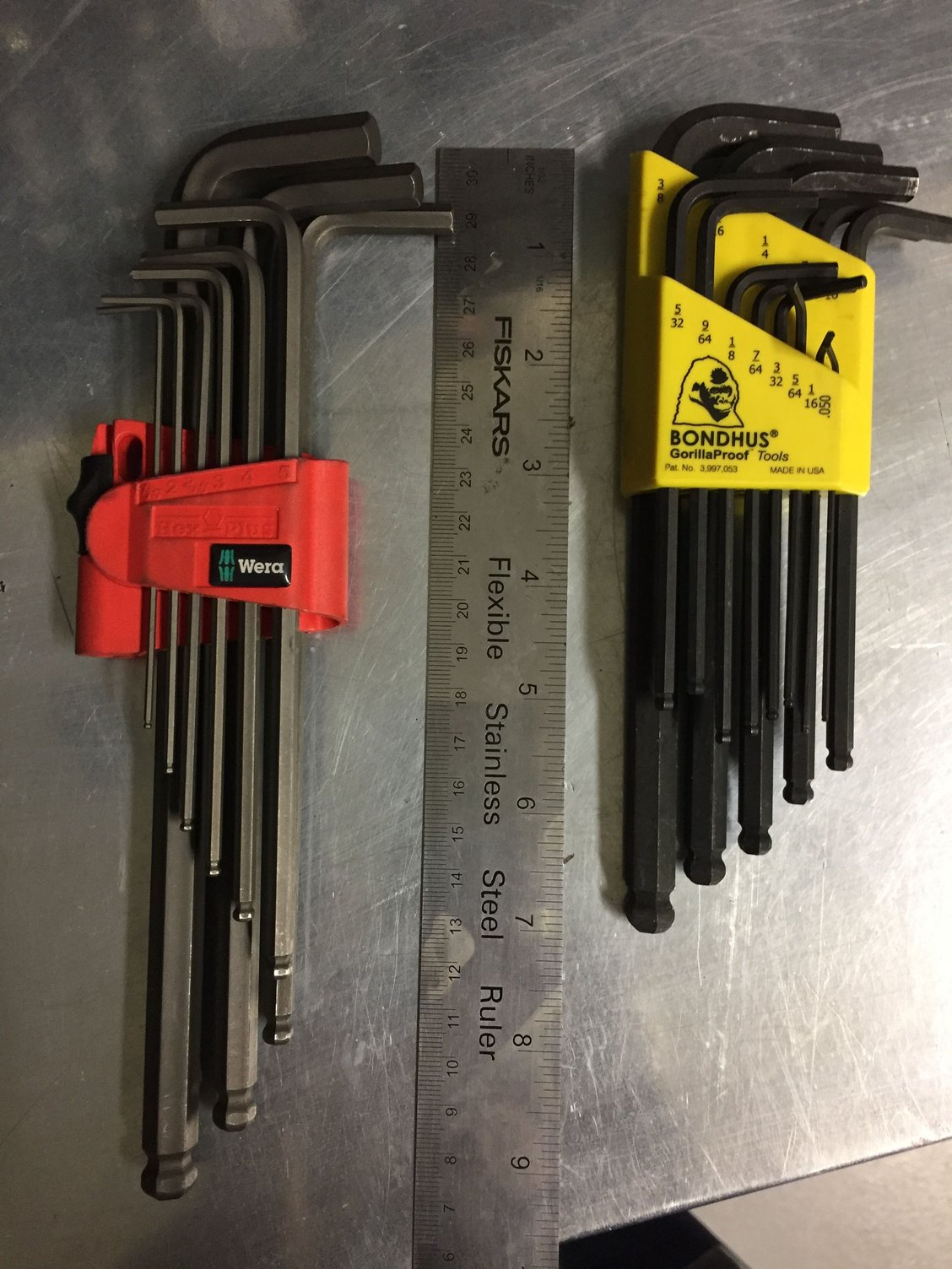

Requires a long T handle allen key doesn't it? I really need to do this on my car.
You sure do need an extra long Allen key! I found these on Griot's after trying every local tool vendor. Wera brand. Regular "long" set shown for comparison. The Wera one is just long enough.

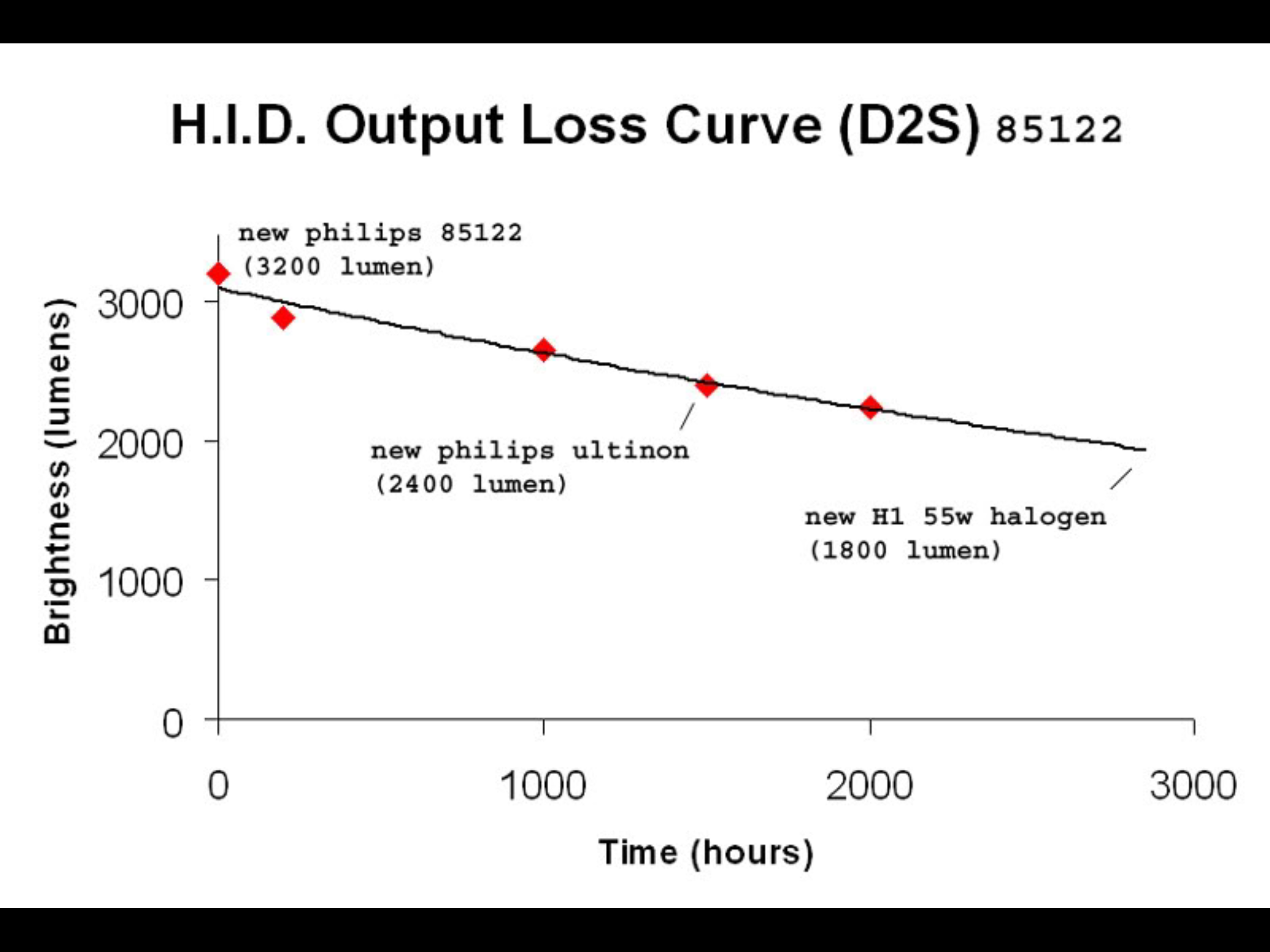

Just came across this. Wondering if it's true?
Yes. They output less light and colorshift as they age.
0 hours = 3200 lumens (100%)
200 hours = 2880 lumens (90%)
1000 hours = 2560 lumens (80%)
1500 hours = 2400 lumens (75%)
2000 hours = 2240 lumens (70%)
Hm. In Slovenia where I live daylight lights are compulsory, so I must have 10,000 hours of usage on my bulbs. Ha ha ha.
I think time to be scientific about it so, I will change the bulbs and report back real-world findings.
Any idea what bulbs to get? OEM or something else? Ive been told that the aftermarkets don't last as long. True? Anyone knows the best type?
