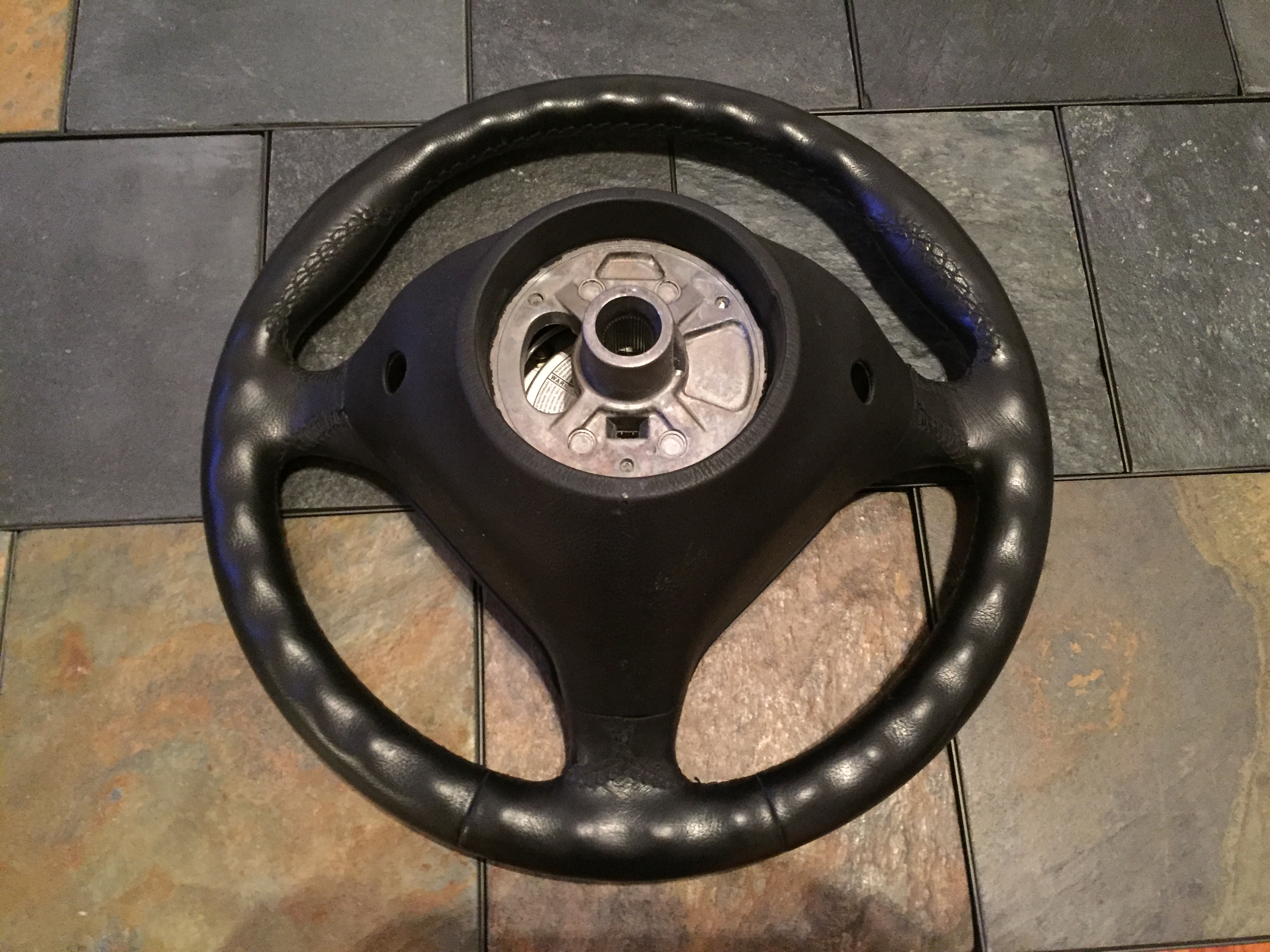

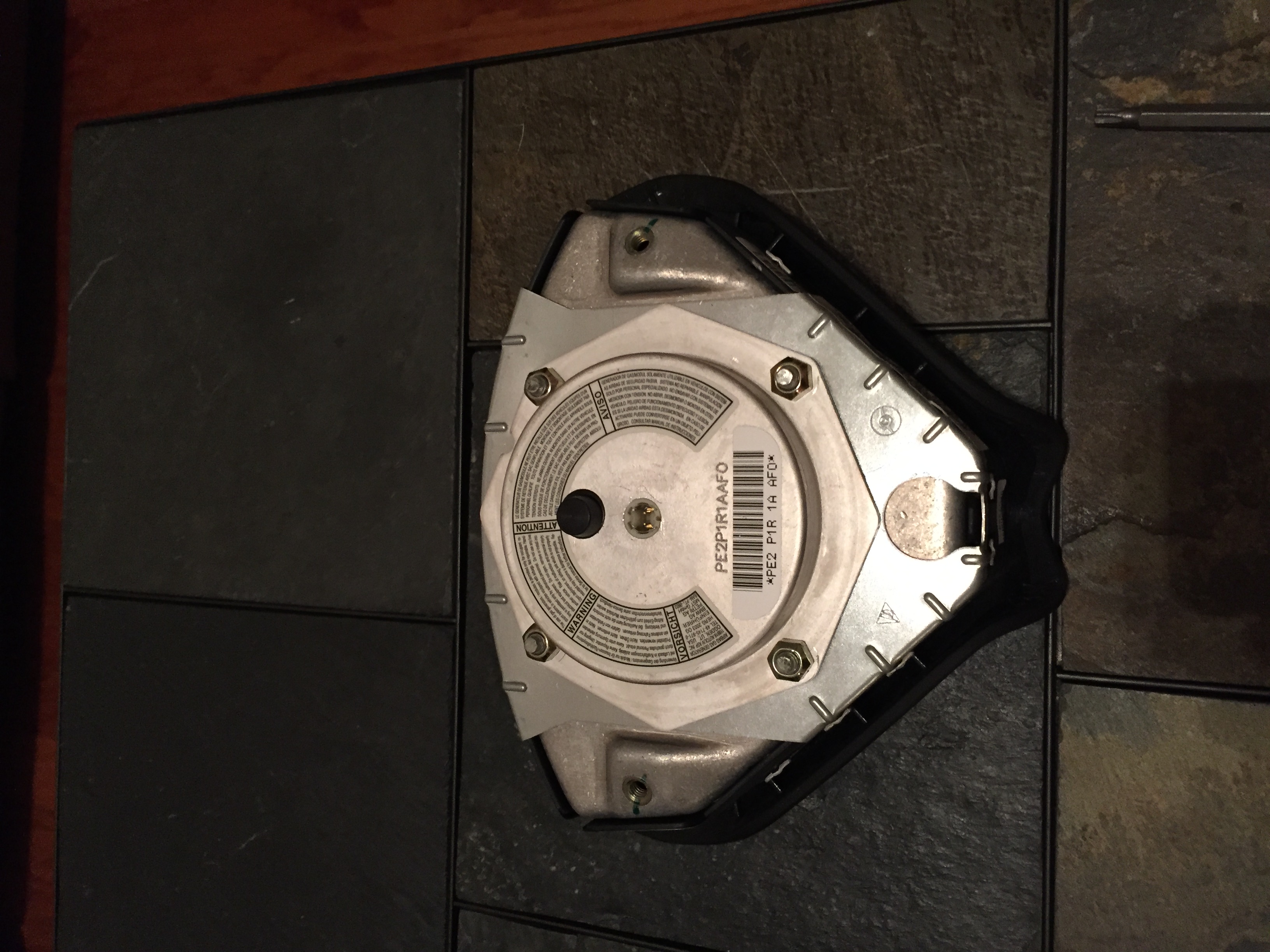

2 torx bits benhind the wheel. disconnect the battery for a good 20 minutes to discharge any juice. turn the wheel so the torx are at the bottom and remove them remoive the bag and theres a plug at the back. remove it thats about it

Yup, like 32krazy said...easy peasy..take your time and do it calmly. Position the steering wheel perfectly straight before you pop it off so that you can pop it back on straight as well. I think there is a "996 steering wheel removal" video on YouTube in case you want to have a look.

thank you very much guys...meant to say im changing the entire wheel out to a D shaped wheel.
