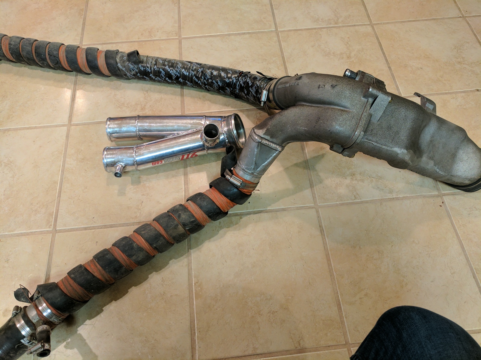

This is what I used on my last setup, $250 for this stuff. The tubes are racecar canvas stuff, very strong. I put conduit and pvc tape around it to prevent rubbing. It worked well. The tubes aren't very smooth inside, the grey ones are much better. It is a bit heavy, Markski's part is feather weight compared to mine though, I am glad I got it for 400.
Right. Your replacing 32lbs for 5lbs. it's not all about the "vacuum" as some tend to say. It's about the functionality and ease of installation without need to drop the motor like with hard pipes ( I make them too ) but I don't like them.
As I mentioned, to fabricate that aluminum intake takes time and money. I tried various hoses years ago and ended up with this this. It's 2.5" ID , pretty smooth, and bends well. Haven't had any issues due to heat. Take a knife it will rip but the purpose is to install it once and move on.

I had the soft steel spiral reinforced tubing on my car for 40K miles and 12 years. Looked a little rough on the outside but was still fully functional. I switched to the 1/4" thick hard plastic 2.75" ID tubing. It's bullet proof but requires an engine drop for the install. Even with that it's a pain to install and get the alignment perfect but it's well worth it in my opinion. If your engine is coming out I'd do the hard tubing if not the soft tubing is well proven..

The blue grey tubing is tough an it is the smoothest inside. After installing Markski's parts I've come full circle. I think it is worth it. It fits perfectly and the weight savings are significant. Really nice setup.
