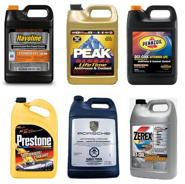

If I totally drain and flush my system can I run whatever coolant I want?

No!!! only Porsche pink coolant.

I think you can run any compatible coolant you want, but not ANY coolant you want.
VW/Audi g13 is under $25 for a gallon on Amazon, with Prime shipping. I don't think you can theoretically save much going with cheaper no name stuff anyways. Porsche coolant is more like $50 a gallon, and allegedly the exact same stuff... so it's kind of silly to pay for the fancier black jug that you are just going to chuck in recycling anyways.

Why can't I run dexcool or whatever. Bad on the seals?

as c32 says, its mixing "types" that is ill advised as the PH #'s and ingredients of one coolant over another might be different. but any of these WILL work. as long as it's an "OAT Type" then theoretically, it's all going to be usable.
but most stay with the AUDI/VW g13 ( cheaper ) rather than the PORSCHE brand even though it's the same pink stuff all of which is purported to be made by Pentosin.
the rule to follow is keeping a good ph balance of 50/50 mix of distilled and silicate free OAT type "lifetime" coolant.
