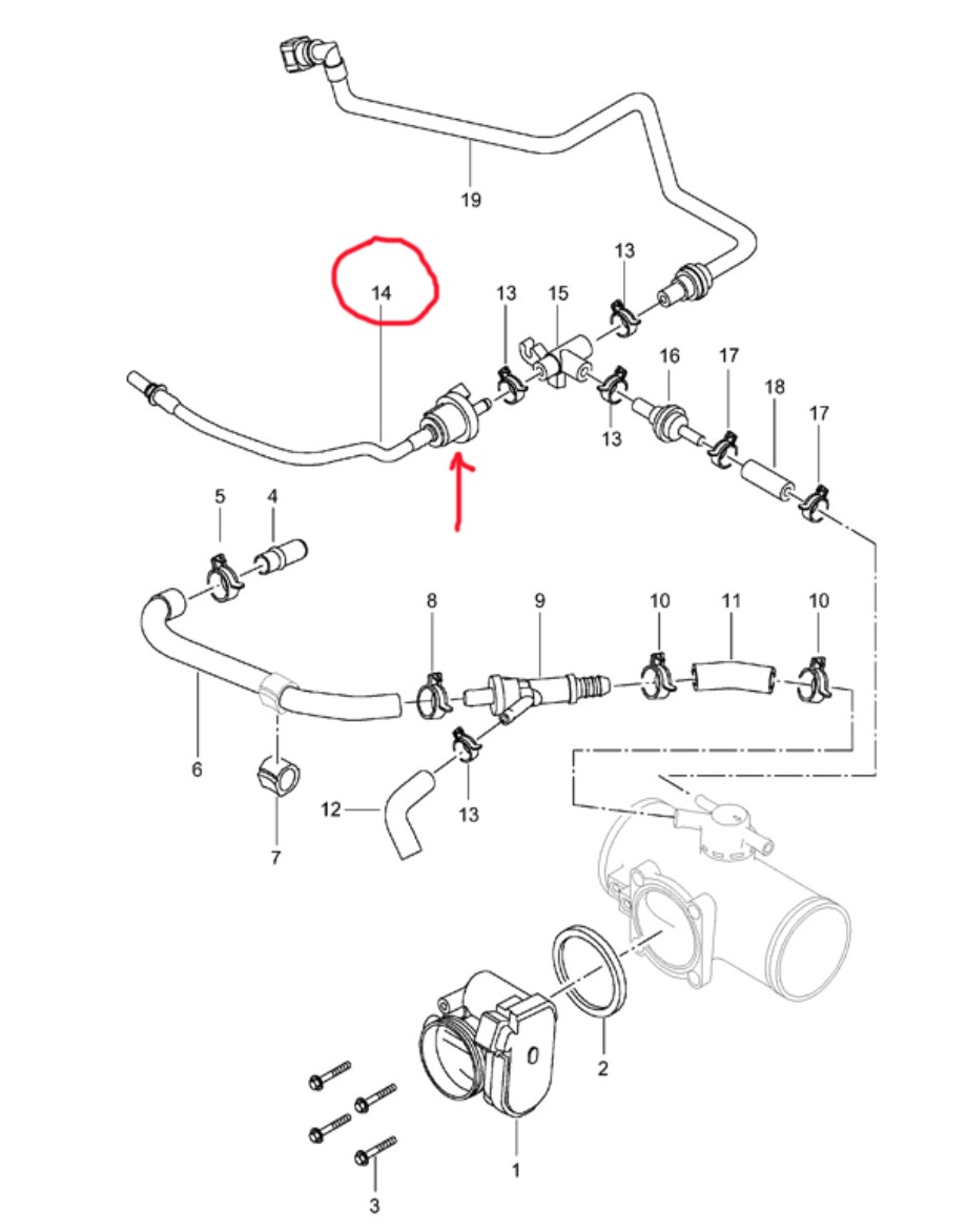

So it looks like it's the valve that is peeking out behind the vacuum check valve (with the zip tied rubber cap) in the pic below of the top of my engine. Must be it as it has a plastic pipe going to it.
Yes it is in this area. Lowering the engine will help you a lot to reach it and see if the plug came off or a wire is damage......

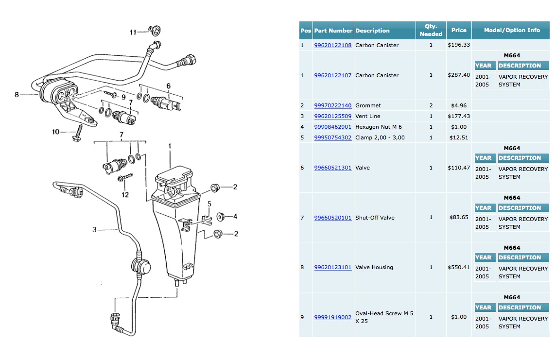

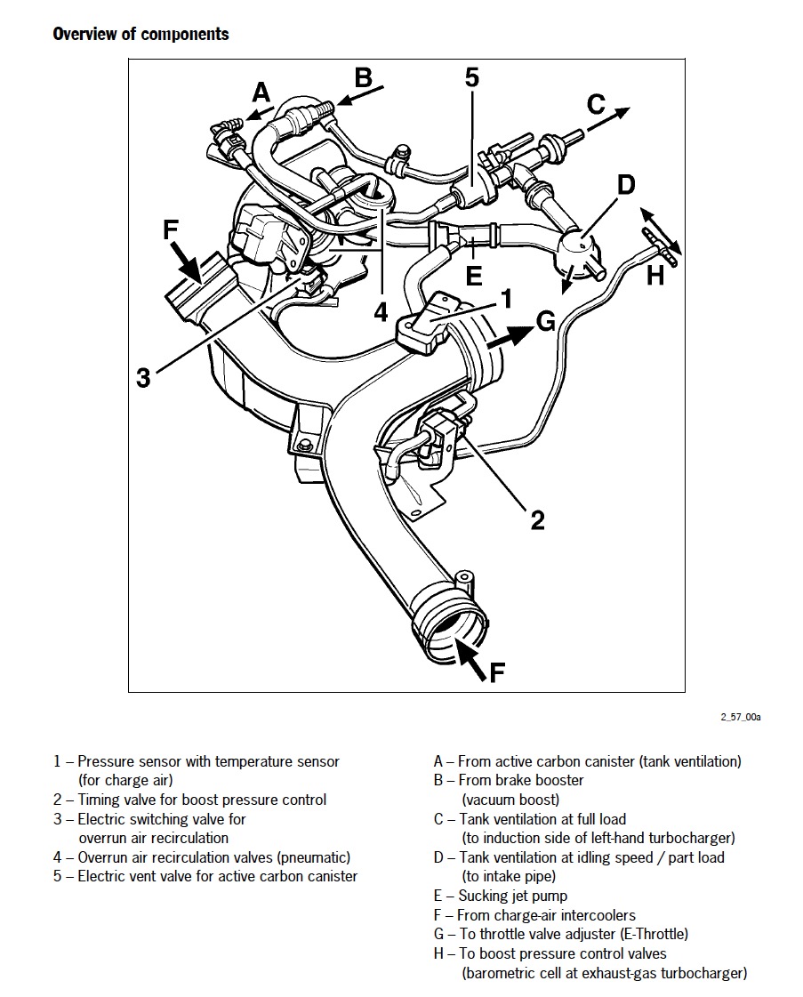

John. I was just reading about this valve and looks like they incorporate a filter within this housing. May be you should look at it in case it is plugged.... Item#5:

Thank you JP. Great info. Where did you dig up the info about the filter in the housing? Very interesting. I just looked it up in PET and the number for the valve (which includes the plastic pipe) is 996.110.129.73. If I need to change it out it should not be too difficult to access if the engine is lowered a couple of inches. That will be a must. You can see it clearly on my car where the plastic pipe (with the clear tubing) is routed just to the left of the oil filter housing and above and aft of the diverter valve visible.

My PET is out of date and I cannot see this part# but did some research and it look good!!!
The pipe alone is 996-110-129-72, Atlantaauto parts cat does not show the part# for the valve .... Strange....

The plastic vent line that is attached to the valve is part of the valve JP. The most recent number in PET has been updated to -73.

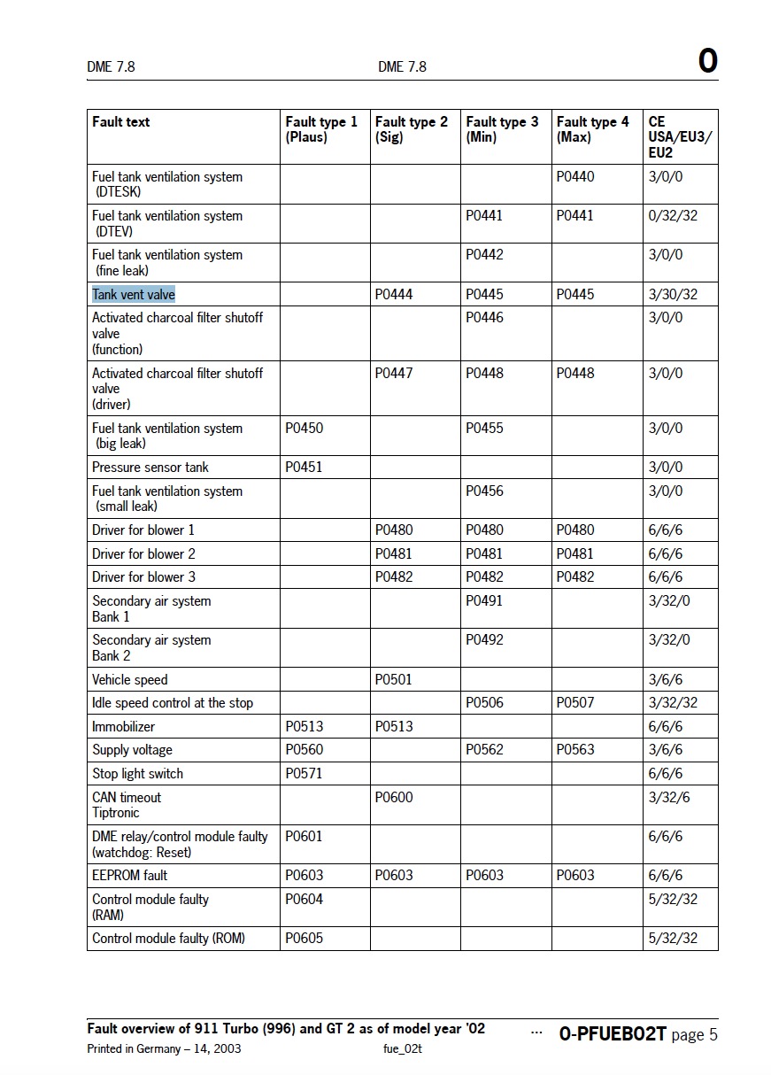

While looking at your other question about the #16 check valve I end up in the OBDII manual and I was looking at the fault P0444. The first picture you post of your Durametric mention tank vent valve which as to be the one near the engine intake mention in my previous post. But looking at the OBDII manual they mention the canister purge valve is at fault if you got the P0444 fault???? See Wross answer post#5.... In that case the canister purge valve is in the right wheel well.... Item#6...Why this discrepancy???? We cannot blame Durametric because in another section of the OBDII manual fault P0444 is related to the tank vent valve (see diagram) ....
I know!!!! This is why I'm confused as to which valve is actually the EVAP purge valve. In other words, which valve is the maintenance manual referring to regarding P0444. Look at the P0444 PDF I attached in post #11 JP. Which "purge valve" is that referring to? I was set on #14 on the engine but now I'm starting to lean to #6 now as per your post above. Ugh...
**In post #7 Macster is referring to valve #6 but it's a different #6 than the one you are pointing to.

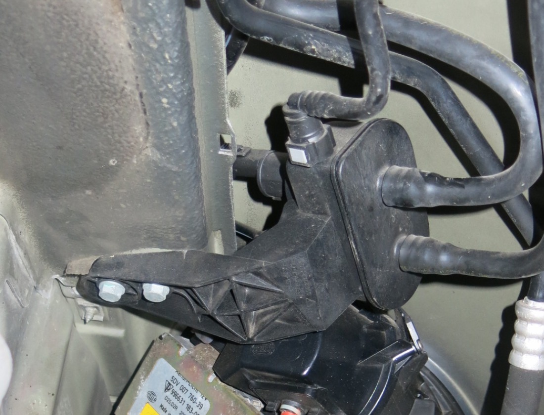

Quick update JP. I removed the valve housing behind the passenger headlight and took out both valves #6 (tank vent) and #7 (shutoff). Interestingly, #6 is the valve that you hear click when you push on the metal flapper in the filler neck. This valve is connected to a tube that terminates right behind the forward part of the filler door behind the door hinge. Fresh ambient air can gets drawn into the EVAP system this way. #6 is the valve that the dealer pointed me to as being the one mentioned in the P0444 PDF. When I tested it however, it appears to be working fine as it clicks and opens when the filler in the neck is deflected. When I measured the resistance of the valve, it measured just under 18 Ohms. According to the P0444 PDF, it should be 26 +/-4 ohms. If this IS ACTUALLY the valve in question in the P0444 PDF, the resistance is low. That's a big if however. The other valve #7 measures at 26 Ohms. Hmmm.
I'm still a little skeptical as to the #6 being the correct valve. I have both #6 and #7 ordered and will have them to replace next Friday. In my gut, I'm still thinking that #14 at the engine is the problem. JP, what exactly in the OBDII manual lead you to believe that #6 is the correct valve as you stated above?

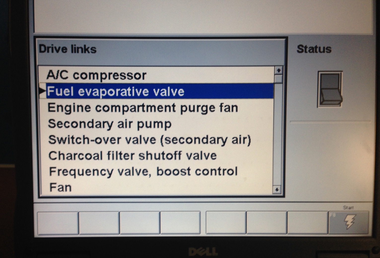

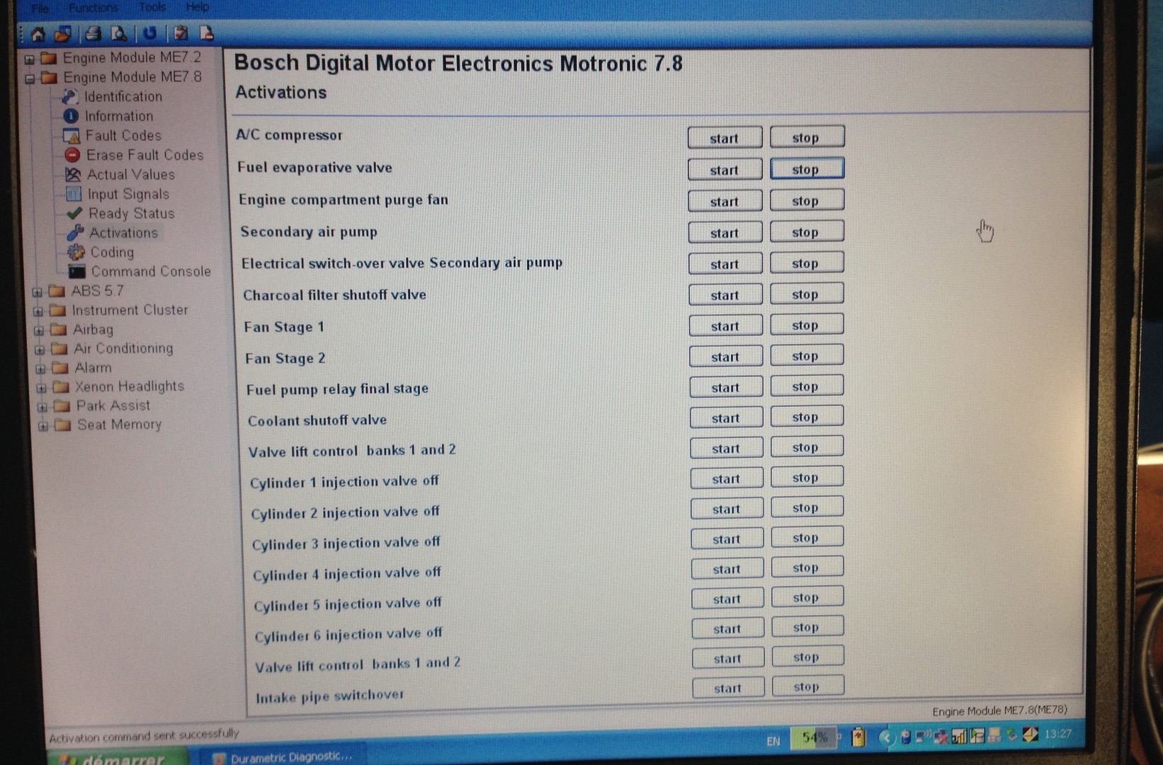

Update!!!! First my car is a 2002. I went and hook up the PST2 and after the Durametric to them OBDII port. Got the DME menu and went to "drive link" and select fuel evaporative valve. I heard a click and it was from the engine compartment the valve # 14!!!! I put a long screwdriver on it and it is coming from this valve. The funny thing with the PST2 the valve click on and off continuously and on the Durametric it click only once when the switch is depressed.... Hope you will try this

Thanks JP! I believe that finally settles it. I indeed have a faulty #14 valve, hopefully not the wiring. When I tried to cycle it with durametric, nothing happened when I pressed "start" on the "fuel evaporative valve". It showed as "signal sent successfully" at the bottom of the screen but no click, nothing. Everything else on the activation menu I tried worked. When I selected "start" on the "charcoal shutoff valve", I could hear continuous clicking and verified that it was indeed valve #7. I was easy to see it working a I had both #6 and 7 plugged in and hanging outside of their housing. Everything I selected on the durametric menu would run or click continuously until "stop" was selected.
