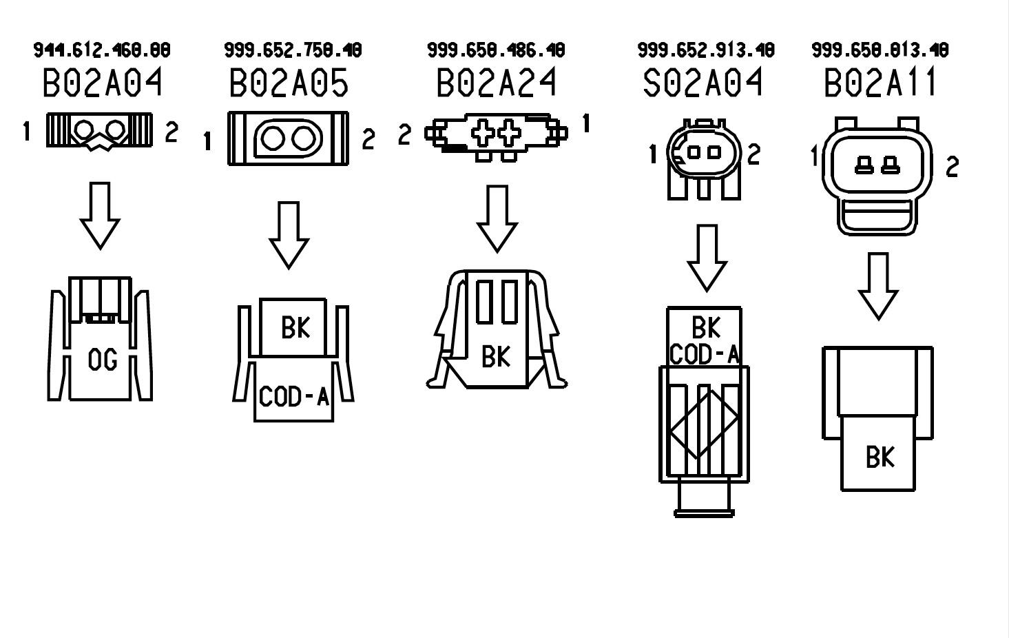

Well, mystery solved JP. The problem apparently is not the valve by the engine but the simple fact that the wiring was somehow severed right at the connector. It's really bizarre how this could have happened especially considering the simple fact that BOTH wires are broken cleanly off. It's in an area of the engine that is not accessible (unless you partially drop the engine) where someone could have tugged on it by accident. I could think that vibration may have caused it but for both to be broken off is simply weird. Makes no sense whatsoever...
Looks like I'm just going to fix the wiring and call it a day..

Anyone know the trick to disassembling the connector before I start experimenting? I'm sure the Germans have a clever way to release it somehow..

Ouch this is in fact the cause of your fault. Difficult to say what happen there.... I don't have experience with that type of plugs and don't know if they can be dismantle to swage new wires. In the wiring diagrams page 25 you got all the plugs and these are the two wires plugs.... The last one is close but not exactly the same.....

Bosch makes a direct replacement to the factory connectors which are used all over the engine on all the emission stuff and also on the injectors. They come with dust boots and the required pins. You just need to have the correct crimping tool. Size 22-18 is what is used.
[url=https://flic.kr/p/TJDanJ]
