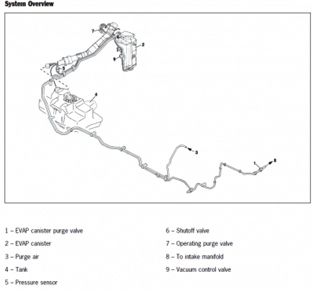

Under the right front fender attached to the fuel filler tube I think. Here's a diagram. Part # 6.

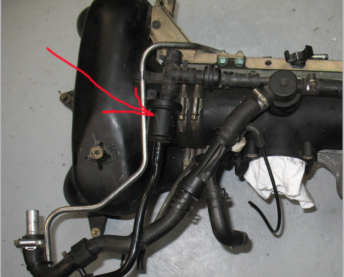

Hum... According to Loren drawing on this thread, (996) https://www.renntech.org/forums/topi...evap-canister/it is in the engine compartment and on top of the engine.....

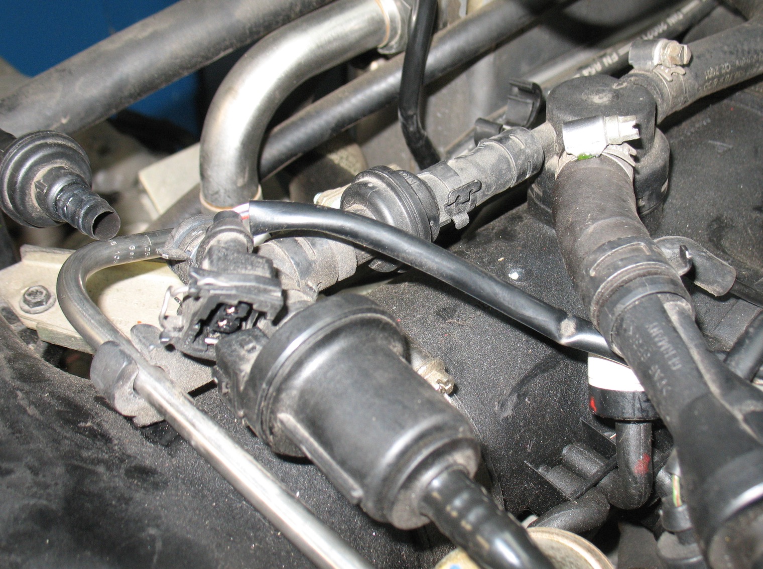

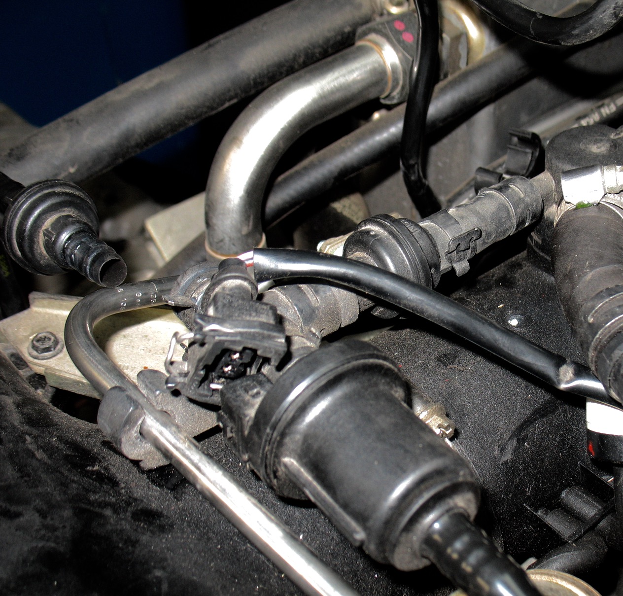

I think I got it!
That's not it. #6 at the fuel filler tube is the fuel tank vent valve. This is the valve that opens when you push the metal flapper valve open at the fuel filler neck. You can hear a click when the valve opens. The function of this valve to allow fuel vapors to be directed to the EVAP (charcoal) canister during fueling. These vapors are then diverted though the evap purge valve into the intake to be burned by the engine when running. When the #6 valve fails is when you can not fill the fuel tank with gas as the pump will keep shutting off due to the build up of vapors.

Originally Posted by jpflip
I think I got it!
That's bizarre JP. That looks like a check valve to me. The evap purge valve will have wiring going to it and a connector on it. How else would you trouble shoot the pins at the connector according to the maintenance manual in the link attache below.

It does, look at my other picture:
And a look at the wiring diagram shows a violet and red/blue wire...called vent valve....
You are the man my friend. Thank you!! That has to be it then. Reps to you!
So it looks like it's the valve that is peeking out behind the vacuum check valve (with the zip tied rubber cap) in the pic below of the top of my engine. Must be it as it has a plastic pipe going to it.
