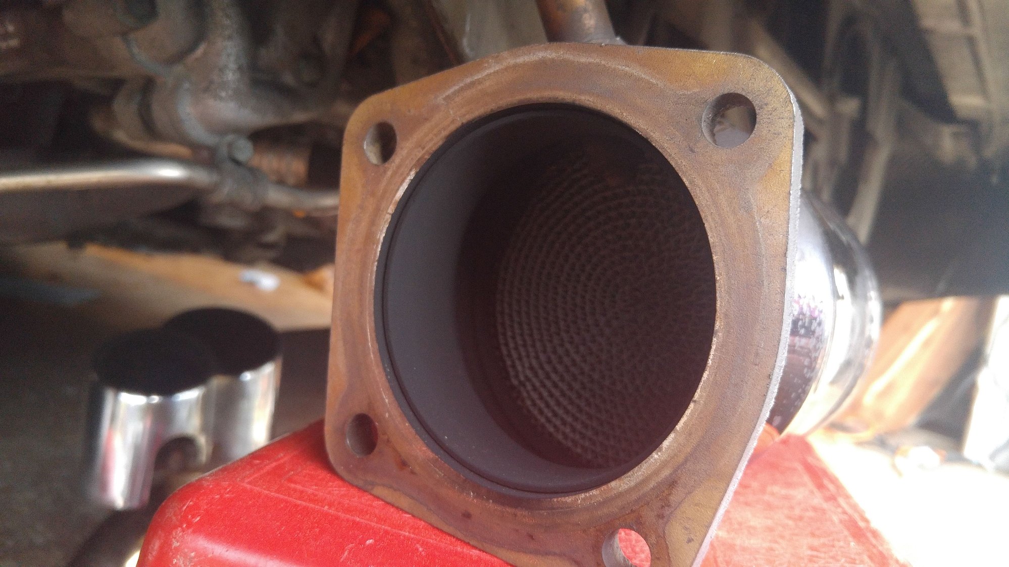

I'm replacing my exhaust and have a question about the gasket between the turbo and cat. The only thing that was on my car when I removed the modified oe exhaust was a ring that fits in a groove in the turbo housing.
Used fabspeed
Modified oe
Looking at the oe and used fabspeed flanges, there appears to be the outline of a different gasket. When I was looking up the part, I found the ring for the 996 and I found a gasket that's listed for 997 that appears to fit the same stud pattern. I have a set of the rings coming in soon but am I missing a gasket as well?
Thanks

That's all you need there. Technically you should replace it every time. However i just had mine off twice in the last month and re-used the old seal rings both times and and no leakage that i can tell. The issue is if it leaks it can allow O2 back in to the exhaust and fool the O2 senor into thinking you are running lean.

When I tried reusing them, it started running poorly after it warmed up. Now it's stalling and won't idle. I'm getting a p1508 code. Hope that it's just a leaky connection.

I removed bumper and intercoolers to get better access to the top studs/nuts. Nothing was difficult to remove. Put everything back together and ran into driveability issues so I took the new exhaust back off. This time, I didn't remove the bumper/intercoolers and it was pretty easy, especially with the muffler section coming off separately from the cats as they are connected via vband.

Gaskets came in today. There was a .42mm difference in thickness between the old and new ones. I identified the real problem while I was under there. The boost hose blew off of the turbo. Doh! I am about to post a comparison video between my gutted oe exhaust and fabspeed gen1 in a new thread.
Thanks for the help!
