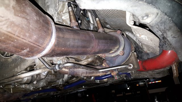

I am catless John but have my CEL tuned out...so not much help but whatever
