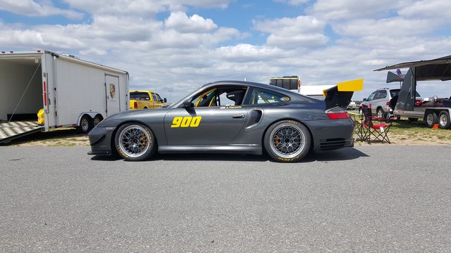

and pic for reference - just know that pirellis sizing is small I tried the 325's on a 13 inch wheel and it looked like I belonged in a stance magazine
Car looks great Joe!
Thanks John!
