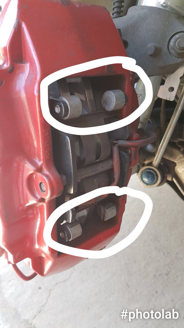

Yes the rears are smaller. Those weights circled in white are for anti vibration. The pads backing plates extend above and below them and latch in a groove in the caliper. If you put rear pads in the front calipers they are too short to latch at both top and bottom.

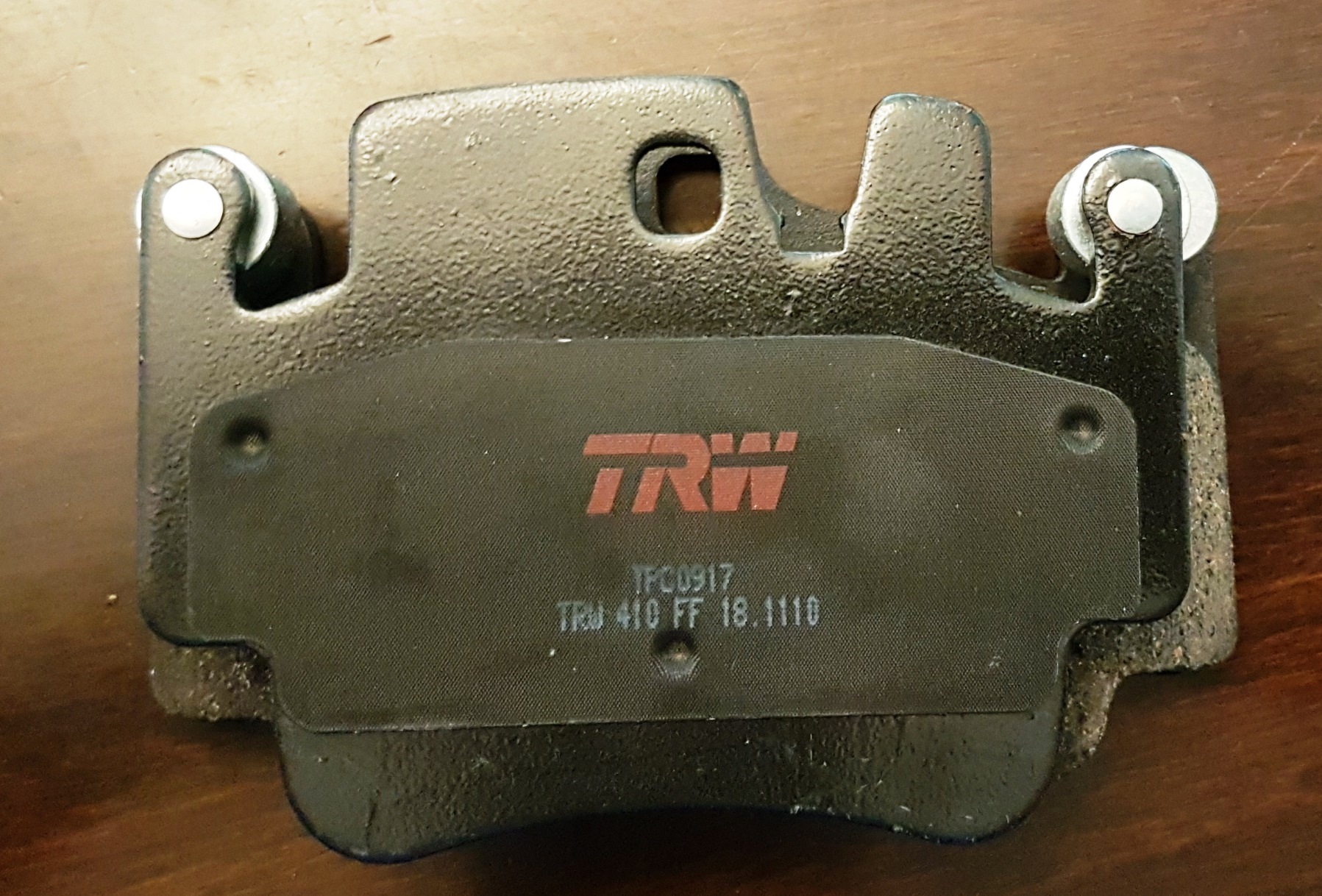

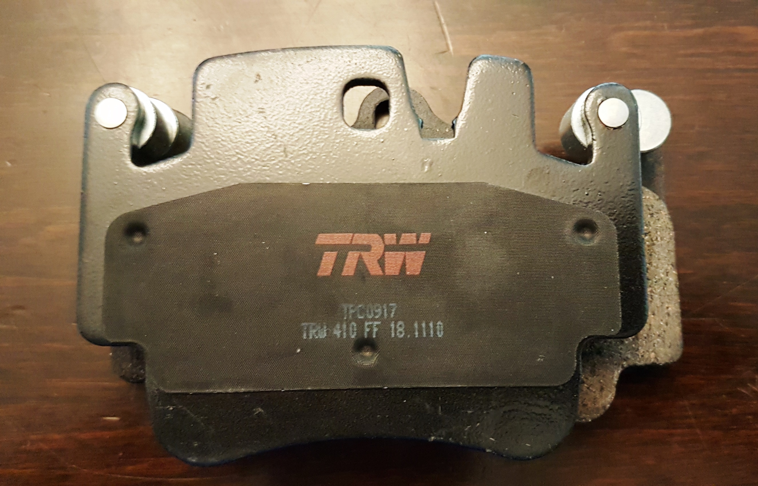

(steel/reds) front and rear pads are pretty similar in shape but slightly different in size... will post a pic in a minute..
Great to know. I have always been explained otherwise. But anti-vibration makes sense.

The fronts are 140 mm and rears are 121 mm.
