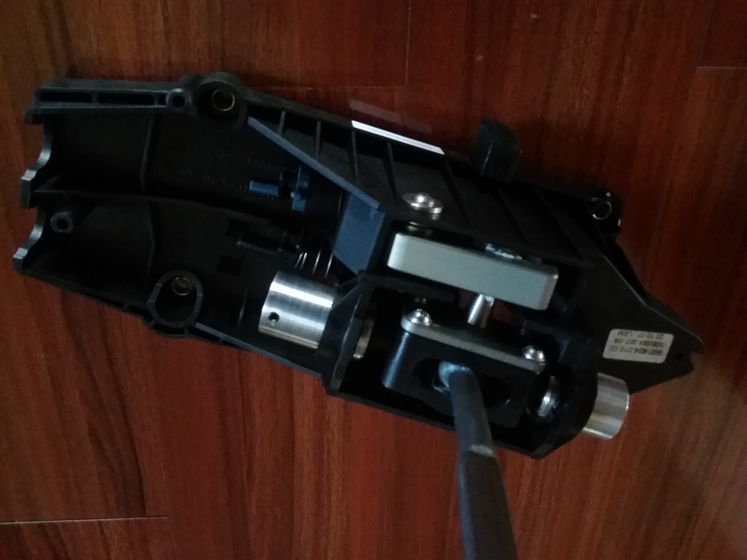

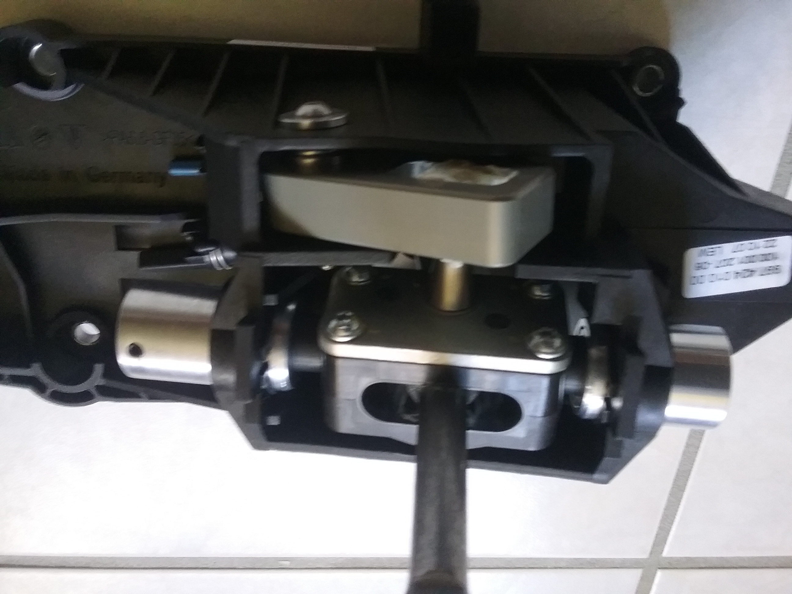

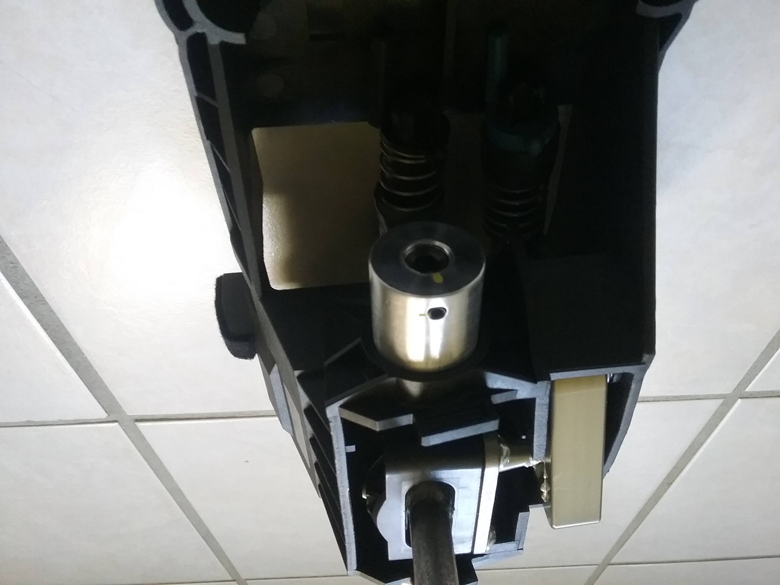

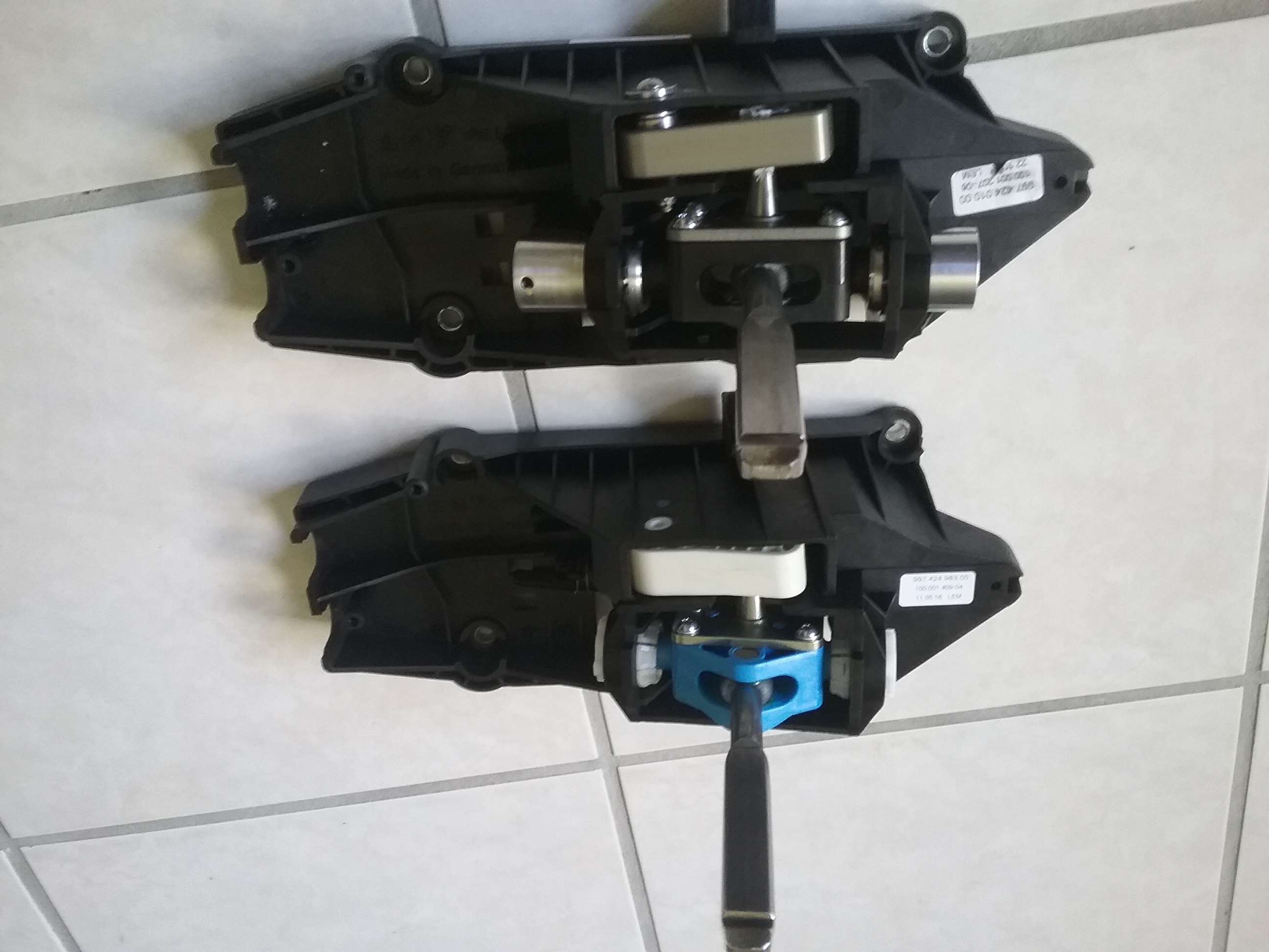

I have tried Numeric, SSK, 997 SSK and 997. I kept with the 997 with a Function First kit. Very impressive. Feels perfect.

Sorry.. pics upside down. So annoying.

No problem with the Porsche OEM shifters. I was after a tighter more precise shift with the correct throw for me. I settled on the standard 997. Shorter than 996, not as short as 997 ssk. Was thinking about 997 GT3, but decided to take it one step further with the Function First kit. It really is nicely done.
Tried the Numeric and it did have a very nice feel and looked like a work of art. But looking at it closely I saw deficiencies that I think would have affected longevity.

Also, the Function First is totally serviceable. Not that I think it would need it. Bearings are VERY meaty and sealed. Parts are readily available. I don't pay no mind to those who say the OEM plastic housing is junk. The plastic bearing housing... another story. That's where the kit comes in. I don't believe that the plastic housing deflects either. I put one in a vise and it took some beating. I think If you break the OEM housing from shifting than something other is seriously wrong.
Also, I have no ties to Function First or any other. It's just my opinion. I think if your after adjustability, the Numeric with Function First technology would make a real nice shifter. But it can't be done.
