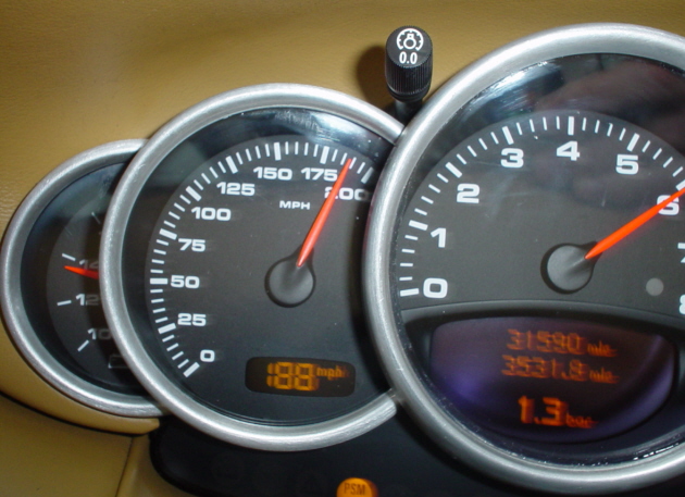

In order to get much above 190 MPH (certified time, not what the speedo shows) you have to remove the rev limiter, install a longer 6th gear and add some serious power. To show what can be done, a Sportec prepared 911 cabrio set a world speed record at Nardo and here is the info on that run:
In case you don't have your calculator handy, that converts to 227MPH!
The 580 HP strong Porsche Turbo Convertible with a long 6th gear by the Sportec manufacturer pulverised the former record and set a new benchmark for sporty convertibles. As a matter of course, all modifications obtainable from the Sportec manufacturer have a MOT approval - in Germany as well as in Switzerland.
