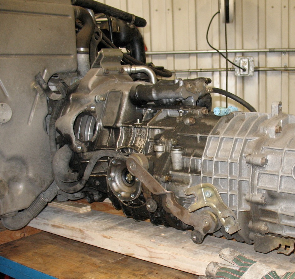

Seal #11 ? But it can come from higher up, hard to see on the picture.....It is not the slave because it is located on the other side.... Looks like it is coming from higher up on the second picture but difficult to see....

Looking at this picture of an engine on a bench the slave can be a possibility!

Many thanks! Yes, I couldn’t get a full view of above the axle to see if it was leaking from above. There was some fluid on the Gearbox casing above the axle, as shown in the second pic. Unsure if this is leaking down or residue from the axle seal leaking.

The mechanic had the car up on a lift and showed me some play in the gear selector mechanism. There was a drip of oil there, which I questioned if it was from the axle seal or slave cylinder. He stated it couldn’t be the slave as this will leak down the other side of the box. This is not always the case though, as seen in jpflip’s image above. He was adamant it was from the selector seal. Looking back at this my first image does suggest it could be from the selector seal. However, the oil leak is spread all across the gearbox around the axle, as seen in first pic, so im still wondering if it’s leaking from above in the location of the slave cylinder. Now confused as I don’t want to go through the expense of a gearbox removal as second gear is only slightly weak and just needs warming up.
