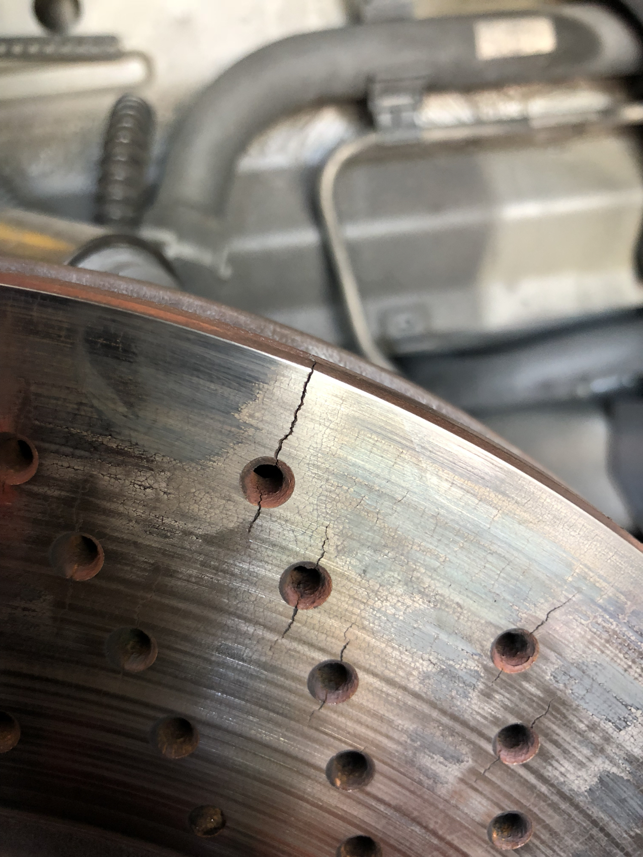

I know this has been covered a million times, but this thread would have helped me, so I'm writing it.
I upgraded to 997 rotors and bought some drilled rotors. Have PFC pads. My rotors are cracked and toasted after 4 days at Watkins Glen, and a few hundred miles on the street.
This time around I am buying slotted rotors and the gt3 front ducts (for $11) to try and keep them a bit cooler.
The rears look brand new still interestingly enough...

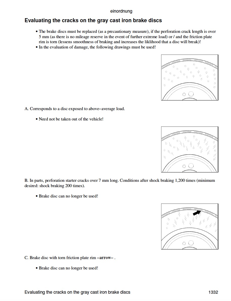

cracking is normal on the drilled rotors, they are safe to continue using until the cracks connect 2 of the holes is the typical guideline. sounds like 4 days at WG would do that

CrackedClick image for larger version

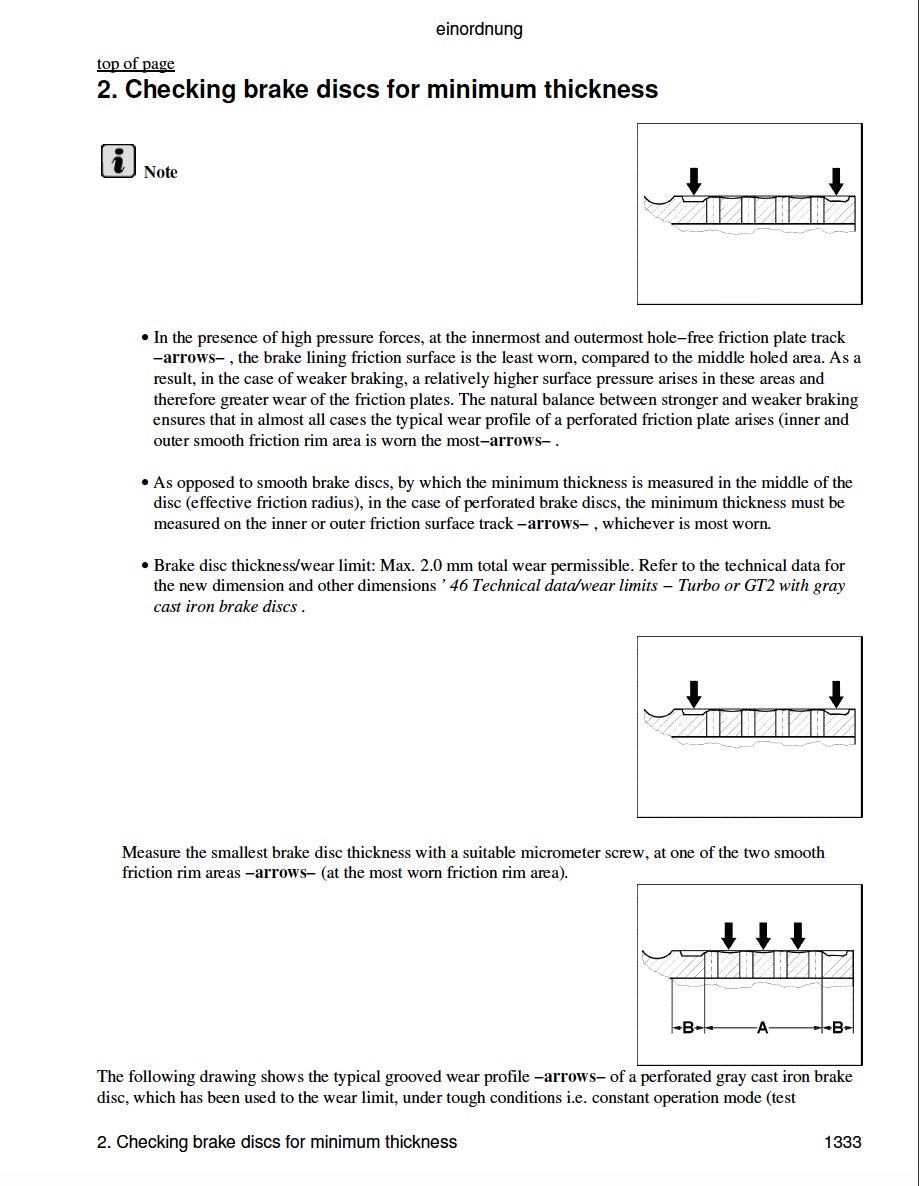

As per repair manual.....
