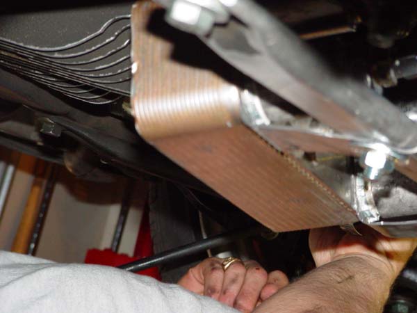

I found a couple of the pictures....Here is the cooler installed. I am not sure if we have ones of it out of the car. What we used was a plate cooler. It carries a very high efficiency rate as the heat is exchanged via coolant. Envision a channel of ATF with a channel of coolant chasing the heat away. It doesn't require air to cool, rather coolant so it remained compact and able to be put in about any location. The pictures here are prototype versions. We will have the final mounts finished very soon. The system we developed for this required the factory line to replaced and fitted with a modified line that allowed AN fitting to be fitted and ran to the cooler. We used -6AN. The coolant line was then run around the original cooler and feed in series to the new cooler then allowed to return to the original cooler. The ATF also followed the same line of flow. The hardest part of this setup is the removal of the starter. You can't see the bolts and you can't feel them. Takes a good mind set to be able to get up in there and remove them. Ask Kev....The final version will include an adapter block that takes the original receptacle to the cooler and reroutes it to a block, the block then will carry the AN fittings to route over to the additional cooler. It should remove about 3 hours of install time off of the install. The pictures of the lines are the modified version.

Feed ATF line

This is the return line. We made these in house then I carried them on the plane. I was pulled aside a couple of times by security...This is the heart of the kit

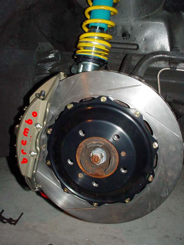

Front caliper..

Installed

Incidentally the brake kit we installed also lightened things up significantly over the stock brake system. It's not quite as light as the ceramics but it's farily close. I'm sure Kevin has the exact specs on that.
