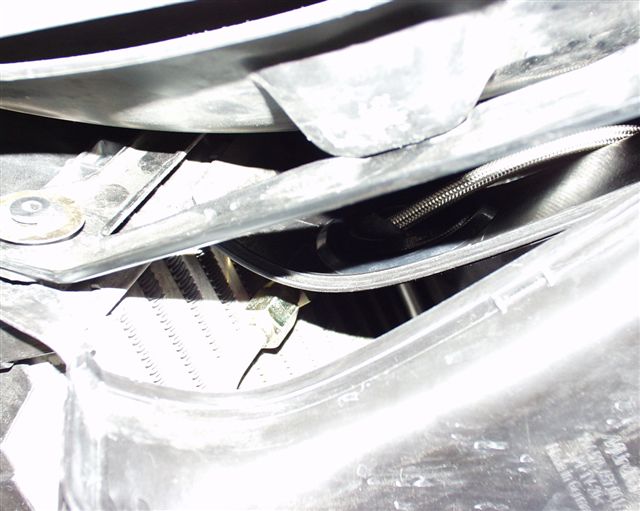

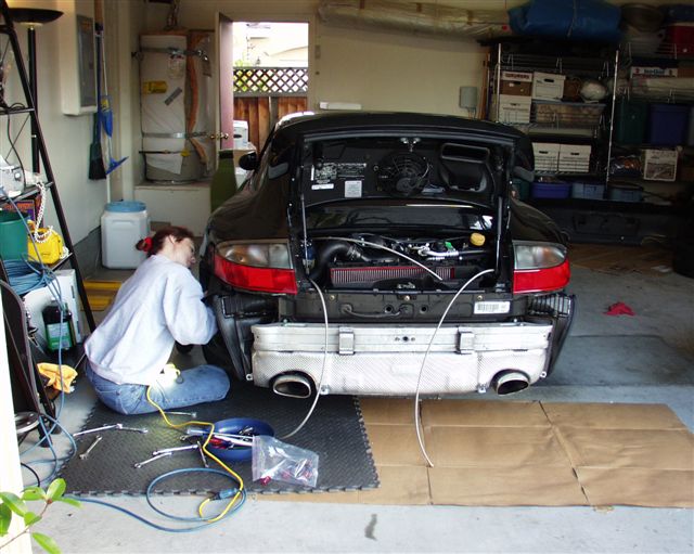

Cooling/NOS
OK so there's been a few misconceptions about the car and NOS. Just to clear it up, there's no way we'd ever use NOS in the "domestic-way". Stephen/Kevin just don't believe it belongs on a 996TT and I'm too scared to even try it

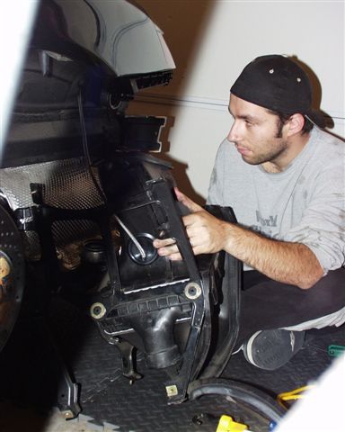

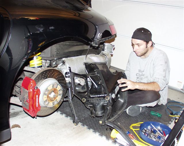

Originally we did decide to install some extra cooling capabilities for the RMICs (rear mounted inter coolers). David in Virginia tipped us off on to a company called www.speednosis.com that sells a C02 kit which they went ahead and modified to suit the 996TT design, based upon David's specs in terms of lines etc..

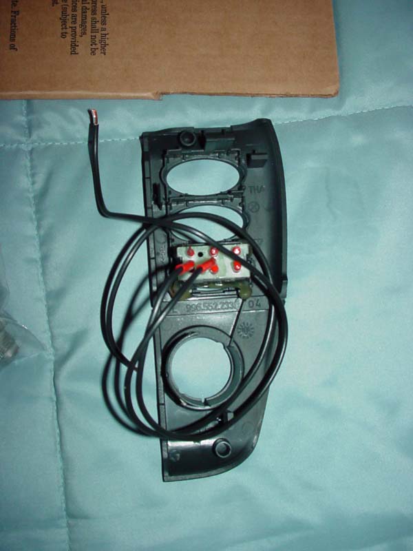

The install was pretty easy, Joan and I pulled off the bumper and then plucked away at the IC assembly either side. Popped open the boxes and slotted in a spray bar either side. Now it's important to remember that you're working with airflow here so don't go the easy route and install them on the wrong side. Basically you want them to work with the airflow and not against so all your CO2 gets wasted. You should place them on the intake side (so you can't see them when you look at the slats) and not on the underside where the air as blowing out. The spray bars fit really well but we did use a couple of zip ties here and there. From each sway bar we ran a stainless steel braided line and cut a slit through the rubber bung on the corner of each IC assembly and then ran that through a grommet in the rear and to our dual-solenoid. From there on in Kevin/Stephen wired up the electronics and included a Greddy boost sensor to actuate the solenoid upon a certain amount of boost. We went for .5bar. The pictures Stephen showed you are his design and make the console/switches look stock so you'd never know.
The system was designed to use C02 as the cooling agent but as Kevin pointed out, Nitrous obviously a lower temp cooling agent so we went for that instead. He mounted the bottle in the rear passent seat (or the area) with a custom made bracket. It fits a 10 or 20 pound bottle just fine.
We don't know the actual benefits but being able tp purge manually before taking off and then spraying down the ICs whilst going 5 laps of button willow we barely went through a single 10 pound bottle and obviously kept the ICs much cooler, which does translate into more power.
Pix to follow.
Hope that clears things up? So no "nitrous" in a sense and the system is designed to work with either C02 or N20.

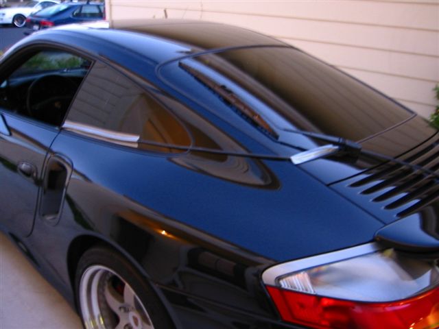

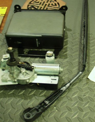

Here's the wiper plugged up in the rear. Looks better too.
The motor and rest of it came to like 15 pounds.

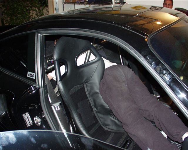

Here is Stephen getting his skinny-*** back into the car do wire up the NOS between a pair of GT3 seats and a roll bar. Nice one pal!

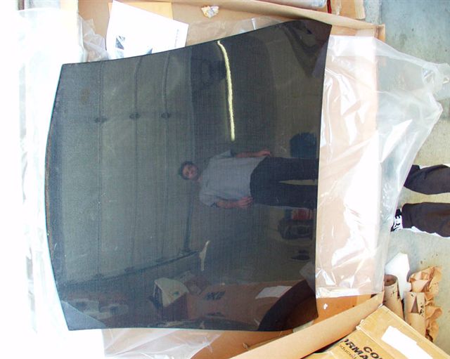

Here's CF hood number 3. Yes it savs you about 25 pounds but just be warned, the fitment can really be a PIA.

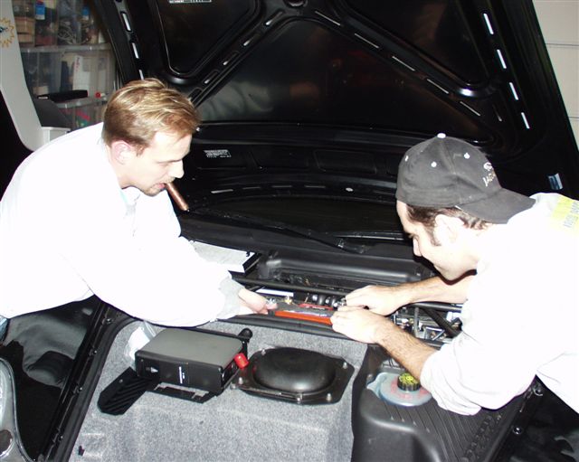

Here are pix of the NOS/C02 system going in. It fits pretty well and tight inside the IC shroud.
More...
And finally...
Also, I get my wife to install NOS since I have two left hands..

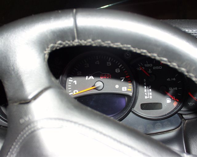

Less is More
One of the things that the boys really wanted to do was to smarten up the ghettoturbo and they did so with a less is more approach, which I thought turned out sweet.
Here's the IA Gauge cluster. It's cool how the red and white sides of the logo match up with the red and white rpms dial.

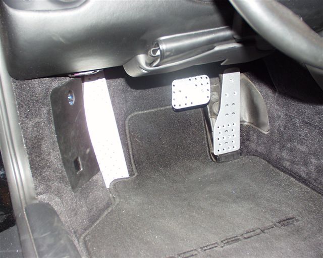

My rubber pedals were sagging like crazy (too much brake boosing...) so Stephen popped these guys in.

what do you mean by CF hood "number 3"??

15 pounds up high on the car ... bye bye rear wiper!
Old Dec 8, 2003 | 03:59 PM
  #59
sharkster's Avatar
Posts: 23,879
Rep Power: 1517
Hey man, seriously, I weighed the motor and the wiper itself. I actually believe it was 13 not 15? Sorry. I have to check my notes. Either way I was pleased with the results
