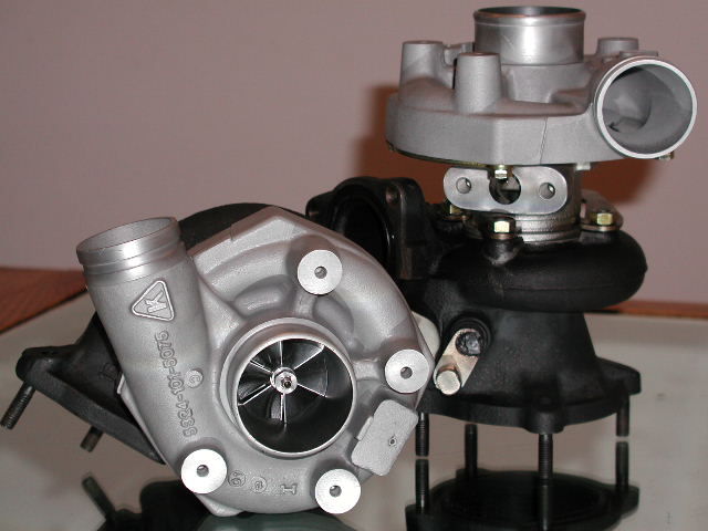

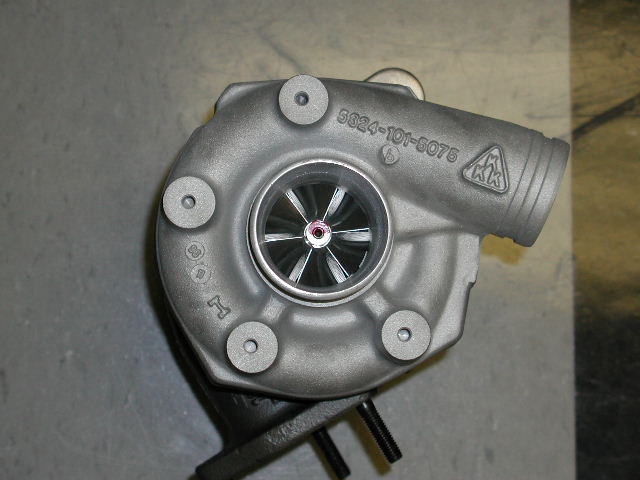

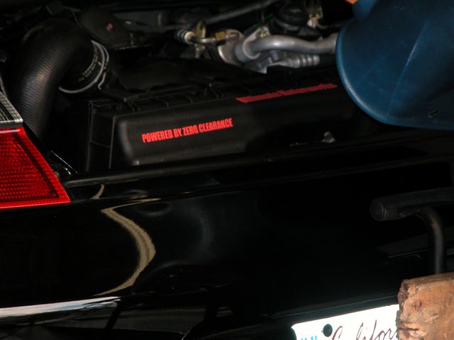

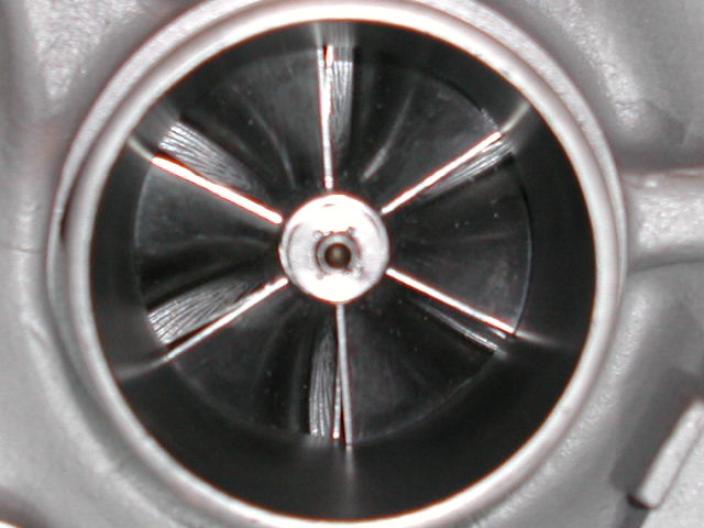

Originally Kevin had set me up with a set of his K16/Hybrid Billet wheel turbos, with his own backplate design and iconell larger waste gates (which I shouldn't have shimmed shut but that's another story). The wheel was clipped and the housing ceramically coated. These turbos would easily push 1.2/1/3bar
But after a second visit and some revisions made.

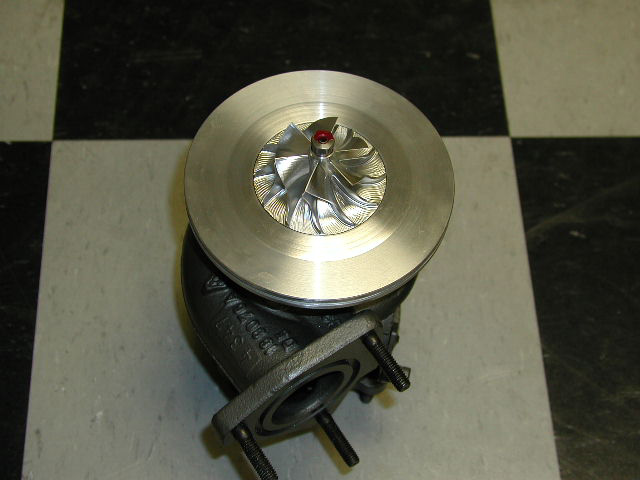

Kevin went back and reingineered them with his Zero Clearance process to improve airflow and up the efficiency from 74% to 95%. At the same boost level, thus you're flowing a larger volume of air- a good thing we can all agree.
This is what zero clearance looks like. Try getting a hair through that gap

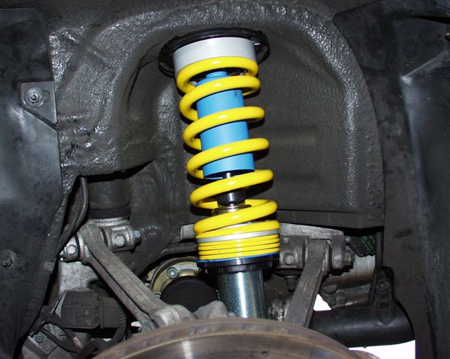

Originally I started out with some H&R sways. Yes it stiffened the car up but that mod alone really fudged up the stock shocks and by 20k the guys had slapped some of these in:
Everyone's favorite PSS9s were mated to GT3 sway bars (lighter than the H&Rs incidentally which clanked like hell). Several different attempts were made with drop links and we're going to settle on a final set of Bob Brook's in-house MASSIVELY strong drop links. Maybe he can show you a pic since I don't have one handy but in comparison to the ones seen in most kits, I have to say they look so much more beefy and why not over-engineer something as important as that anyway? Fancy going around a high speed turn with your drop link failing? No thanks.
We plopped in an EVO strut brace at the front for good measure. Stiff she is/was but since it's a street car we shied away from camber plates. The negative camber was set for 2.2 in the rear and 1.8 in the front, which is all we could do without using camber plates.

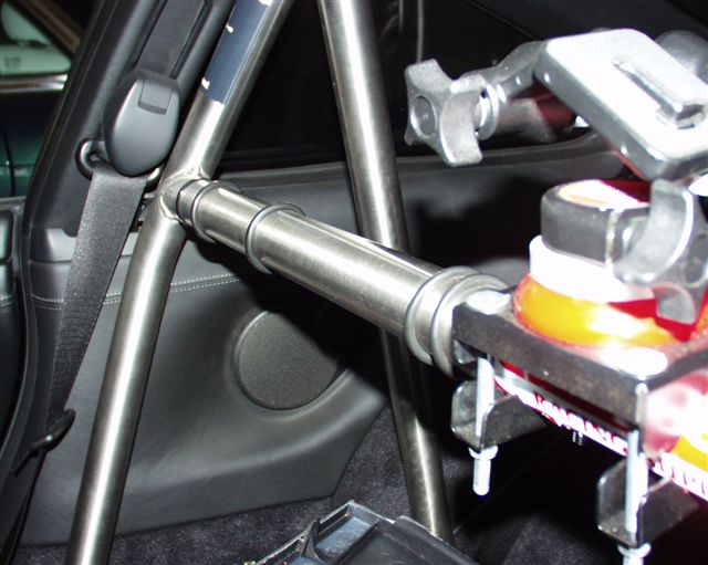

A Porsche Tequipment roll bar was put in, which also increased rigidity somewhat. Plus all the kids these days love it...

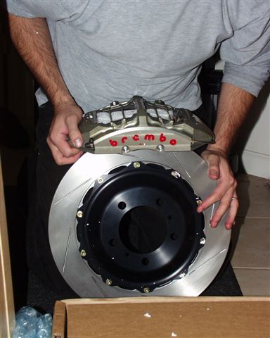

There's a lot of confusion over different 6/8 piston Brembo kits out there. It's late and I'm a little confused still myself, so Kevin/Stephen should probably step in... To my knowledge there are only two of these kits in the US right now. One is on Alex's car and the other is on Alex's car (Scargo one). These are the eight piston, titanium inserts, eight pads, 15 inch slotted rotors with stainless steel braided lines kit. Cheap they most certainly aint but stop they most certainly do.
The Gran Tourismo kit looks like this:
Obviously bleeding the system dry is needed when swapping out the big reds and the pedal is so so stiff nowadays. We used some ATE Super Blue but obviously some prefer Motul etc...

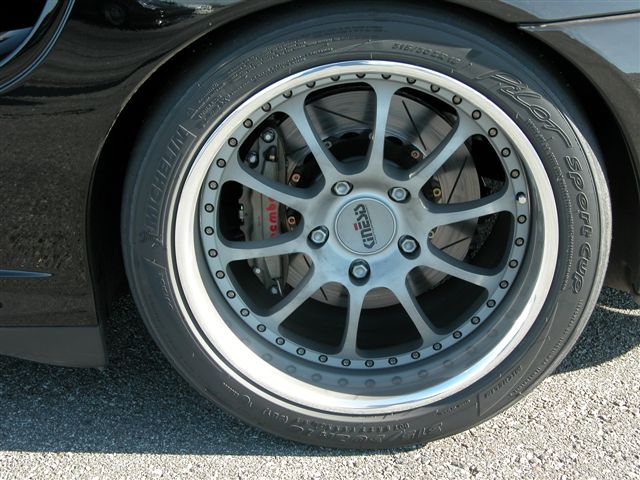

Having bigger brakes is great and all but not if you don't want to upgrade to 19 inch wheels. 19 inch wheels may look great (and they do) but the tire choice is limited and the sidewall to small for real racing and hence there are no race tires available. We wanted to make sure we stuck with 18s and the guys had Kinesis and Brembo match the specs of these new brakes and wheels. The end result was custom offset K18r's only a few days later.
Here are the front 15 inch 8 piston boys
The rears are 14inch 4 piston calipers
As you can see from the pictures we've got some fatties on there. The fronts are 265/35s and the rears 315/30s. Fender rolling was required and some heat gun fenderwell massaging. It's only plastic...
Stephen breaking them in (pun intended) was a lot of fun. I was in the passenger seat and clambering all over the place

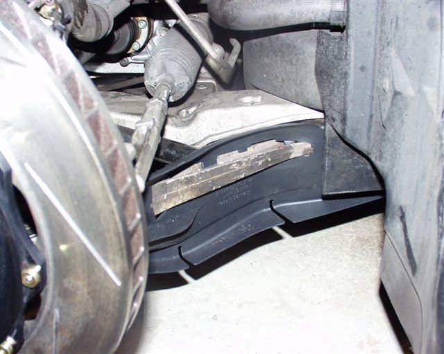

One final thing, I copied CJV's GT3 brake duct idea which you can see here. These are a good improvement over the stock ducts- not even sure they're worthy of that name.
They look great and probably work really well for most brakes, except we're unsure on our kit due to the way slotted rotors cool from the inside out and whether or not we're actually creating a hot spot. Either way the guys recommended I remove them.
