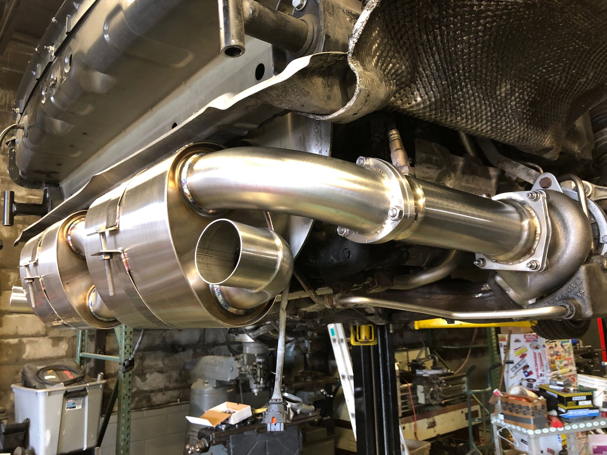

I switched cars on the lift today. I put the turbos on with new check valves. Installed new coils and plugs. Started to get ready to drop the trans for the clutch swap and run the new fuel line. Also need to fab up the inlet piping.
Turbos
Step aside...
Turbosmart 24lbs wg’s

I did the injectors also leaving the stock 3.8 bar fpr
Drivers side out
Drivers side in
Passengers side out
Passengers side in
Wg’s
Wg’s
Exhaust will be here Monday so I am hoping to have the car buttoned up by next weekend and off for some paint work!!
